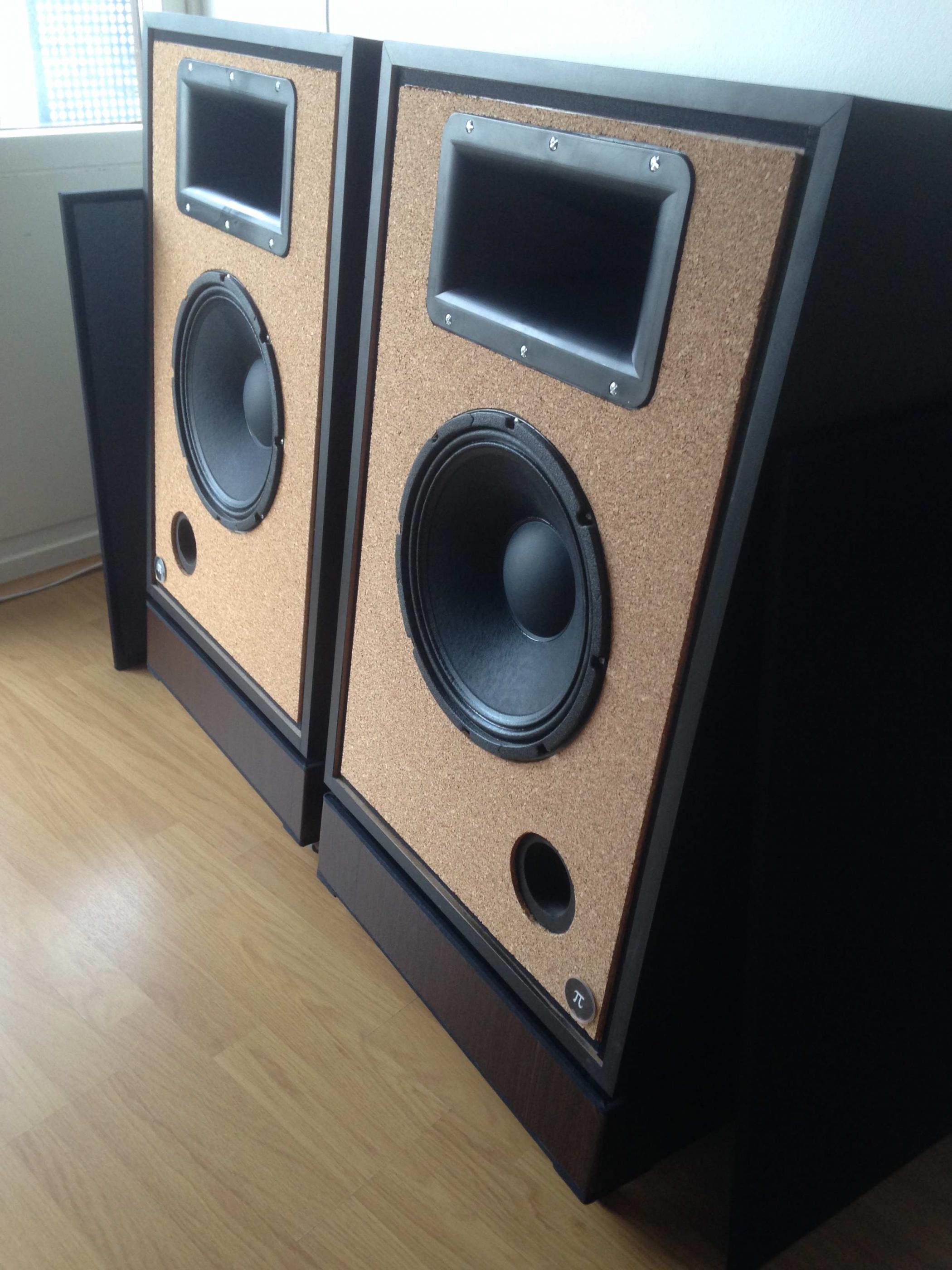

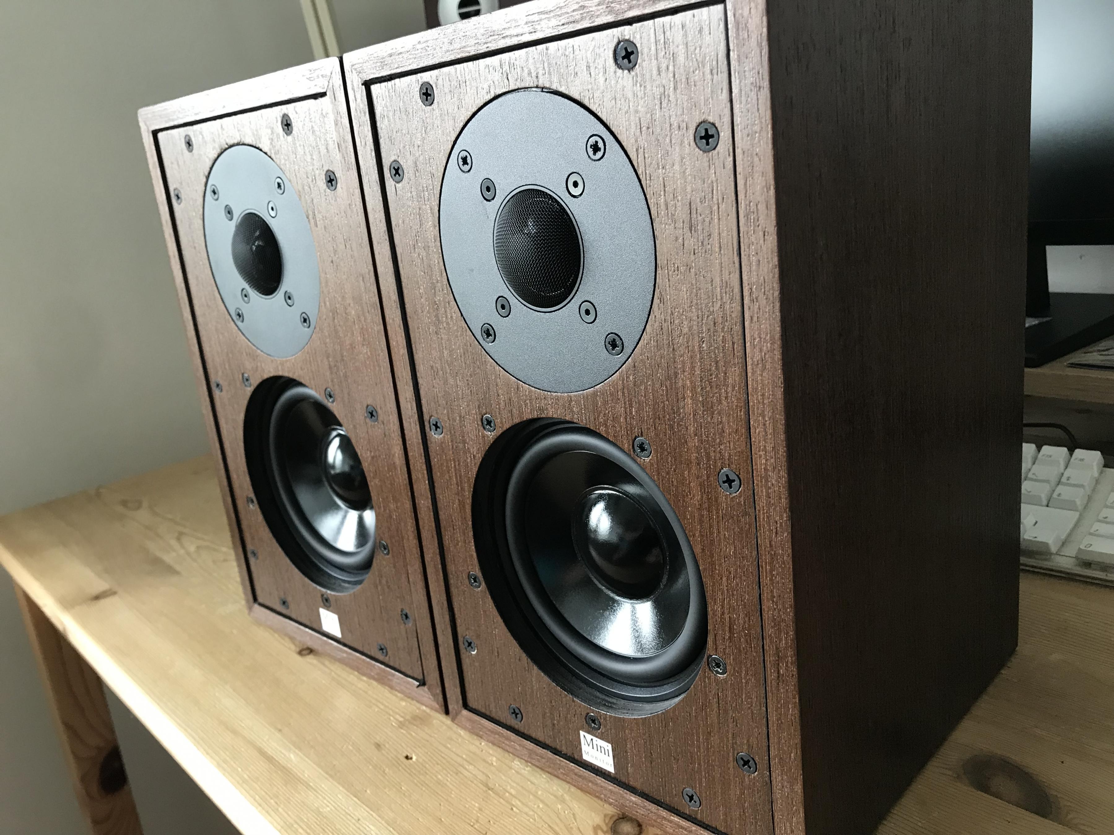

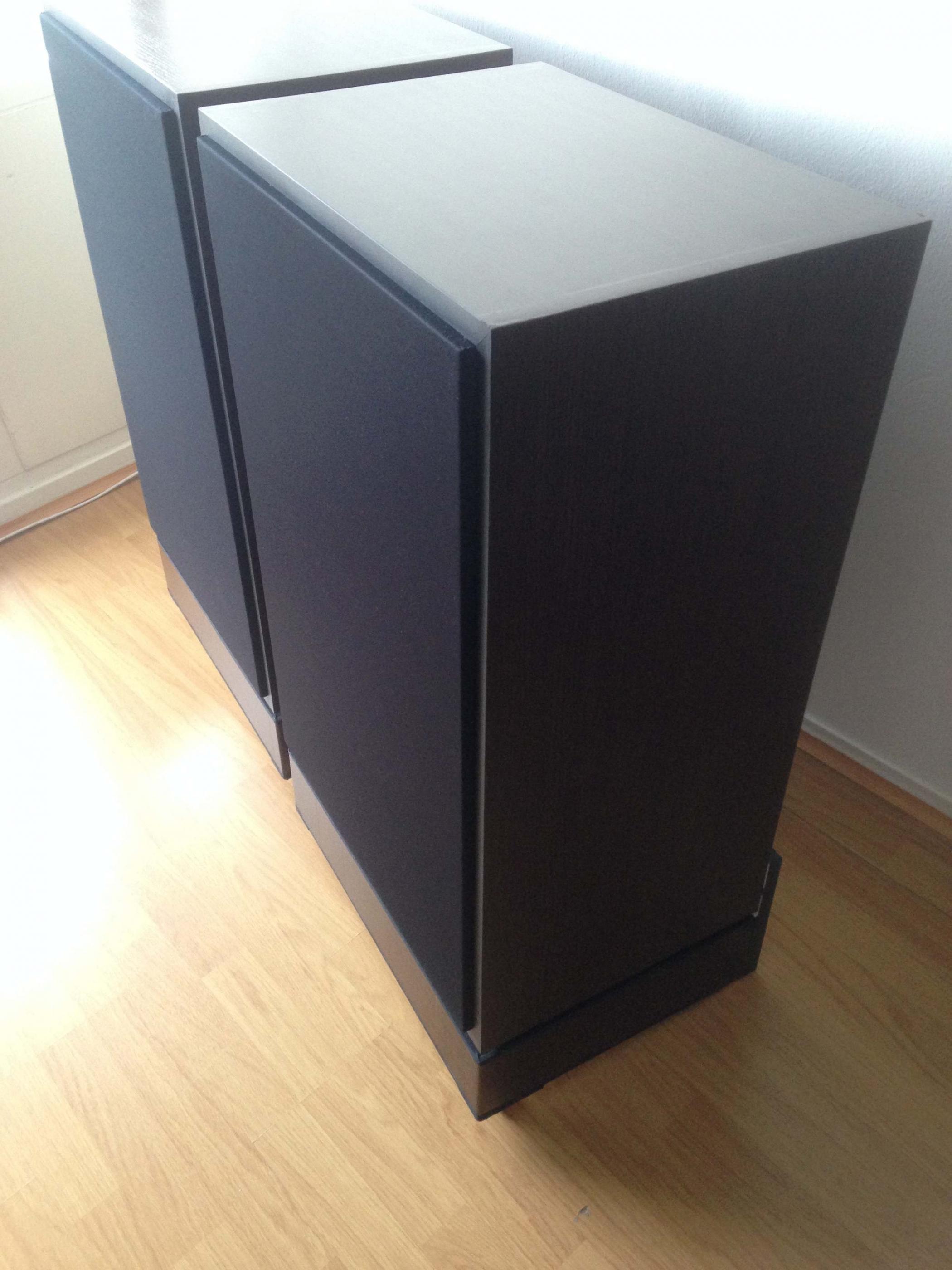

Regarding your enclosures - they look great, neat and purposeful - I have done same in the past. Only issue is - they could be easily scratched or damaged but it does not take long to add another layer again!

I did find some higher quality vinyl wrap at Home Depot; it looks similar to yours. As I said, the contact paper brand I have tried in the past just isn't all that good. What I found is durable enough to cover a kitchen table with so the quality and strength should do nicely. From the photos; your boxes do look very much like real exotic wood for sure.
My last vinyl wrap was years ago with Pi3 speakers I made - they where 2-way 12inch woofer with horn - great sounding monsters - ZERO WAF - so they had to go after short time... but because of sheer size&cost went with vinyl wrap and they were good enough looking as long term solution.
For the Mini monitors I used generic Veneer of industrial quality - nothing special - I just wanted to be dust/water resistant to withstand the years of use.
There is of course difference in appearance but this is why it took 2 months, just to veneer entire enclosure with all the sides... :-(
