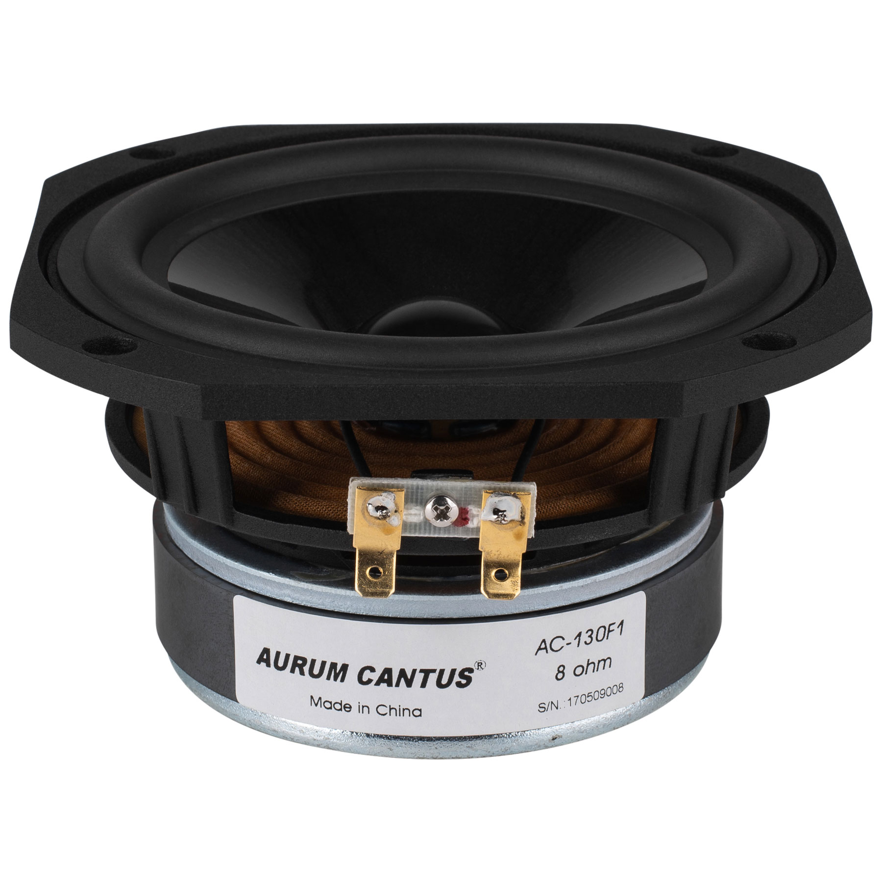

Still very pleased with my Monacors but came across another decent looking and spec wise driver. Doesn't seem to be as available in the UK but if your that side certainly a nice one to consider.
Aurum Cantus AC130F-1
Aurum Cantus AC-130F1 5-1/4" Woofer
Look under the brand Harwood. That is the same as Aurum Cantus. I don't know why but Aurum Cantus uses the brand name Harwood in Europe at least. That driver does have very good reviews and is used in some famous designer systems or kits (the name escapes me at the moment).
