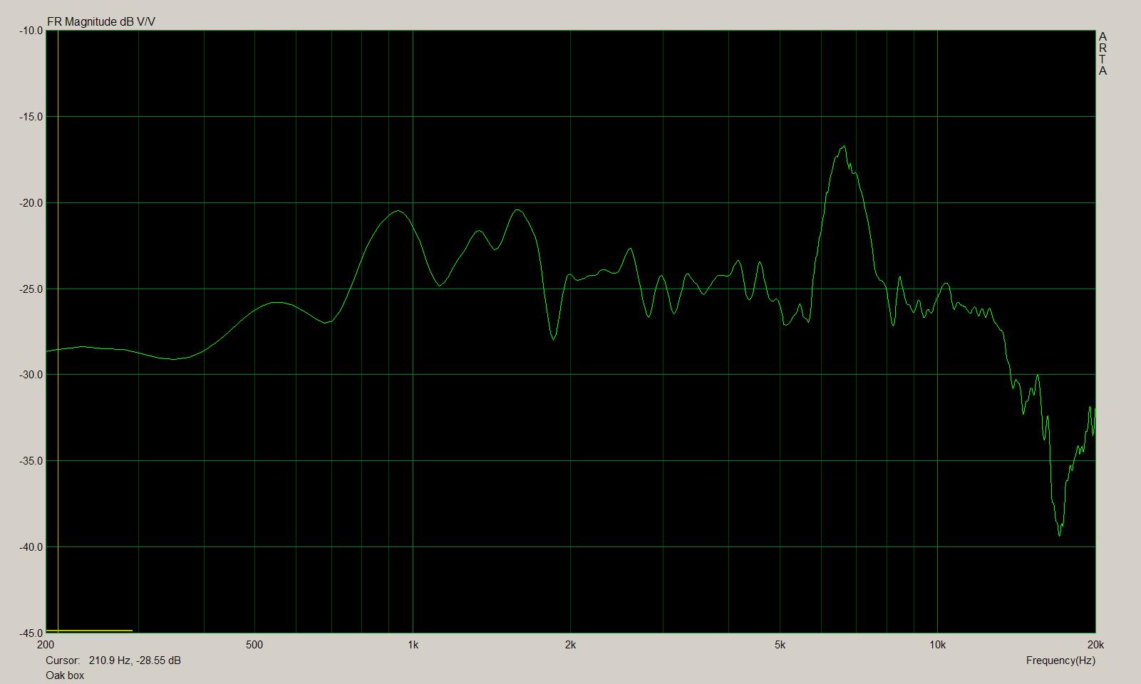

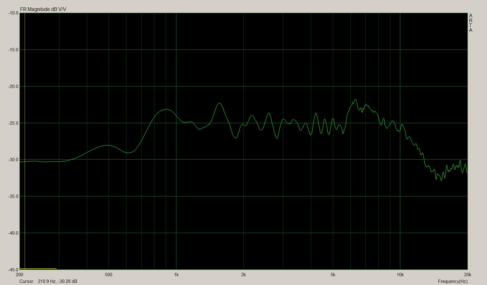

What it takes to tame this puppy. Yea, it sounds a lot smoother too.
This is a 1M, 3.5ms gate, so ignore all LF.
Yikes, that's some peak in the original response - nearly 10dB ? No wonder it was hard on the ears... 😱

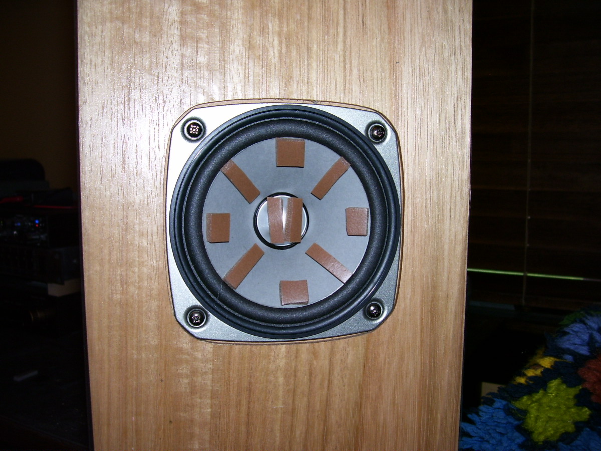

Good results for a first try but one suggestion I'd make is to turn the long strips (on the cone itself) 90 degrees, and if necessary shorten them slightly to fit. I didn't find orientating them the way you show worked very well, placing them parallel to the outside perimeter worked better for me. When they're parallel to the perimeter adjusting the distance from the centre/edge controls what frequency they damp - closer to the perimeter is lower in frequency, closer to the middle is higher.
This way you can target a peak specifically, provided its within a certain frequency range. Too far one way or the other and you'll just put a dip in the response next to the peak. (Think of it like tuning the centre frequency of a notch filter...) I'd leave the square ones where they are for the moment and make sure the other strips on each opposite side are symmetrically placed so the centre of mass stays aligned...so if you move one closer to the centre move its 180 degree opposite to the same radius.
This was a quick and dirty test that is removable. This weather strip has very poor adhesion. As to not load the forum with too many pictures, the denser black foam I have did a better job on the dustcap resonances. With no scales, I can't compare black to tan for mass. I tried the black ( thinner but denser) in two rings around the outside and it was no where near as good. This was the best of about 20 configurations.
So, I have basically confirmed the problem and the approach. Next is suitable materials. I need to go get a pile of 50 cent paper drivers to test various things I could use, from windshield seal, PVA, dip-it, laytex paint,rubber cement, ( dusted with microspheres) Zig-2, all kinds of things I can think of. I want to have at least a little clue before I damage the Fostex. I would have no doubts on Planet-10's drivers or buying then unheard. Who knows, I might even buy a pair myself. That dust cap is evil, even with the crease in it.
Without BSC, it is still out of balance, just not as harsh. I'm going to beat this thing into submission, which should help out Doug with all those pretty boxes he is building.

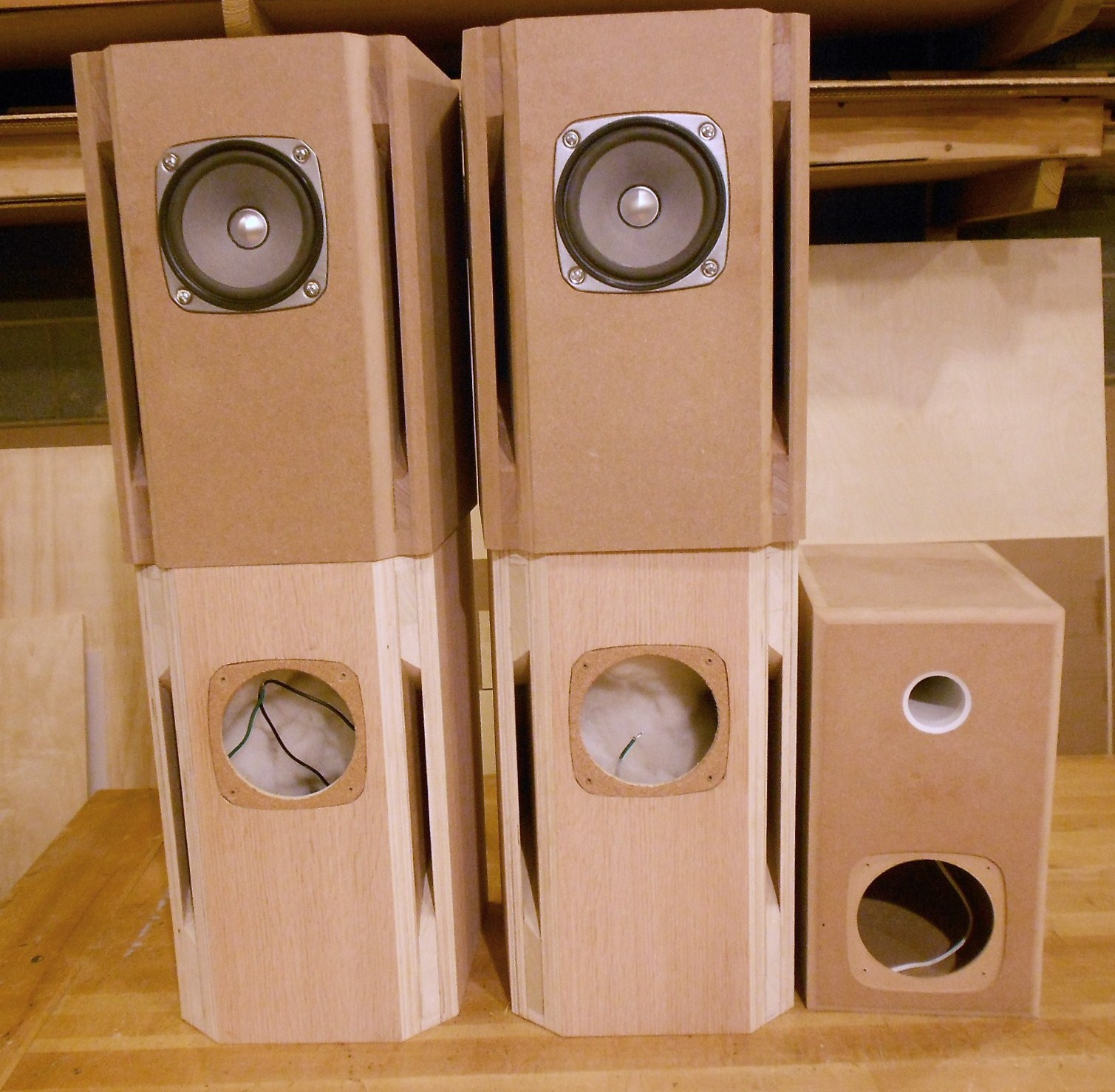

Nice surprise
It worked 😀 I was stating to wonder if this was going to be a waste of time.
However, the bass is much richer, more defined. I think the angle helps the bass "bubble" better. Maybe I just like angled MDF cabinets, but they are sounding nice.
Waring! The bass on these speakers was always an issue; now I can't believe this is the same woofer. E.G. I put the Fostex box in pic, they really do much of anything....bla
I think I've made it over the bass hurdle, now some help with the breakup?

The foam is great for damping that dust cap resonance, but you'll discover a need to have the foam very thin at the very center for about 1/4" (of thin) if not using a helper tweeter; meanwhile, the filters outlined above can adjust your solid state amplifier to happily drive your full range speaker without shouting/peakish issues.
As far as the foam on the speaker driver's cone, you may desire omit some that after you've installed the filters because too much foam is like a blanket--relaxing indeed but not penultimately clear. So, I suggest to use the filters to cut power to the problem prior to considering covering it. But you did a great job on discovering where to apply the foam to damp cone resonances and that can be re-deployed for fine tuning after working with the filters.

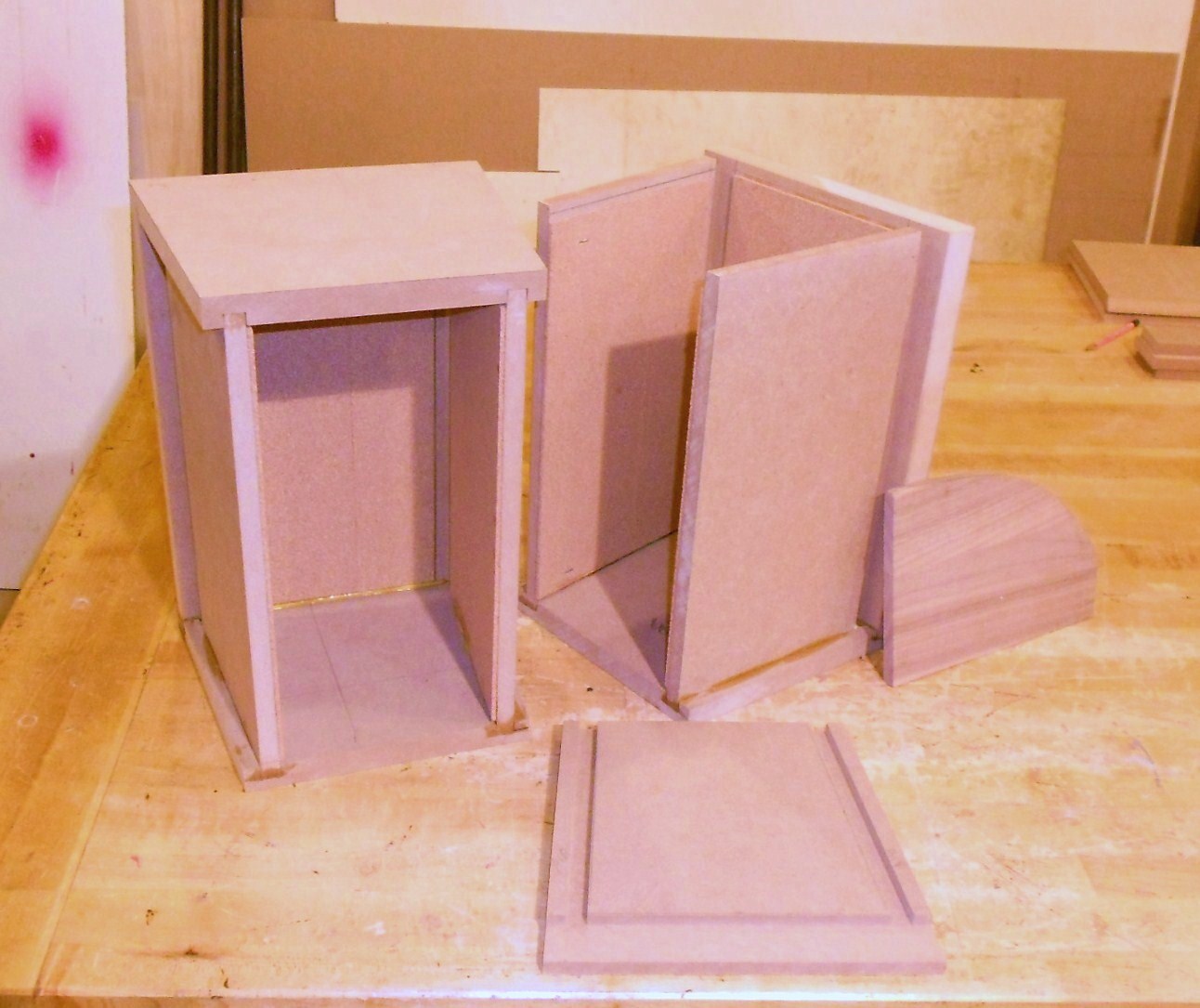

Construction

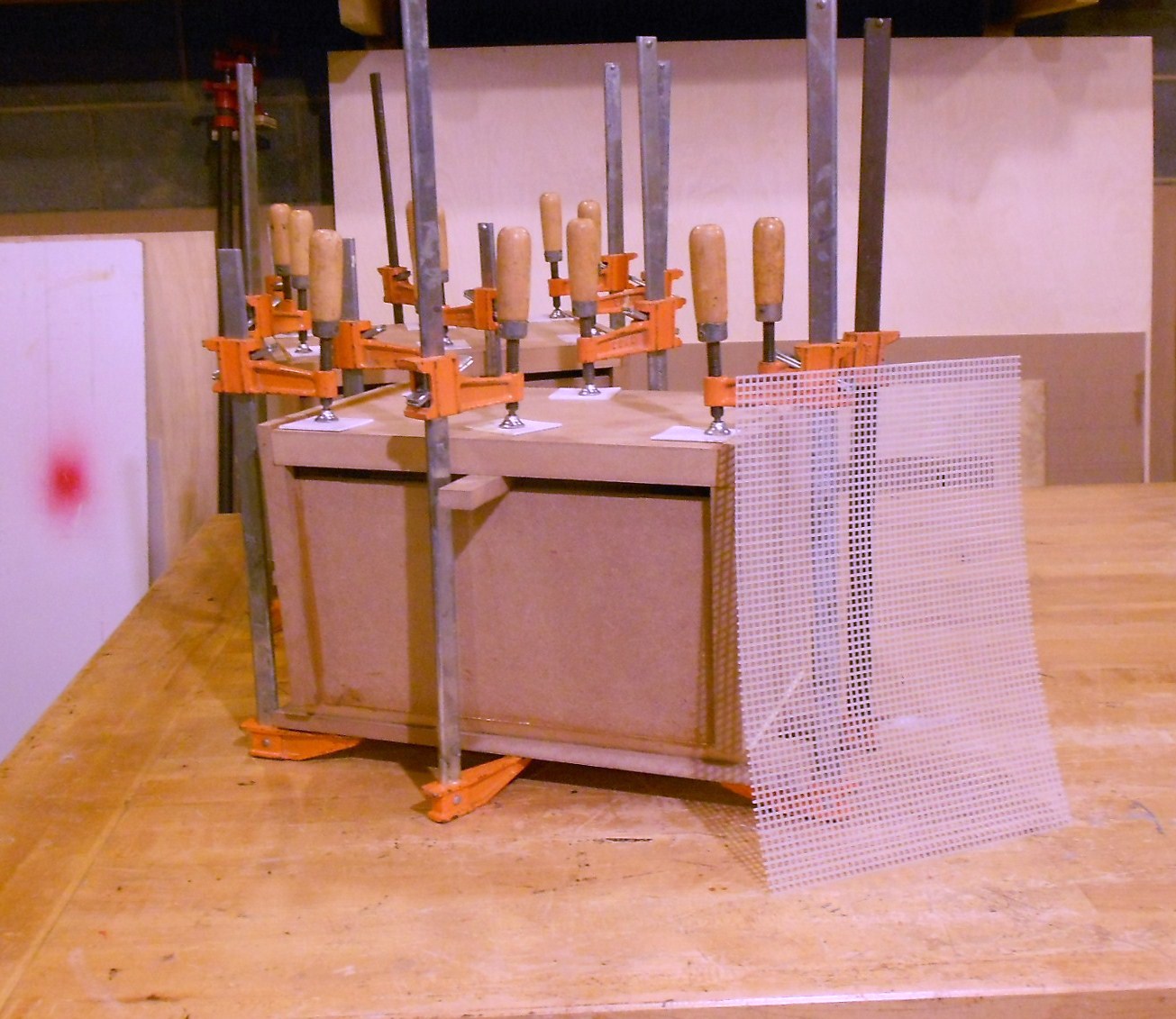

Just a an idea or two..........
Let's just say we only had one sheet of 1/2 mdf to work with.
> Could cut double pieces for back = the 1"
> Could cut smaller keystones for tops and bottoms, won't need groves (pic)
> Could cut horn shape vent strips (might not be as strong as wood)
[Odougbo will use oak or better next time]
