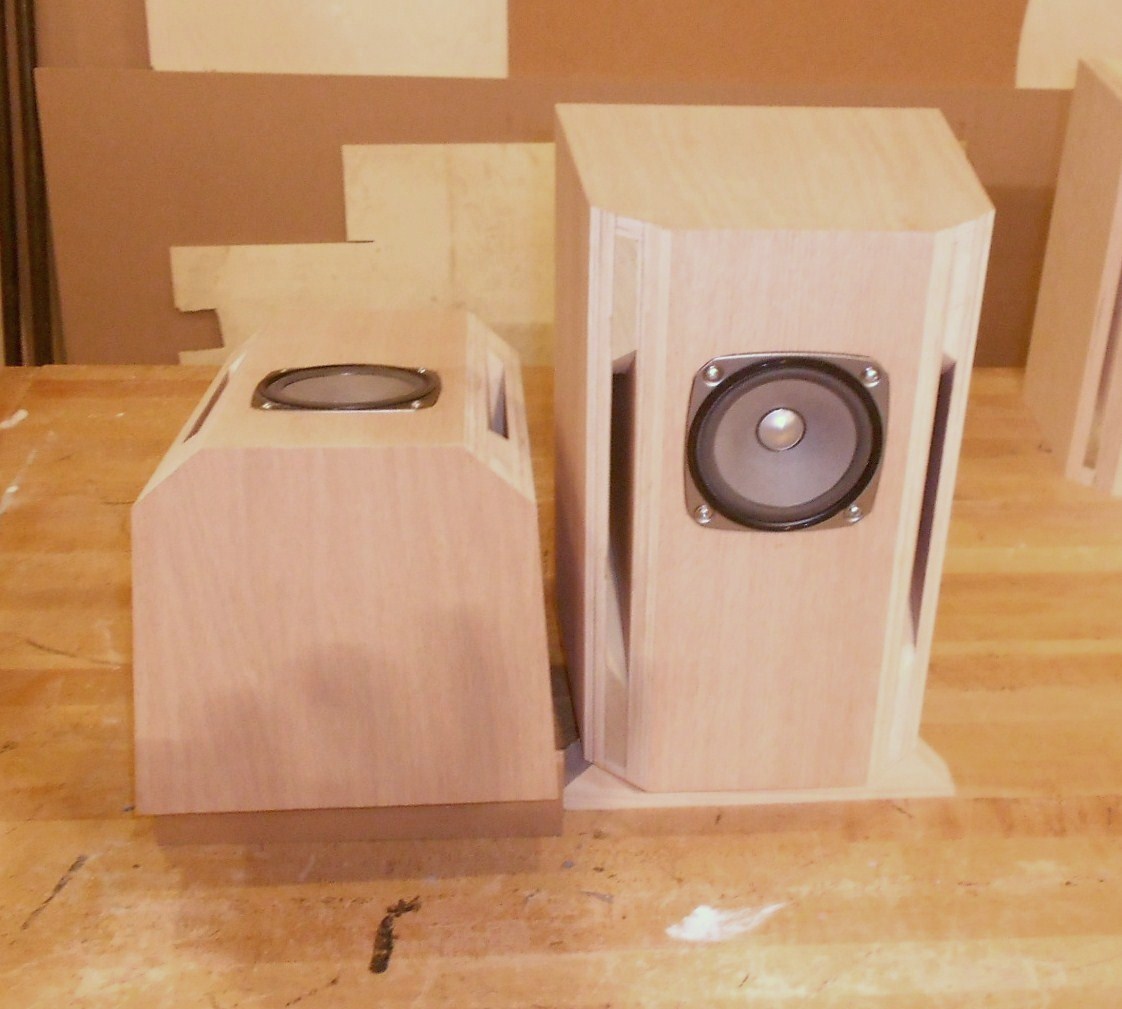

This is how I build them - pics.
Speakers in Pic 1 are starting to grow on me; really hard to say how well they are working with measurements - the sound stage is unbelievable (great depth).

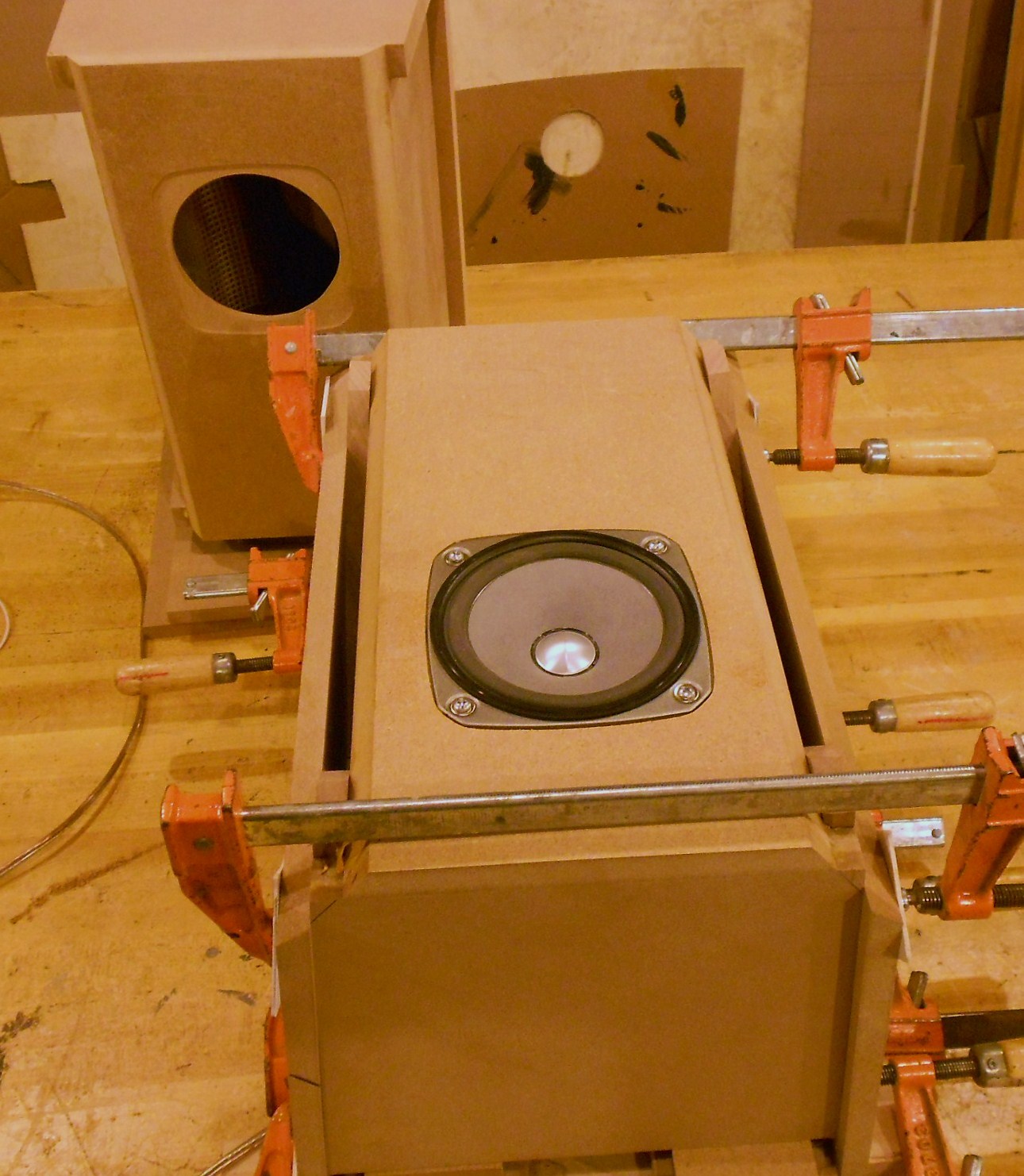

Pic 2, continuing with MDF pair: 1" shorter, same volume (more angle going back).

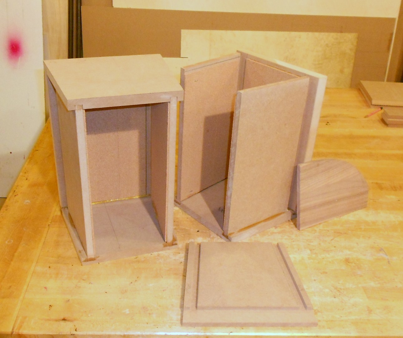

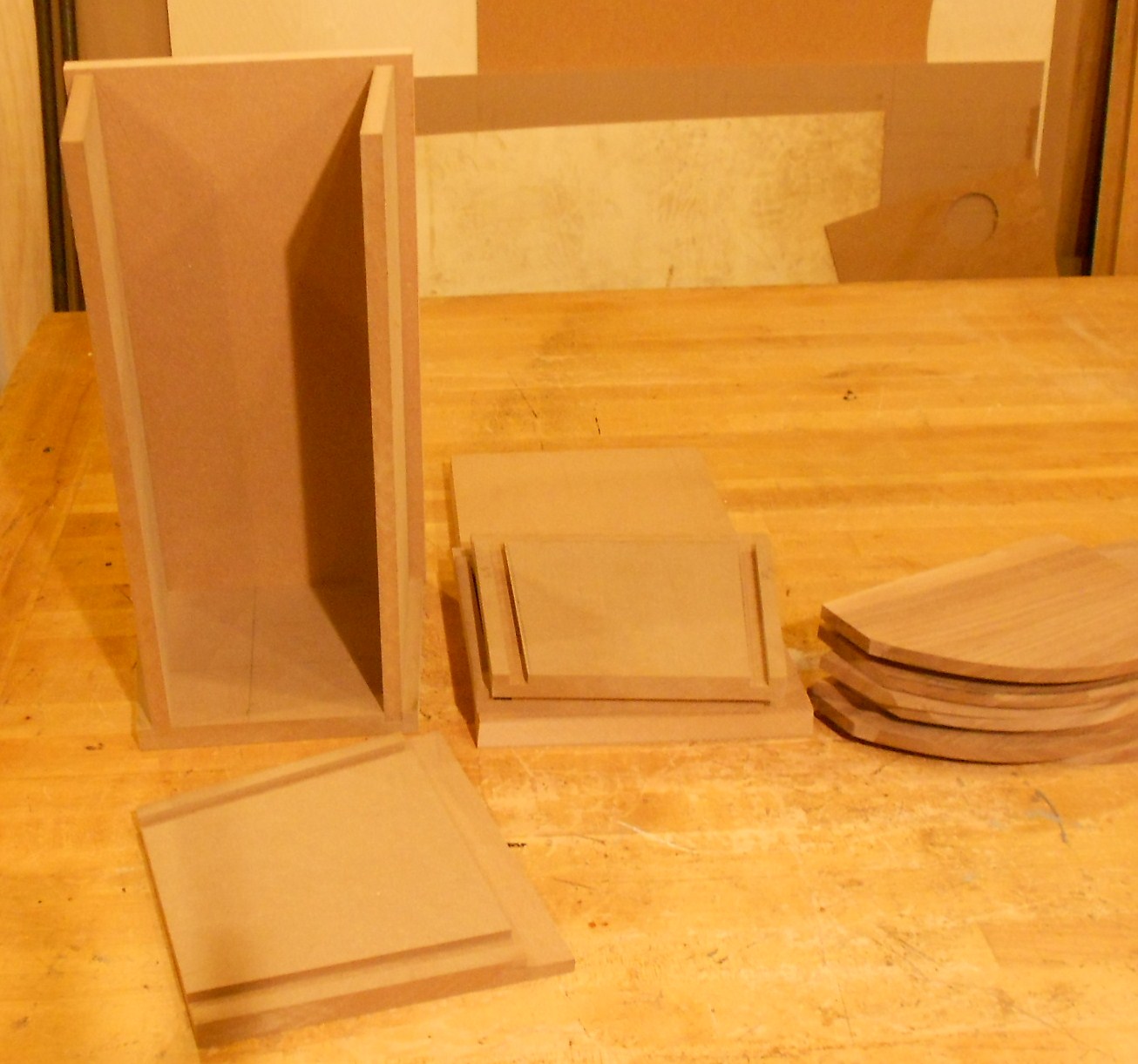

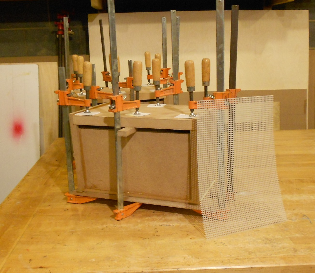

Still going..... glueing the fronts on. No center brace (I know some are thinking foul).
Found light plastic grid at craft store, $1.59 - used that to keep damping material out of the vents.
Lined the mdf with cork - something else a wise man recommended.
Nice use of cheap materials!
How thick does the cork need to be? That thin, adhesive backed stuff will work? Or must be like 1/4" thick, or more?
I'm using 1/8 - 1/4 inch? don't know, 1st time I've used it. I like it so far.
This box seems like it needs less damping material - which was the idea.

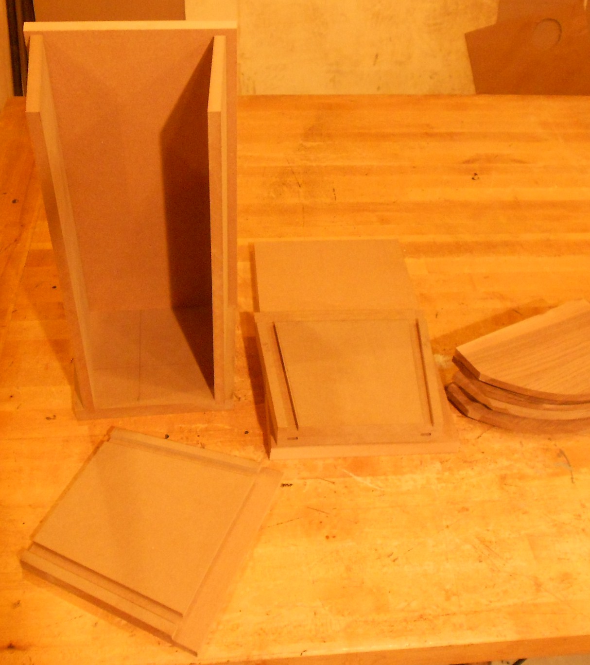

SO far so good, had to check tuning before gluing on sides.
