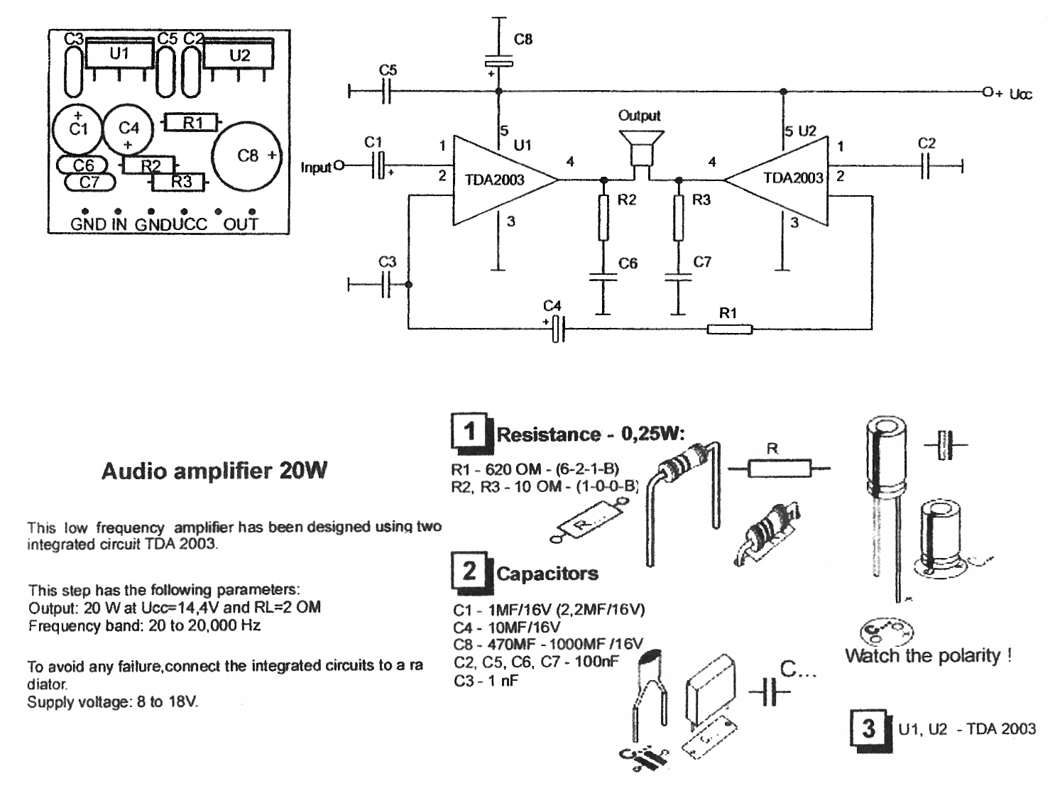

A little bit of loss can also be provided by a bridge amp <--schematic You can use a 3a or better schottky series to the V+ of each board for greater stereo separation if you like. Yes, that amp looks too cheap to be worth anything, but it does show off how a bridge (single rail "bridge against") amplifier can promote a large size soundfield even if used monophonic, and that is worth something. There's a lack of expensive parts, a lack of efficiency a lack of price and a total lack of posh appearance. But if you wanted something tubey, clear and big sounding, that it can do. If one wanted something more complex looking, perhaps an NTP discrete amp would be fun?
