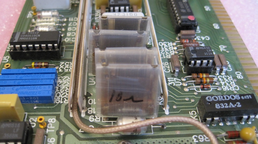

The ones I have all have the ESI wirewound SR-1 style resistors, 7 of them I think. Much closer tolerance and tighter TC. Still the .02% seems pretty optimistic.
Here are the 4x 50 ppm resistor standards on my 2150. I initially thought they were foils but upon closer inspection, they are actually wirewound. Duhh. In fairness, the last time I looked at them, I did not use any magnifying glass 🙂

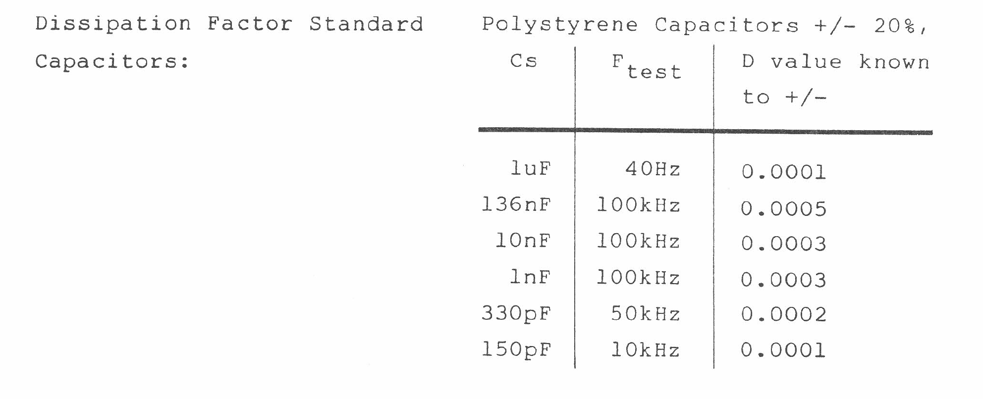

I'm not sure how to verify the calibration anyway except with some resistors at lower frequencies. When I have it seems to be on cal. The tough part of the cal is a very low d cap at the target values in the cal process. How can you be sure of .001%D on a cap?

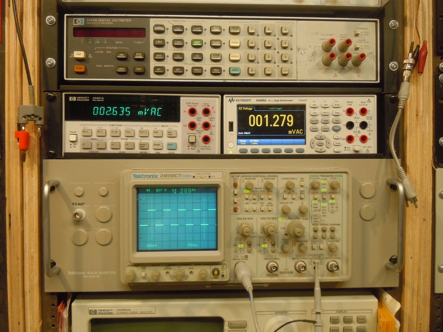

I just got my Tektronix 2465B back today thanks to Kay (kct) who did a wonderful job of replacing capacitors and saving the NVRAM to a new chip. He also left that information on a USB stick that I taped to the top of the unit. I believe there was also some electrolyte to clean up. Leaking capacitors.
So here it is!
-Chris 🙂

Hi Suzy,
Thanks!!
I'm just really happy to have it back and functioning. The rack mount was a gift from kct (Kay) who repaired it for me.
I didn't know that all the portable Tek scopes could share hardware like handles and such. Another thing to keep in mind.
I'm keeping the previous scope as a backup, a Philips PM3365. It has an excellent trace, but when you are running this scope, you are not doing FM alignments. That's a trait it shares with the PM3070 (which I bought new 27 years ago). I have rebuilt the PM3070 and its still going, so a pretty good scope.
I still have an HP 1722A and a Tek 465 to rebuild for my collection. The HP is a 275 MHz, dual trace built in the early 1970's! That's pretty amazing! I would hate to see how much it cost back then. It was running briefly and was a really nice scope to use. Other capacitors (I think) are cutting that party short.
