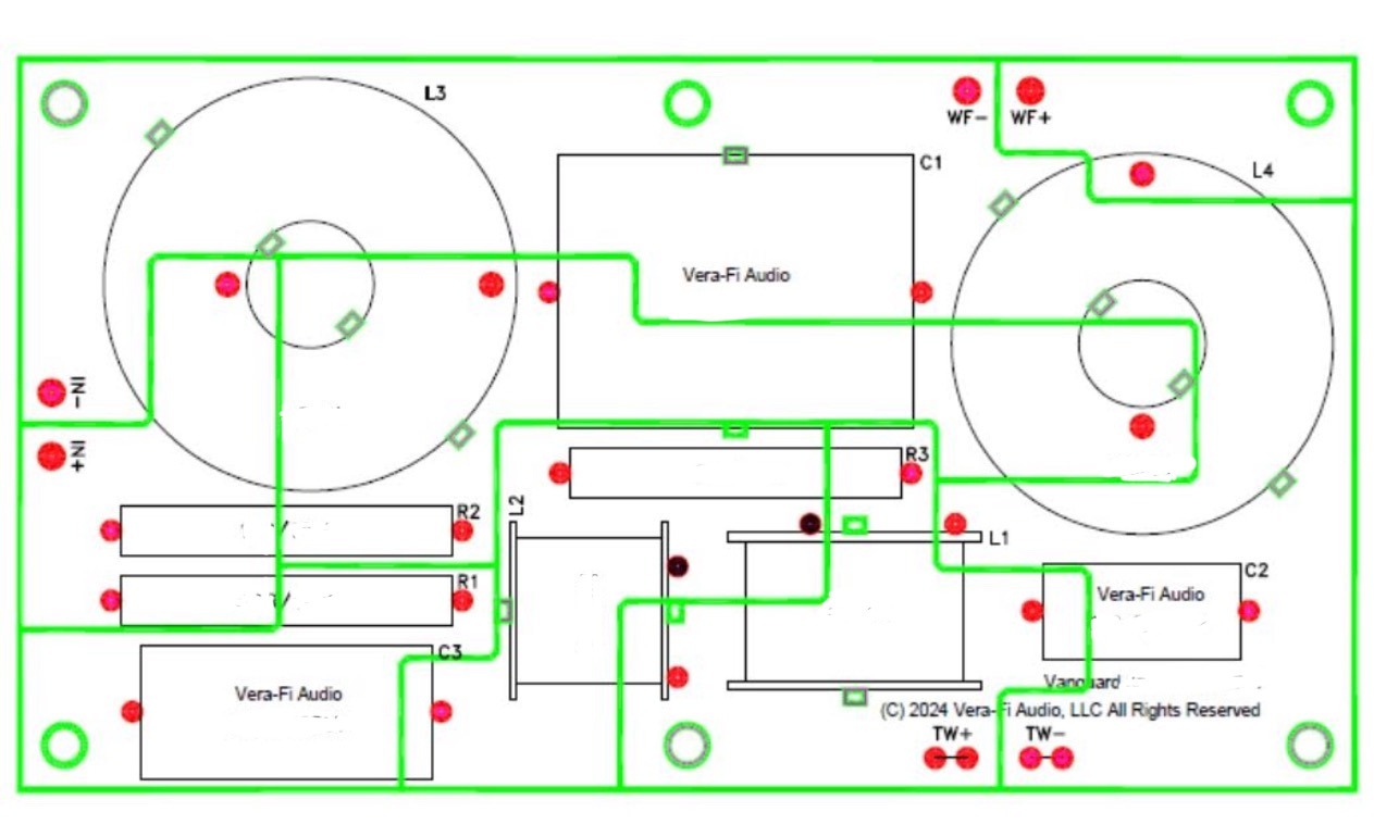

Layout for crossover PCB for Vanguard Archer is completed. I’m going all air core on this special speaker. 16ga copper on woofer and 20ga copper on tweeter. All custom made/wound components. It’s a big heavy crossover at 210mm x 115mm PCB size with a ton of copper.

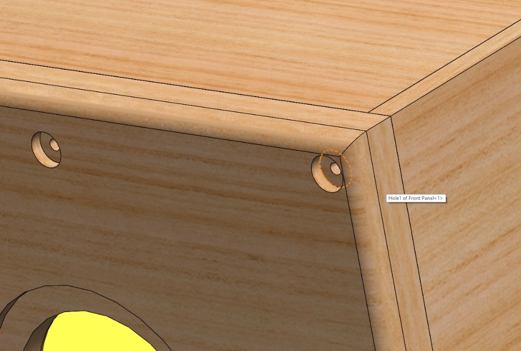

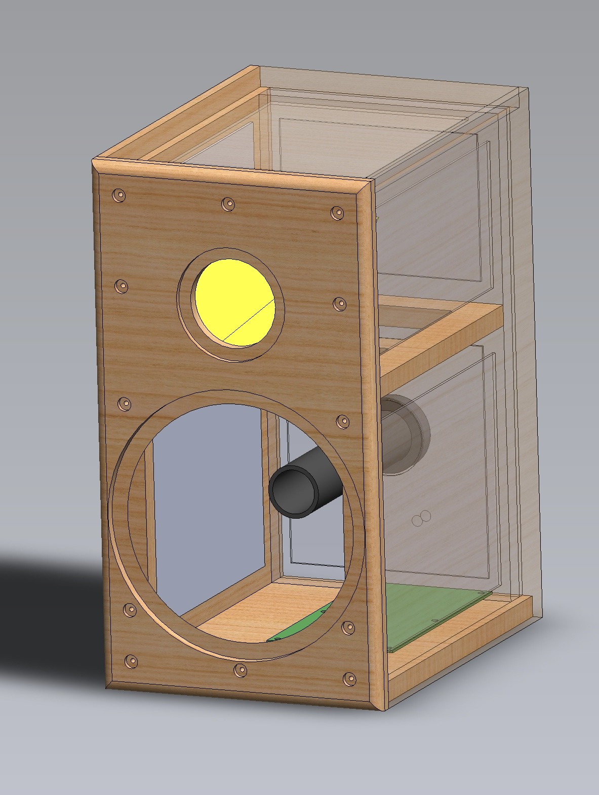

Making progress on the CAD plans for the Archer cabinet. Baffle screw holes need to move closer to edges. Vent tube dia is actually larger.

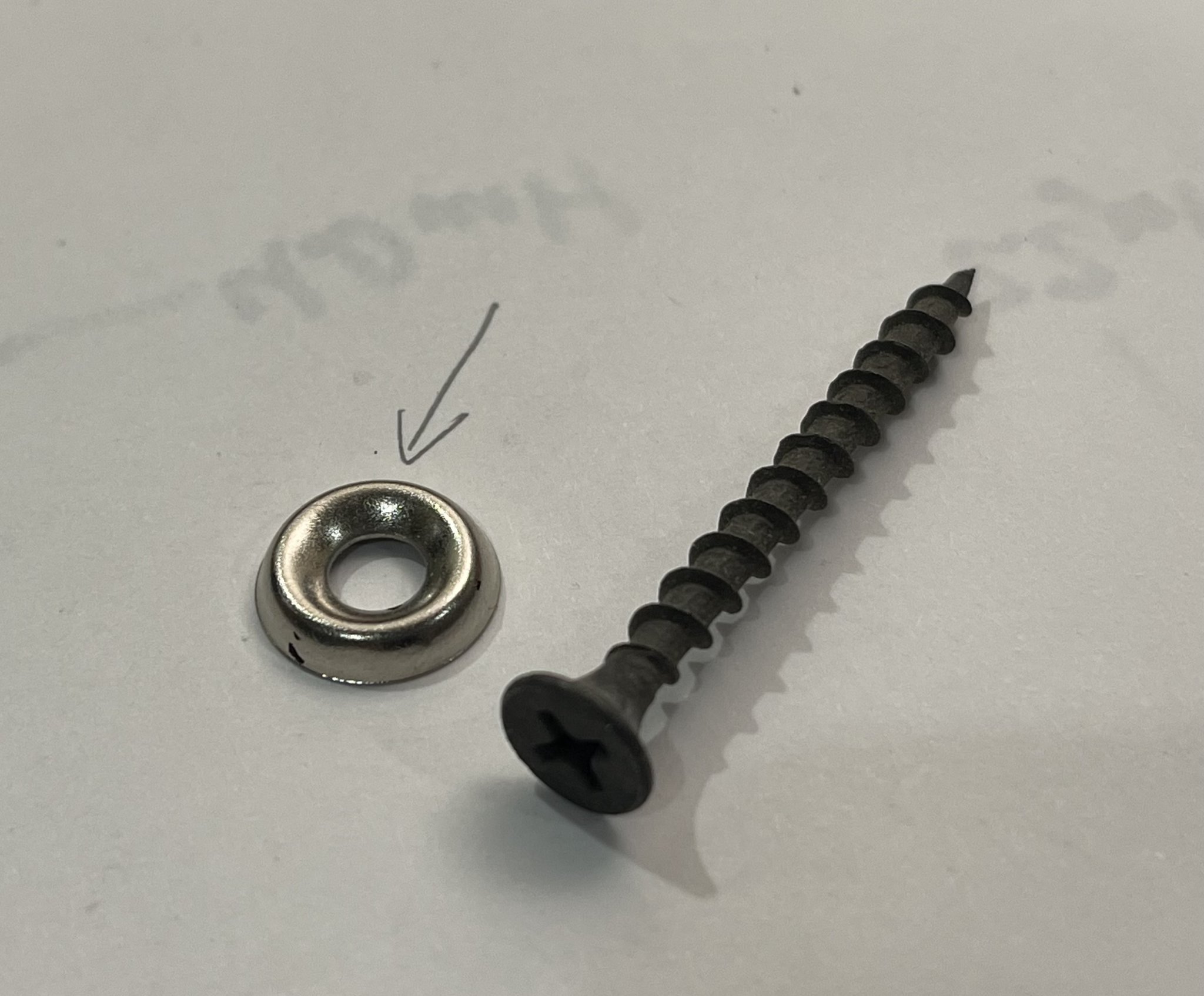

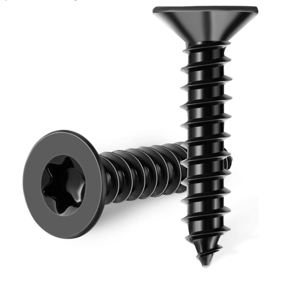

Baffle will be held in place with black Torx screws.
In Nickel played steel cup finishing washers.
It’s tricky to get the screws to go in the correct place with a roundover on the baffle and ledgers on the inside. Possibly a window frame cutout rather than 4 square sticks glued in place.

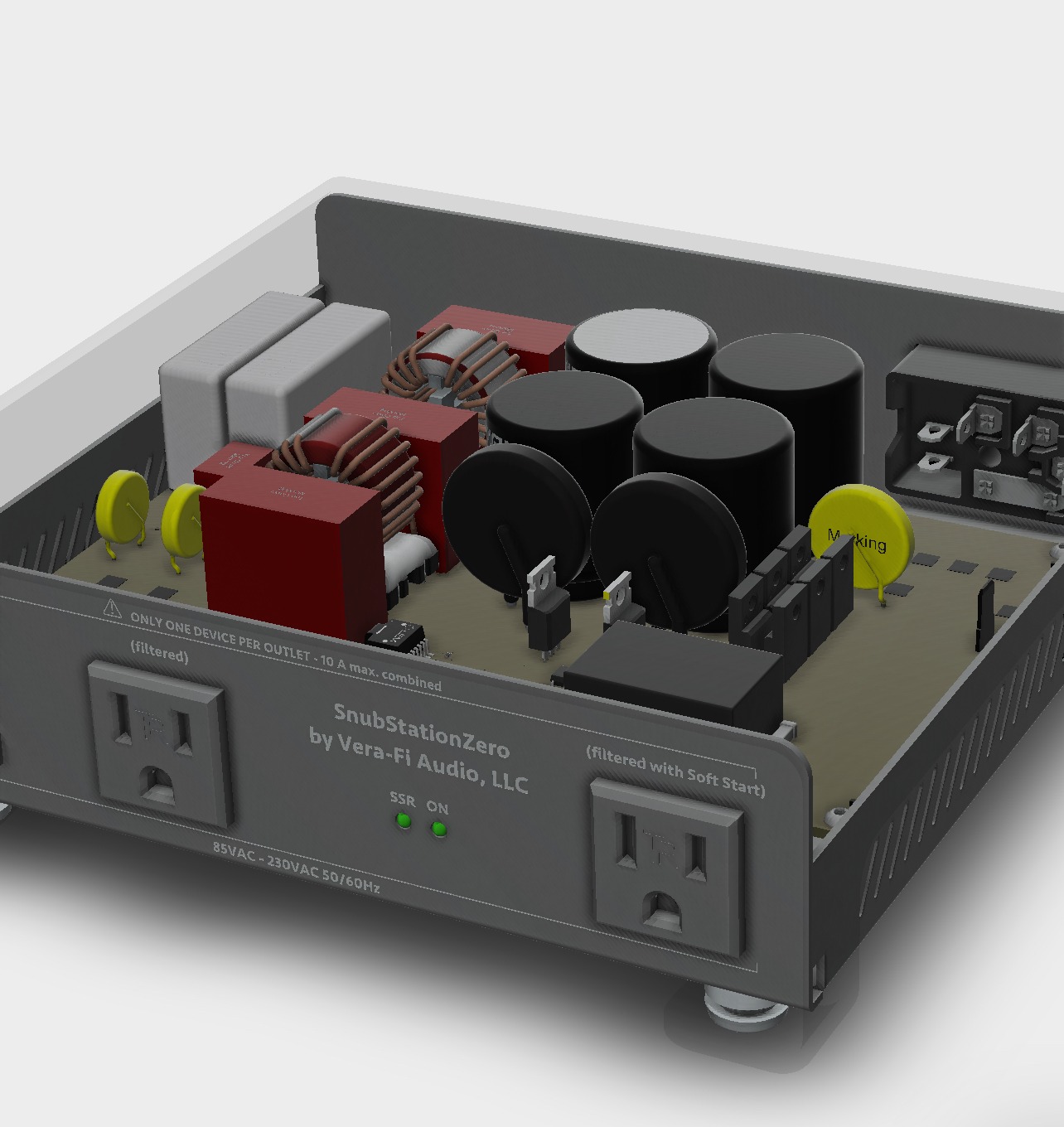

On the bench for about 6 months now is the SnubStationZero product. A multi-function power conditioner that employs a DC blocker, CLC filter/noise snubber, and a solid state relay (SSR) soft start that gives any audio product a soft start capability through use of advanced Hall effect current sensor and logic circuitry to effect the SSR to switch the NTC current limiters on and off to provide the soft start feature. Basic operation has been tested and verified on test board, chassis design is almost complete.
10A max and there are two auxiliary outputs that have DC blocker and filter but no soft start for lower current devices.
