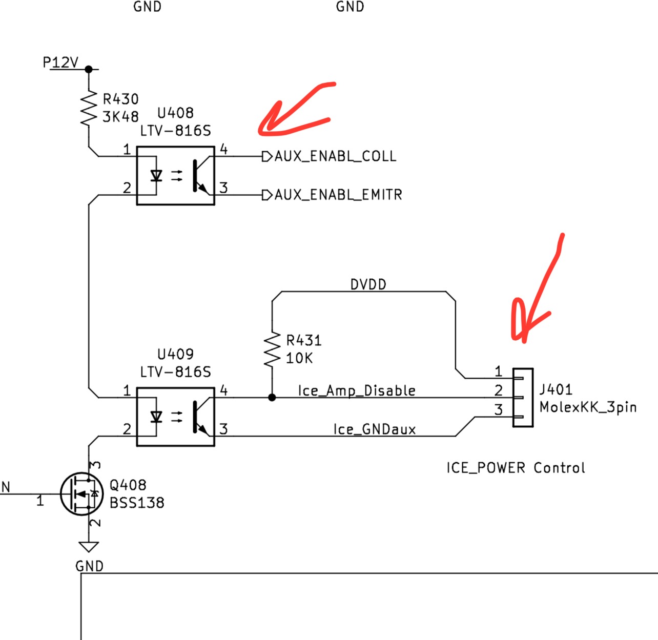

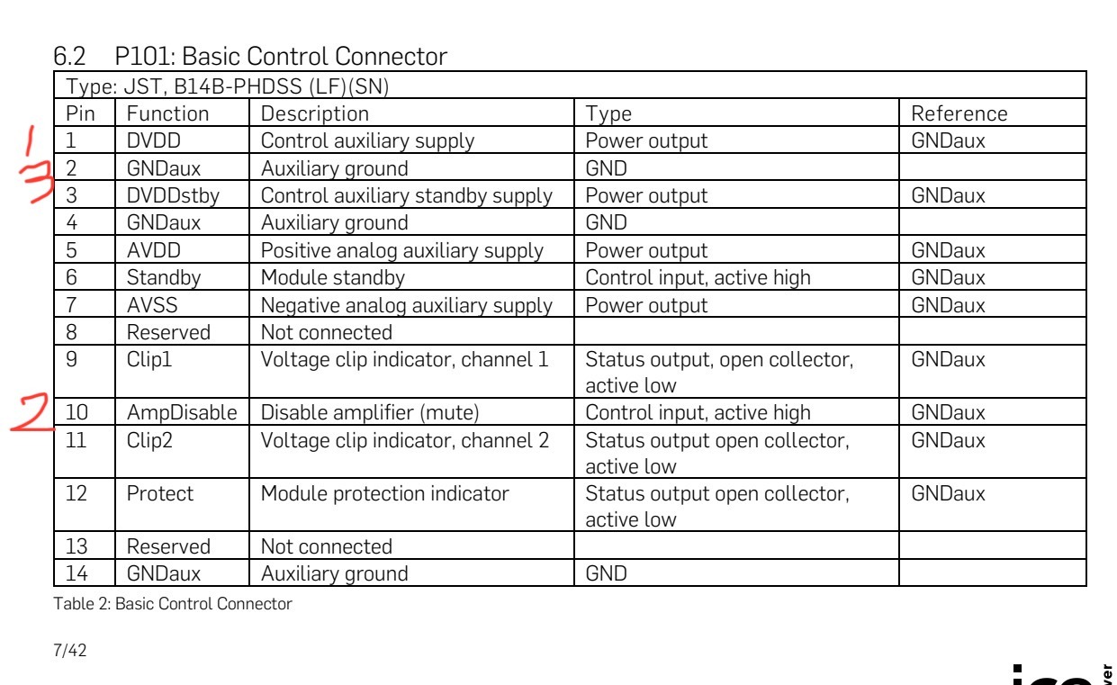

Hi X,
can the HyperSET turn on logic control two 1200AS modules too? Because I have the two monos as you know.

I think that the logic on the IcePower 1200AS uses inverted pull down logic gate. That is, when in standby, Dvdd (5v) provided by 1200AS on pin 1 of J401 is applied to pin 2 via the 10k pull-up resistor R431. When enable logic is applied to Q408, that conducts and lights up the LED inside the optoisolator U409 and this shunts current thereby dropping the voltage of the pull-up resistor at pin 2. This enables the 1200AS amp. I believe this can be paralled to both amps - although I am not sure if it would be happy of DVDD from one amp was connected to DVDD of another amp. I think only use pin 1 on one amp. So parallel pins 2 and 3 from HyperSET to both amps. But connect pin 1 to only 1 amp.
Give this a try and if it doesn’t work, you can use the auxiliary optoisolator U408 to replicate the same circuit block (add 10k resistor and third pin connection to amp’s Dvdd.
Hope that helps. I assume you know which pins on the 1200AS need to be connected to the three pins on J401.
Hi X,
many thanks for the recommendation.
I thought I would use pin 10 on P101 of the 1200AS, which disables the amp when pulled high and enables it at low. In this case there is no DVDD mismatch, both modules would see the logics high or low state. If the HyperSET logic is at high after hard turn on (so 1200AS is disabled) and switches to low (AS1200 enabled) after the few seconds when HyperSET is ready, than it's fine. Does it work this way?

Hope your surgery went well.
You have it right mostly. It is open collector logic which means that you need to provide the reference voltage that needs to be pulled down when enabled. That’s provided by 1200AS P101 pin 1. Pin 10 is indeed the Enable and needs to be pulled low to enable. That means low relative to the AuxGND on pin 2 P101.
So I normally connect
P101 pin 1 to J401 pin 1
P101 pin 2 to J401 pin 3
P101 pin 10 to J401 pin 2
If you don’t connect P101 pin 1, you won’t have any source of voltage to “pull down” when the optoisolator is active.
It might work your way if we had used a logic gate with internal open collector topology - then it can pull down parallel circuits to internal ground.
Here the pull down is the external (on 1200As GND defined at pin 2 or pin 10 of P101).
Anyhow, you might try your way and see what happens. You would still need to connect P101 pin 2 to J401 pin 3 in addition, to have a place to GND pin 10 P101.

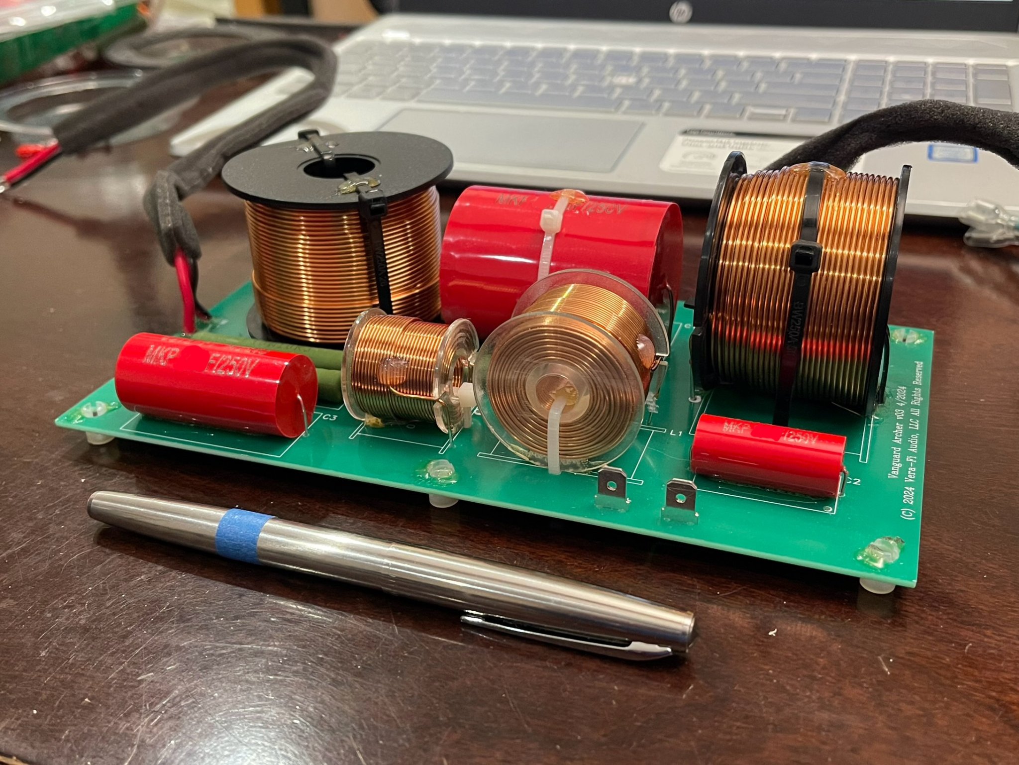

On the bench tonight are the production Vanguard Archer crossovers which just arrived. 3lbs 6oz of pure 16ga copper air core joy. This is really a special speaker. All components including film capacitors are custom made for Vera-Fi Audio. I don’t think have ever seen air core coils this big or this heavy. Wound on bobbins makes them really robust and accurate.
Time to install them inside the test cabinet and have a listen.

Many thanks X, now I understand your first post clearly - I will use pin 1 from one module for both enable inputs and hope it works. If not, I could use a turn on delay with about 15 seconds or so on the enable inputs.Hope your surgery went well.

Oh... you wrote a much better recommendation, I will use the auxiliary optoisolator.

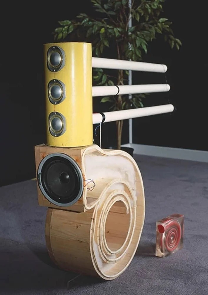

Here's a picture I find really comical of the prototype b&w nautilus, it looks SO BAD in this state of evolution compared to the final

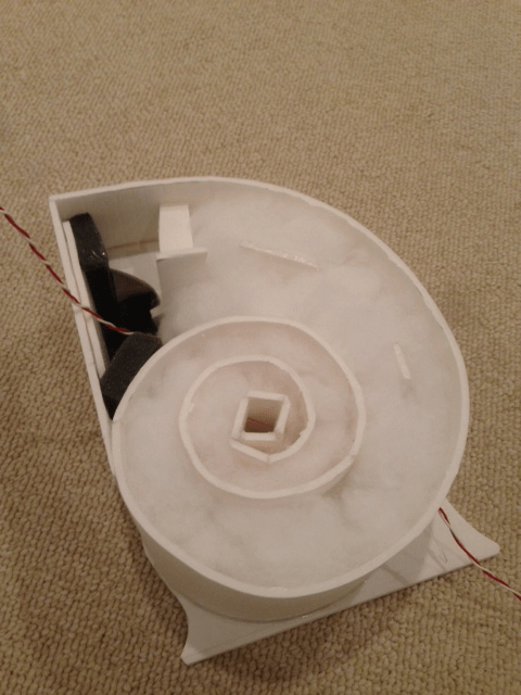

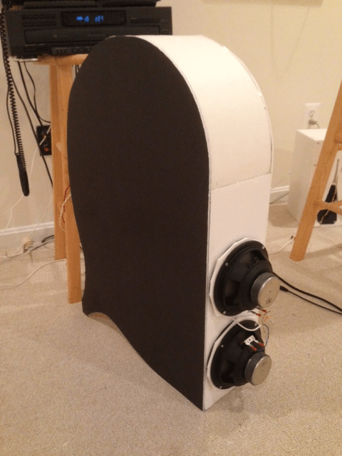

Hi Uncola,
You will find my variations of the Nautaloss speaker which was inspired by the Nautilus. I used coiled up foam core and it looks a lot like the prototype above. I have never seen the above prototype before but very cool to see that the designer also used crude mockups to test out the concept.
https://www.diyaudio.com/community/threads/the-nautaloss-ref-monitor.247598/
The idea is really like what is called a “Wood’s Horn” in optics where you want to trap light for experiments in the optics lab.
I tried various lengths etc but in the end found that a tapered and stuffed line whether short or long, works the same to absorb the rear wave. Hence, I eventually settle on the Dagger. A lot more compact and easy to make and yields the same result. I measured it and it has the same back wave absorption as if it were an open baffle (that is nothing in the back to reflect), but with the difference being it not a dipole and you have some acoustic suspension to reduce cone movement to increase power handling before Xmax.
I made subwoofer with 4x 6.5in drivers (isobaric stacked inside and outward facing frame) and that sounded very good.

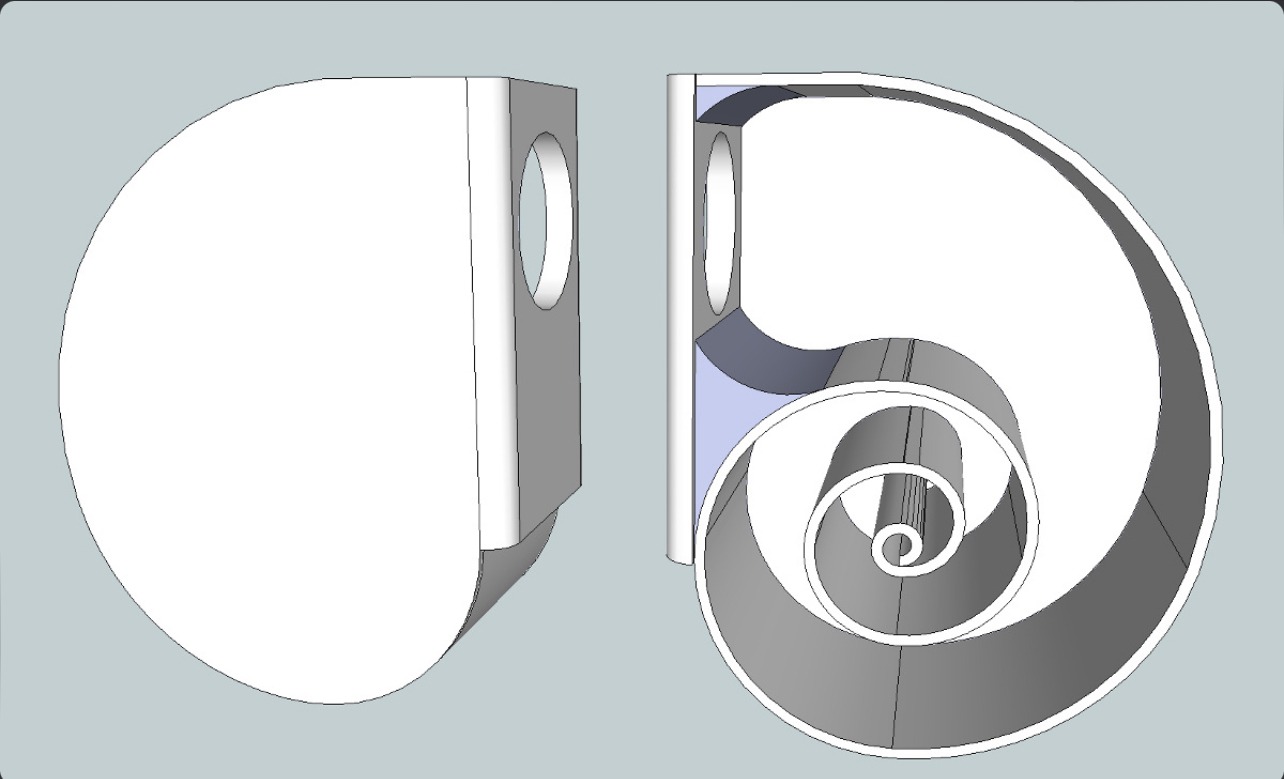

Member @BuildMeSomething made some nice CAD models.

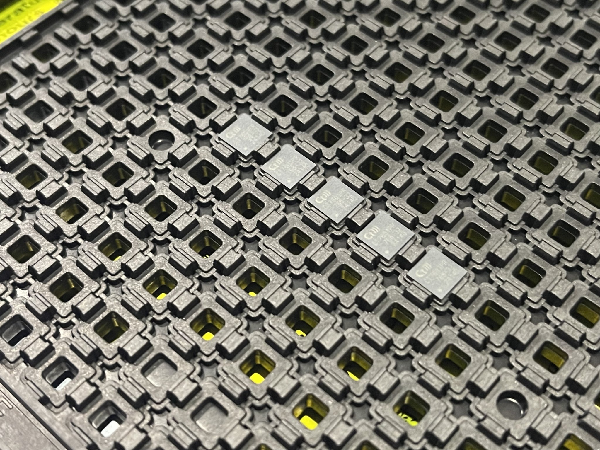

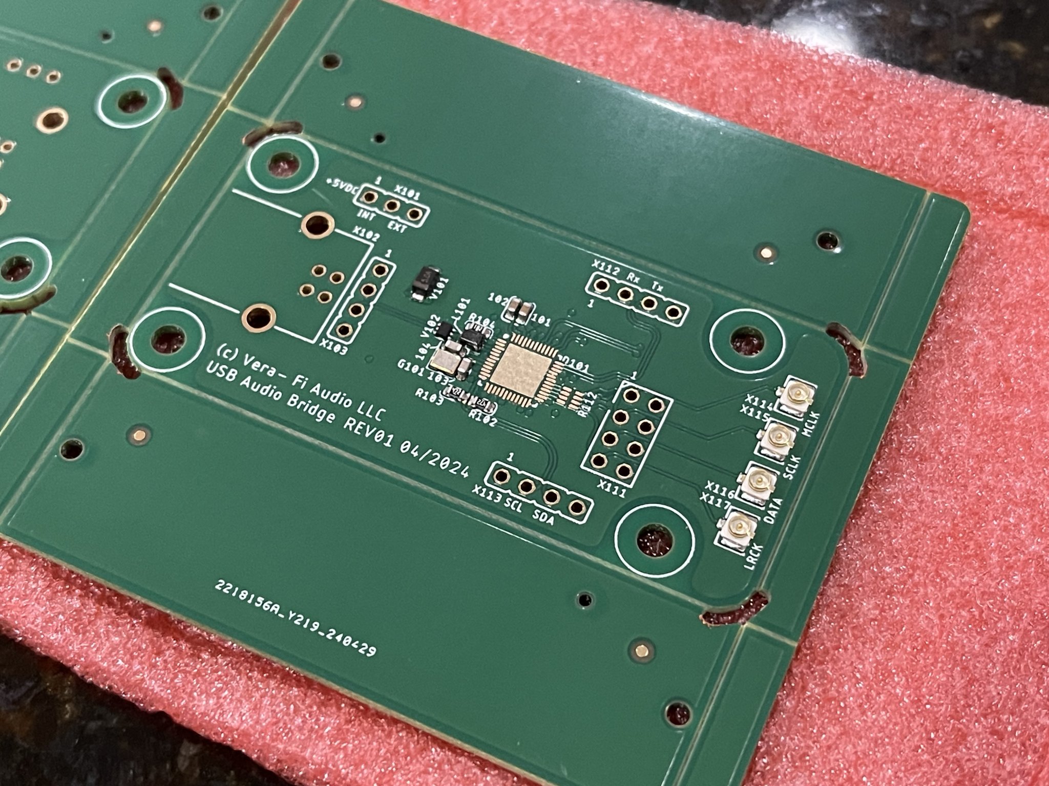

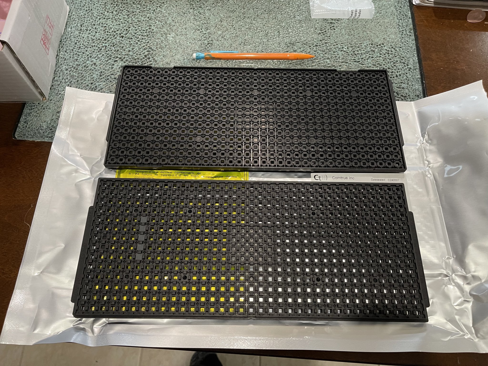

On the bench tonight is a test board for a new DAC that we are developing. This is the USB bridge using a ComTrue chip. I ordered some 5 samples of a QFN48 and it arrived in a “waffle iron” style chip carrier that holds 490 chips. Crazy. Now I have to solder those things on - 0.4mm pitch solder pads.
Paste, hot plate on the bottom and hot air on the top.Uff da! Good luck on the soldering. (Better you than me)
I'll be interested in following the development of this new DAC.On the bench tonight is a test board for a new DAC that we are developing. This is the USB bridge using a ComTrue chip. I ordered some 5 samples of a QFN48 and it arrived in a “waffle iron” style chip carrier that holds 490 chips. Crazy. Now I have to solder those things on - 0.4mm pitch solder pads.
Interesting, i never heard of ComTrue, in past i have designed DAC around Cmedia USB to i2s Interface Chips. Schiit audio uses CMEDIA Chips for their entry level products.
How do you verify if there is no short between the legs. Can't be seen from top. I guess it will either work or not 🙁Paste, hot plate on the bottom and hot air on the top.
Neither. We use a sample rate converter to turn all digital signals into pulse density modulation (PDM) which is similar to DSD. The PDM signal is then fed to a discrete 32 tap FIR filter in conjunction with an output signal transformer to reconstruct the signal. The output signal will be intrinsically balanced and galvanically isolated from the input.X,
Discrete R2R or DAC chip based?
@adason - the trick is to use very little solder paste. Warm from bottom with a hot plate (but below melt temp). Hot air from above to take it to melt stage in precise location. That’s why we have so many test header pins. To check that it works.
