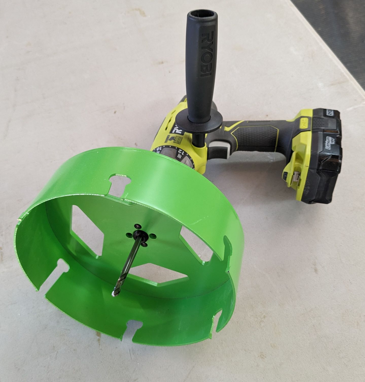

Nice. You can actually cut woofer driver holes with that one!Mine's bigger 🙂
It was first time I used a hole saw in BB plywood. It cuts faster than you think. There is an optimum speed and pressure so it cuts without becoming a friction fire starter project. It was smoldering the first time I did it. Not enough pressure so it just smokes the wood.

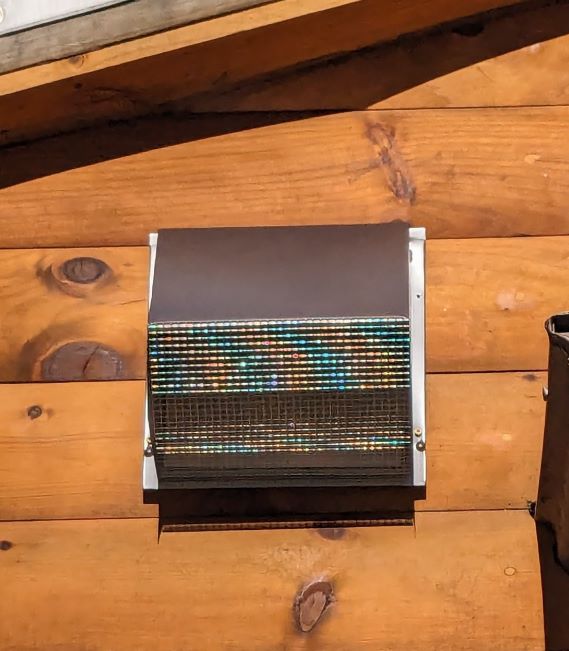

I would never use it for driver holes for that reason--it doesn't feel safe at all. Once it spins up it's got a lot of momentum, and you can feel it jerking your wrist even without cutting anything. But I need to cut an 8" opening for an exhaust fan in our greenhouse, and that hole saw seemed liked the only option. I've got to cut through the log siding from the inside of the greenhouse, and then cut through the tongue and groove paneling from the outside. On a ladder, no less 😵
I cleaned off the saw with some sandpaper and it cut the second hole just fine. That tar makes a mess though but too much of a pain to peel it off.Once the teeth get jammed up with Noico tar, No more cutting for you.![]()
I have to marvel at how clean and straight the hole was though. Compared to a jigsaw or a router, this was much much easier and less messy.

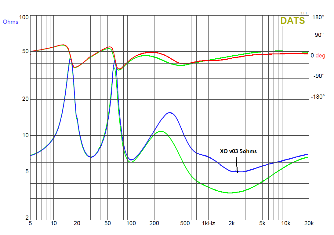

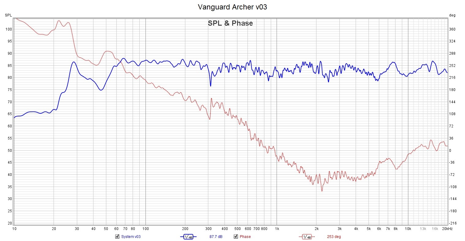

I just revised the XO to avoid the low impedance minimum on the tweeter. Lowest impedance is now 5ohms and it actually sounds better because the amp is less stressed.
Measured XO response:
Measured Phase is smooth and linear through 950Hz XO point:
Measured Impedance with DATS shows 5ohms minimum:
I reduced the size of the high pass cap and increased the inductor value to achieve this.

Cutting a vent hole through double floor joists was a similar experience.I would never use it for driver holes for that reason--it doesn't feel safe at all. Once it spins up it's got a lot of momentum, and you can feel it jerking your wrist even without cutting anything. But I need to cut an 8" opening for an exhaust fan in our greenhouse, and that hole saw seemed liked the only option. I've got to cut through the log siding from the inside of the greenhouse, and then cut through the tongue and groove paneling from the outside. On a ladder, no less 😵

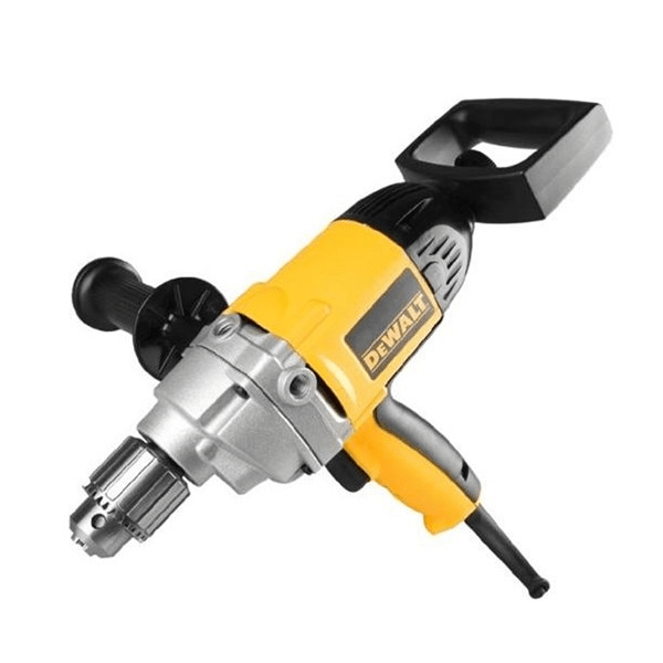

That's when you use one of those pro drill motors with big side handles for more torque handling.
Actually, the lightweight Ryobi 1/2" drill did OK going from the inside, through the foam insulation and sheathing and through the log siding. But I couldn't use the hole saw on the tongue and groove paneling because the saw vibrated so much that it opened up the centering hole in the soft pine, and the hole saw just wandered. But I finished off the inside opening with a jig saw and all is well. We've got the exhaust fan running full time because those cannabis plants my wife planted stink up the house 🙂. We're not users, but she wanted to try growing some of the CBD variety when they became legal in MD last year.

I agree with big hole saws being dangerous, I only use them if no other choice with a drill, I use a drill press when I can, far safer and easier. As for big industrial high torque drills, be very careful, I was using a 1" ships auger wiring up a house, hit a nail, sprained both wrists, knocked my off the ladder and broke the drill handle, ouch all around.
I can cut very fine big holes with a good router, straight cut plunge bit and good circle jig, have done up to 14" in 1" MDF just fine and not that hard to do.
I could of used a jig saw, I have a couple of great ones, I just wanted to try the big holes with the jig and 3HP router.

My "big" Makita - with the missing side handle - has hurt me also. They dont stop when they hit something in there and the torque reaction just transfers to your hand, holding that little stubby handle.As for big industrial high torque drills, be very careful,
I cut the 15" and 18" holes in my tombstone OBs using a router and circle jig I made myself. Two passes, one on each side of the 1.25" MDF table top to deeply score the circle, then chased the clean edge with a jig saw to finally cut-out the piece. Such a long, noisy operation...dust everywhere; pretty sure I was running the vacuum simultaneously with the router.
I have made my own circle jigs as well, really easy to do and they can work as good as a commercial unit, which I bought one just to have it and only used it on the four 15's. I agree, very dusty and I had two overhead filters running as well as vacuum near taped to the router.
Circle jig and router makes a great circle and rebates but messy as heck. I would have to do it outdoors on a sunny day and let nature take care of the dust generated.
The hole saw with a 2in hole was not too bad torque wise.
