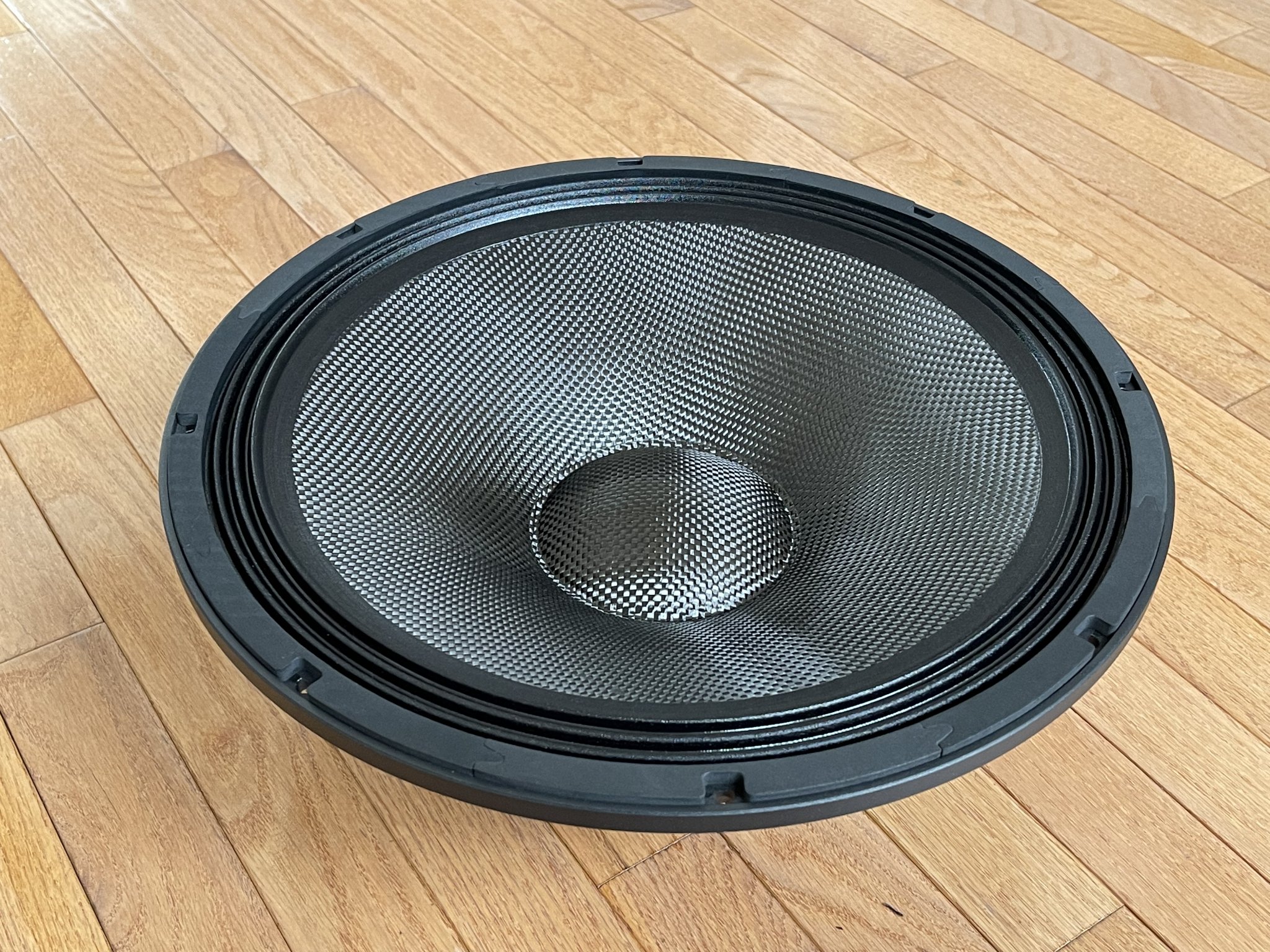

These are some OEM 15in carbon fiber cone and dustcap with doped PA-style cloth surrounds that I just received. These are designed with a high Qts for use in an open baffle speaker. Listening to it in open air sounds quite nice.
Nicely made with cast aluminum basket with spring loaded binding posts:
I listened to them in open air running full range. Quite pleasant and clear sounding.

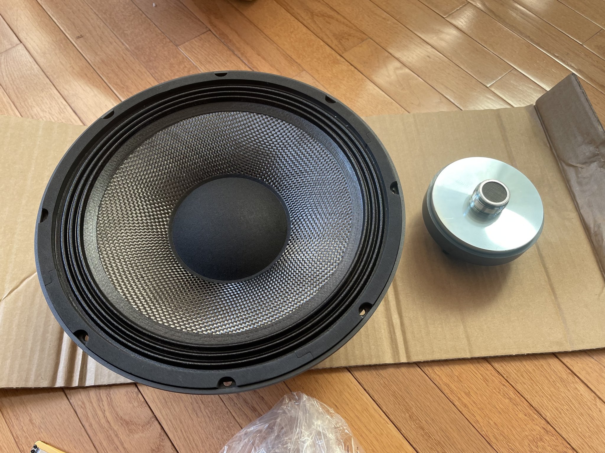

On the bench is the companion 12in coaxial with compression driver. This is a beast - 16.2lbs for the combo. Massive magnets.
I guess a high sensitivity pro audio style speaker may be in the near future here?

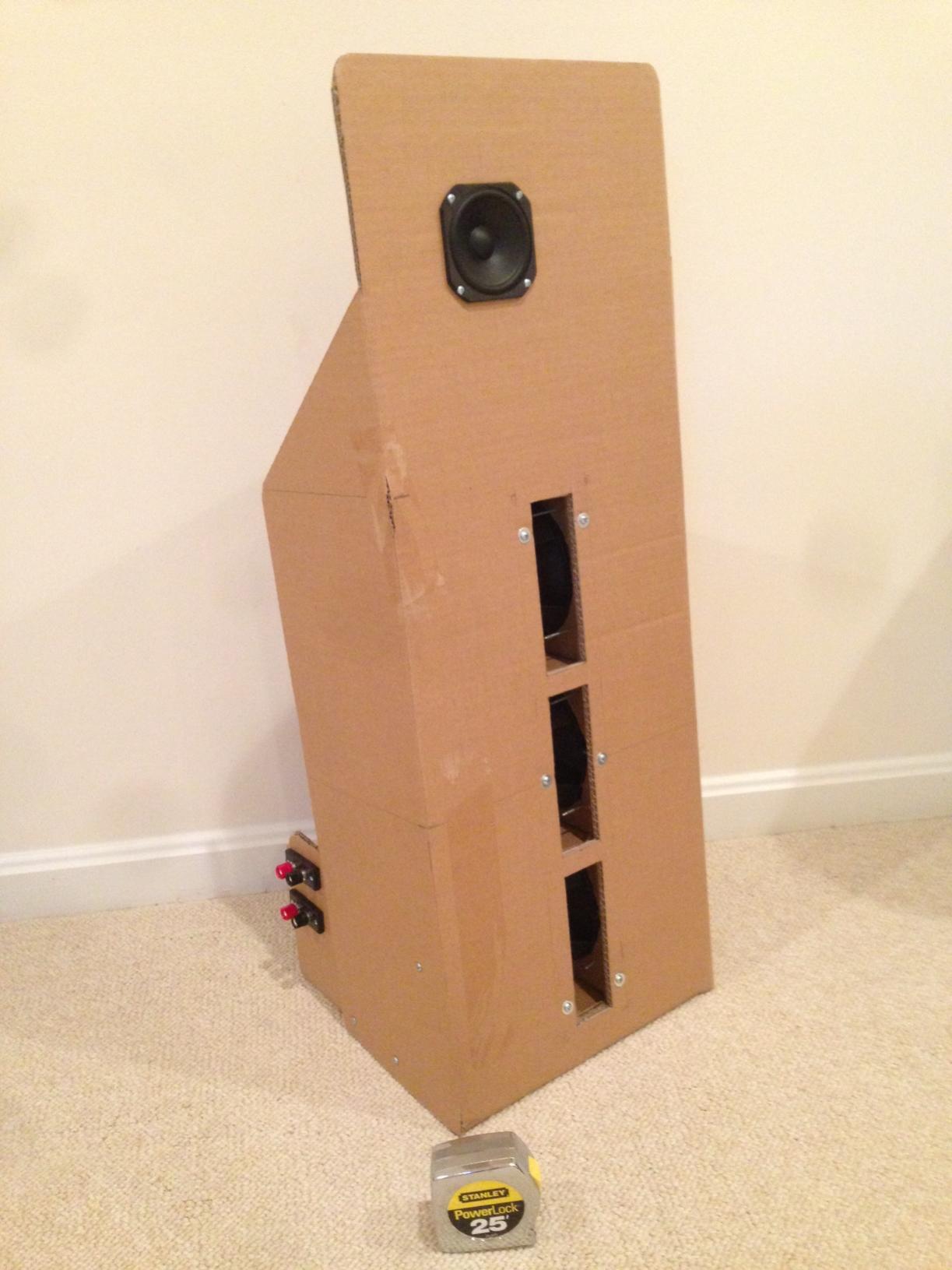

I promised myself that I would revisit this speaker one day in wood. It sounded so good - even in cardboard!
https://www.diyaudio.com/community/threads/cheap-and-fast-ob-literally.249984/page-21
Well that day has come. 🙂

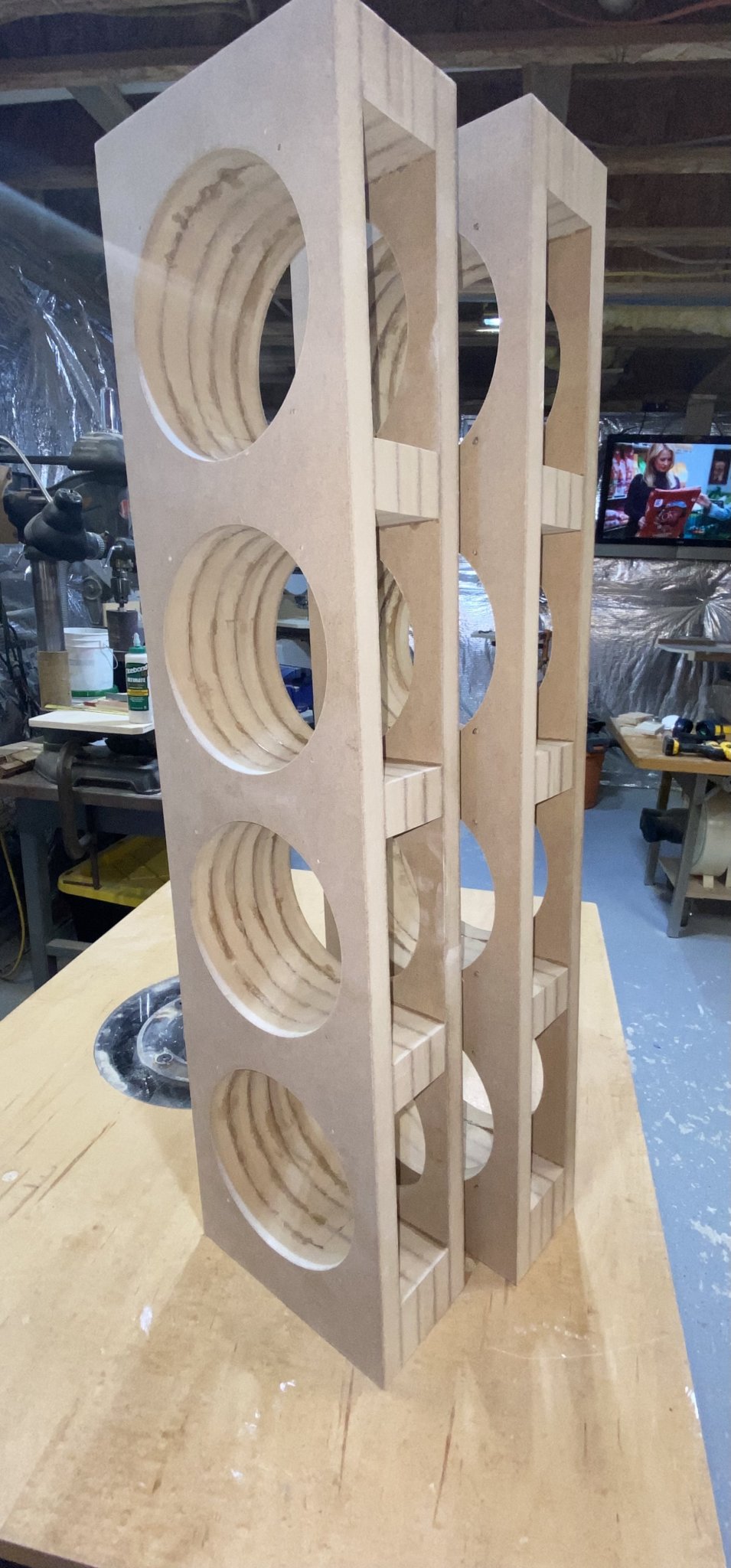

I have a local cabinet maker helping me to build these and we have finished the woofer manifold. Going with 8x 6.5in woofers this time for nominal 4ohms on woofers.

Wow, this will be interesting. Great cabinet work! Looking forward to the final result and listening impressions X.I promised myself that I would revisit this speaker one day in wood. It sounded so good - even in cardboard!

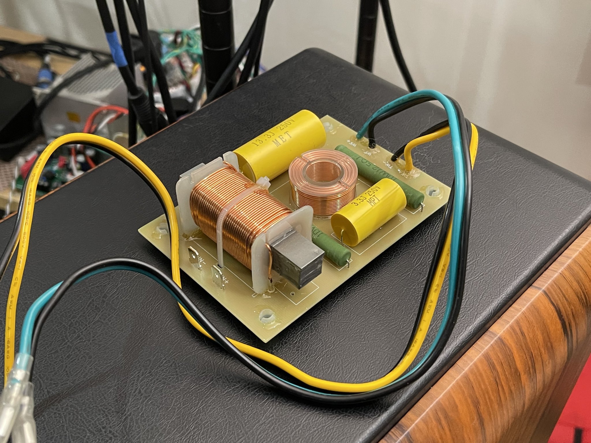

Yes with 60 degree coverage does works perfectly with that setup.If you draw a sketch with your speaker positions (8ft back) and spacing apart makes a difference. Assuming typical 5ft wide TV and speakers 7 ft apart the angle is arctan(3.5/8)=24deg to the middle of the sofa. If you toe-in the speakers a bit, I think a 5ft wide 3 person sofa should have pretty even coverage based on 60deg included angle.
LSA Signature 80 is on my top 5 list.
From post #517 you are working on a ribbon speaker. Will that be commercial available? What are some of the major sound difference between planar and ribbon speaker you are offering? What brand are those ribbon and planar if it is ok to mention it.
What attract me to your speaker design you include the time and phase response aspect of it. With your Harsch crossover, do you need to listen from a certain distance and or within the sweet spot from the speaker to get correct arrival time of the sound? I have a friend who have the Green Audio Mountain speaker that is time and phase align using first order crossover and physical align the drivers. But you have to sit at the sweet spot and the correct distance to get the perfect time aligned sound.
Thanks for the center speaker suggestion. I will keep that in mind when doing auditions.
Hi Ken,
Technically the perfect time alignment from a non coaxial speaker can only be perfect at one spot. However, as I have found out from my 10F/RS225 FAST speaker that it’s quite forgiving. It’s still way better than having a LR4 that has a non time aligned step response even at the sweet spot. The planar is a GRS but with my custom CNC’d bezel/waveguide. The ribbon is custom OEM made for LSA.

Originally proposed by Samuel Harsch as a way to get quasi transient perfect time alignment and flat phase for IIR filters in DSP based speakers, I was able to implement it as a passive crossover by pushing the XO frequency higher in order to reduce the requirements for such a long time delay or phase shift. Also requires drivers with wide bandwidth and good behavior at breakup.
So far, I have managed to do this for a couple of speakers using passive means.

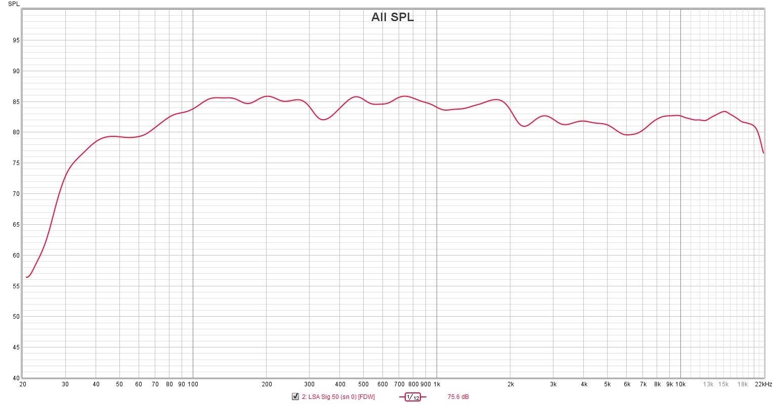

Far field In-room Response, 6 cycle Frequency Dependent Window gating:
