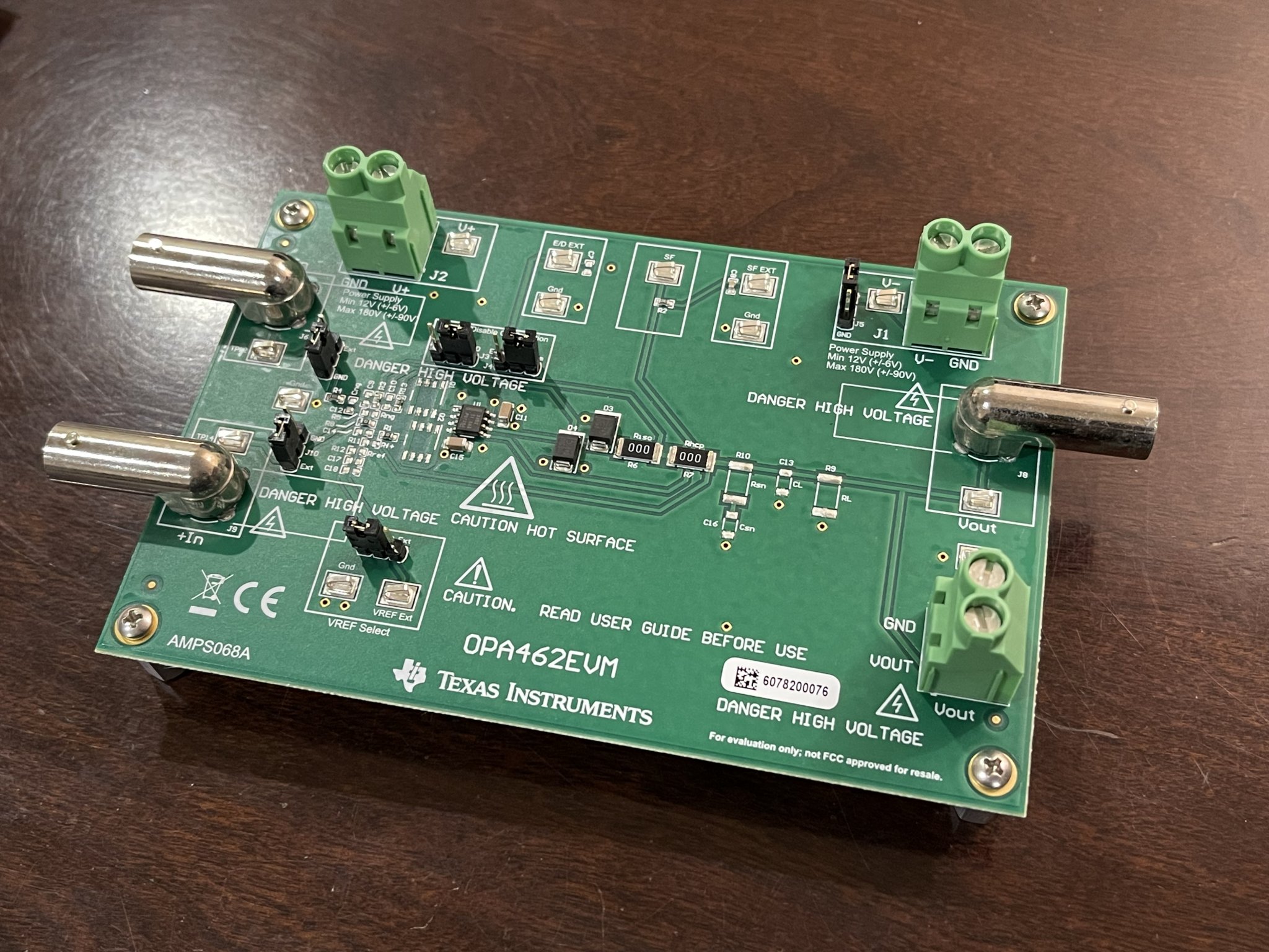

I am currently also researching very low noise and very low distortion Solid State preamplification for that kind of application.

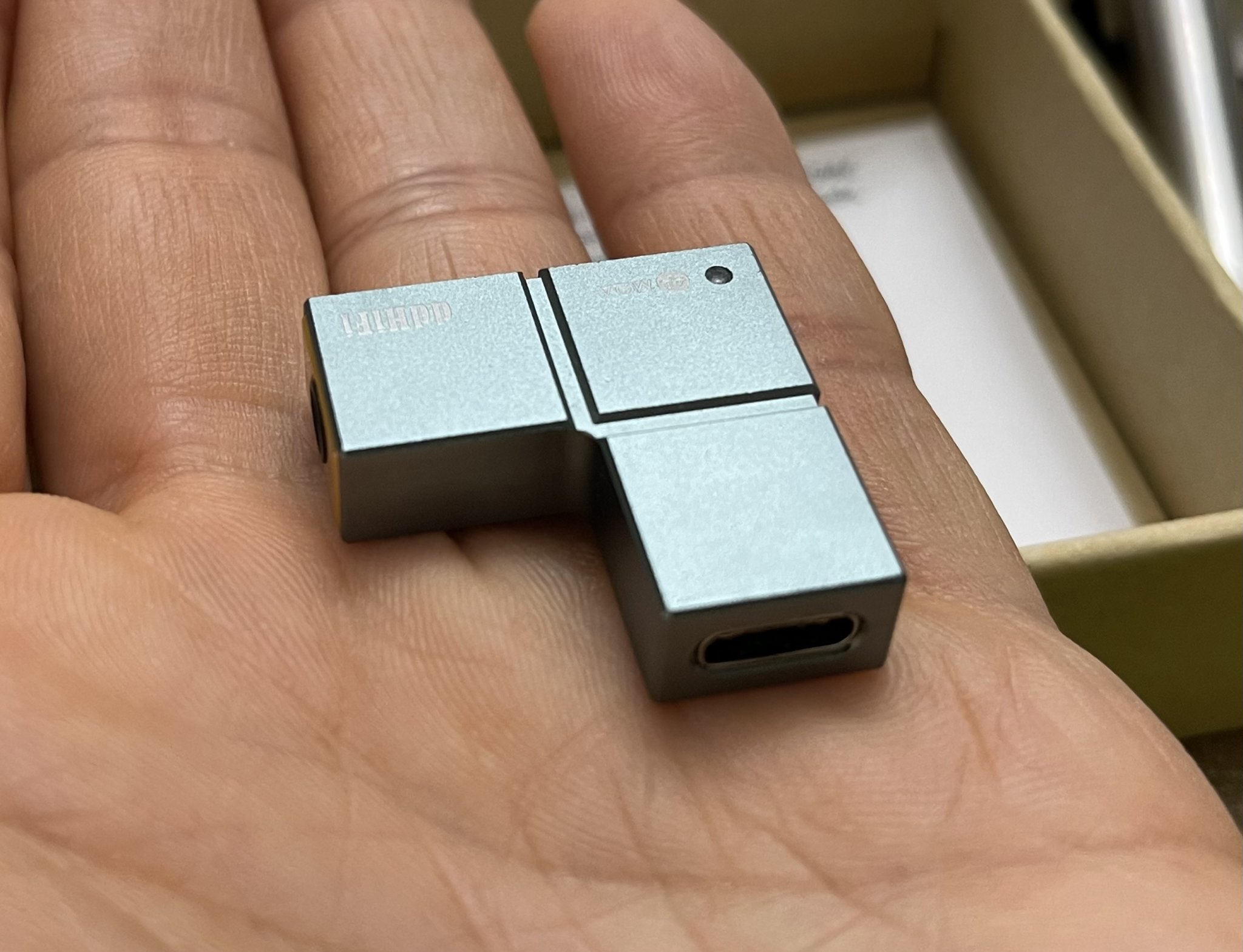

One the bench is a cute little new DAC from ddHiFi ES9281 in the Tetris shape. It’s feature packed and sounds very very good. It has several cables that convert to USB-C. I am connecting to directly to my iphone lightning plug.
Here it is connected to a headphone jack and the iphone adapter cable.

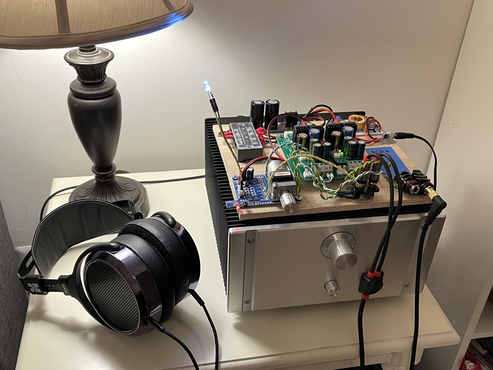

I connected it to the ACP+ with the motorized volume pot and used by OB-1 headphones. Wow that sounded great.

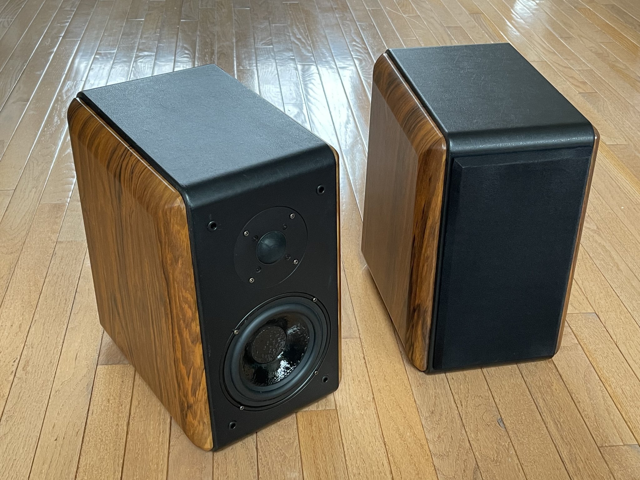

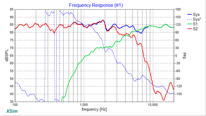

DHL just dropped off the first production samples of the LSA Signature 50 speakers that I designed. 6.5in woofer and 28mm fabric dome tweeter. First speakers commercially sold with passive Harsch XO:

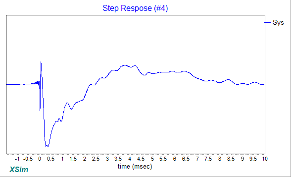

Quasi transient perfect step function is inverted due to mic:

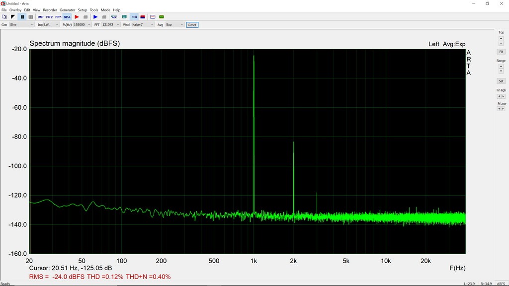

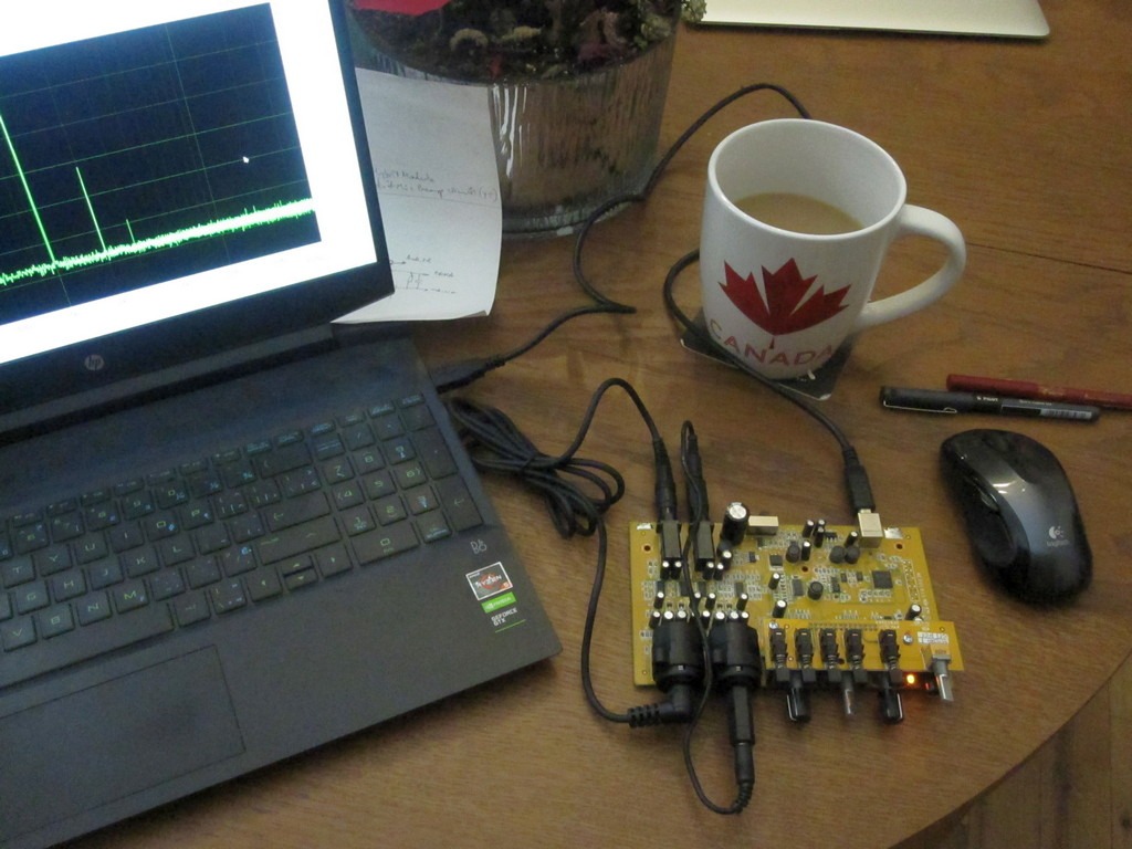

What's better than revisiting the audio interface after a simple mod for turning the DC Booster off while enjoying some Freedom Tea? Nothing at all, eh? Of course I brought some of my gear from Desk Lab 1 to the dinner table, taking some notes for the next steps.
Will re-check all spuriae and harmonics produced by the signal path in various modes. For now, the pesky large hihg-freq spurs are gone, so there should be less intermodulations:

Yes, it seems quite good so far as a retired EE jumped in the thread to tell us of his own investigations. Removing an inductor puts the boost off and I don't need to cut a trace. With trace cutting, it's easier to install a second switch for True Phantom Off.
Now that the Boost is truly off, I can investigate additional mods properly. If I hadn't done that one first, it would have intermodulated all the time, no matter which mod I had done and that would have made a proper evaluation of the mods impossible. In the thread, there is a differential card, itself using a DC-DC Booster. Can you imagine both these boosters interacting among themselves and then intermodulating other signals?
Another thing I checked today is the behaviour of the Input Gain and Output Gain, as well as the caps along part of the signal path. I may have a couple of changes here just to check distortion reduction.
That preamp just sprays harmonics as soon as it's switched On. The interface behaves better if I use 'Pad' when the preamp is On.
Shortening the sig. path here seems to be a good thing to do. I am wondering about keeping the XLR input for measurements though.
