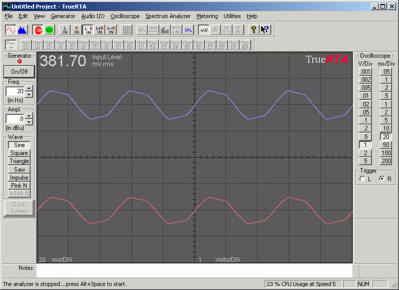

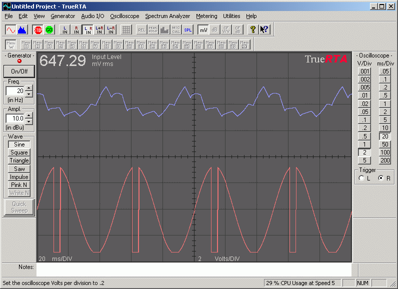

OK, so I decided to drive the amp into clipping and look at what happened. I decided to do it with a 20Hz sine wave....
in the past the clipping performance of the amp has been fine, just get a flat on the crests and dips of the sine wave no nasties...
today it is a very different result to what I have seen before. I'm wondering if this might shed some light on what is going on.
the top trace is the power supply ripple... it is being modulated by the 20Hz sine wave and is peaking at 600mV not so good. Might be time to hook up that second transformer 😉
The bottom trace is what is happening to the sine wave when it clips... yuck.... any ideas as to what is causing that?? the supply rails droop severly when it starts to clip. no load they are about 62V, heavy load no clipping about 59V, as soon as clipping occurs about 58V.
voltage on the 8 Ohm dummy load is only about 21V before clipping. I don't think I'm getting max power here :xeye:

Looks like you've been doing some work hey!
1. What's the sound card baseline performance like? You may find that its got a lot of crosstalk to begin with, which would explain why running a DVD player as the source "cleans up" the crosstalk perfrmance a lot.
2. Your supply voltage drops, IMHO are pretty normal (well, at least as far as power transformers where I live go, its much worse!) You can always expect a few volts of drop when load is heavy.
3. Sinewave at 20Hz with a funny clip - is that happening on both channels? With the 8-ohm dummy-load connected, place something like a 47ohm resistor and drive a loudspeaker. Listen to the speaker and verify that the signal you see on the computer is really what is coming out of the amp...
Power levels do look way too low. Try probing around the VAS stage and see what the voltage swing is like...
Cheers!

Yeah both channels were exhibiting that weird clipping behaviour, and it was at the dummy load, also it seemed to make little difference if it was one or both channels being driven. I decided to resolder the power supply connections, as I have had weird distortion problems that went away after resoldering the PS before.

edit: that'll teach me to do testing late at night, that weird clipping behaviour goes away if I change the sc preamp to X 0.01 instead of X 0.1.... it was either the sc preamp or the sound card exhibiting that behaviour.... I think I need to recalibrate the clipping indicators on the sc preamp!!
Tony.
OK here is what the "real" clipping looks like. This is different to when I tested this amp a year or so ago, in that back then the clipping was completely flat across the top and bottom of the sine wave, now it is sloping.....
just before clipping the voltage was about 31V so that should equate to pretty much full power. the ps sagged to 53V (its sitting at 63.5 at idle today)....
the blue trace is taken with the probe connected between the collector of Q6 and the trimpot... the red trace is at the dummy load. I'm guessing that one rail is collapsing a little earlier than the other giving the slight slope in the clipping...
Anyway I'll stop looking at that, but might try resoldering the PS wiring yet again :xeye: It is one area where a bigger soldering iron would be nice 🙂
edit: just realised I hadn't checked the clipping at 20Hz before, was 1Khz... just checked with 1Khz and the tops and bottoms of the sine waves are completely flat 🙂

Tony, that looks like it could be more caused by small coupling capacitors on your sound card. Here's a simple test - switch over to a slightly higher frequency - say 80Hz. Have a look at the output waveform - I think it'll be a much less slanted. It would also explain why 1KHz clip looks flat - there isn't enough time for the coupling capacitors to discharge at that frequency to make it visible as a slope...
I think this is all getting to one thing - there are some pretty severe limitations testing with a sound card!

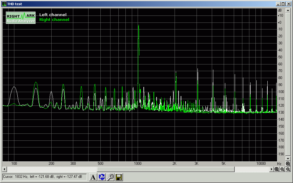

I spent yesterday trying to track down the source of higher distortion in the left channel. It is currently sitting at about .11% THD compared to 0.03% on the right channel. (ironically it is the right channel which plays up when run through the preamp)....
Both chanels before I did anything to the amp used to run at about .05% distortion. I thought putting the ccs back in would fix it but it didn't... maybe I'm worrying about this for no reason, but It is bugging me... I thought it was due to the non-optimal choice of ccs replacement but it doesn't look like changing the ccs makes much difference regardless. I haven't tried to work out what is going on between the pre and power amp, I've just been concentrating on the power amp driven directly off the sound card.
anyway attached is a zoomed in look at the thd measurements.. I changed the test freq to 1020 Hz so that I could see what was PS related and what was harmonics. One thing that seems strange to me is that the second harmonic is almost identical between the two channels but the third and higher harmonics there is a big difference. The other thing that I find very strange is that there is a huge difference between what appears to be PS related noise between left and right, at 100Hz and then each harmonic above this. I thought I was onto something there and resoldered the local filter caps (100uF and 22uF) on the pcb, but no change.
I think I'm going to have to accept that the amp worked better before I touched it, and maybe one day I can work out what I stuffed up. I went back through all of the RMAA tests I have done, and at one point everything was actually pretty good performance wise, but I was still seeing big differences between chanels voltage wise, and still had more noise in the right channel, so I continued on, then it all went bad... the point it went bad was when I changed the 27K ccs replacement resistors to 30K. I think if I ever do this again, I need to write a diary!!!! so I know EXACTLY what changed at each step. I don't think I did anything but replace those resistors, but maybe I did....

Hey, you'll still have the weekends to work on it! 🙂
- check the bias - the optimal bias point for each channel is not necessarily the same. Could explain the odd harmonics difference.
- Try to find out why there is PS-noise getting in, stronger on the left. Easy to parallel some electrolytics, particularly at the CCS, just for a quick try!

Thanks Clem_o, I suspect that the higher noise and THD are related... would seem to make sense, I thought maybe the NFB wasn't working properly so resoldered around all those components yesterday with no change.
I just tried paralleling 2 X 680uf caps across the 100uf caps... (680uf was then only cap I had that was high enough voltage rating)...
no change whatsoever.... weird.
