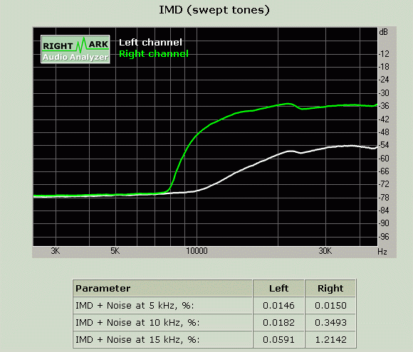

OK this looks more like the problem 🙂 I had figured that I was getting intermodulation distortion, based on listening and only noticing the distortion in the tweeter, when there were loud bass passages.
Now to track it down!! I'll have to solder my test leads in before the final opamp to see if that's where it is occuring.

Hmmm interesting graphs. Is that the preamp output with or without any loading? Look for leaky decoupling capacitors (and yes, bad solder joints... ! )

clem_o said:Hmmm interesting graphs. Is that the preamp output with or without any loading? Look for leaky decoupling capacitors (and yes, bad solder joints... ! )
Cheers

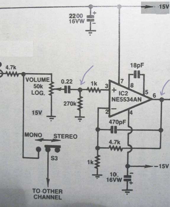

That was with the preamp still connected to the amp. might try unloaded.... I have attached the schematic of the offending bit in the preamp... rmaa measurements taken at the points with arrows. before the ne5534 the IMD is actually higher (probably due to having to crank up the sound card input levels to get enough signal) for the left channel, but it is relatively consistent between channels, so I guess it is something with the opamp part of the circuit, at least I have somewhere to look 🙂 the whole preamp is an abomination of cmos switching ic's and lf351 buffers! The output of the opamp is directly connected to the 1uf coupling caps of the amp.... it used to go to another ne5534 in the tone controls, and then a balance pot but I bypassed these years ago.

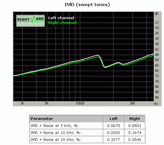

OK that previous graph is rubbish 😉 definitely not a good idea to crank up the gain on the sound card, tried using the 10X gain on the SC preamp instead and have a much better result 🙂 definitely shows that the problem is occuring between the input to the ne5534 and the output!!

OK that previous graph is rubbish definitely not a good idea to crank up the gain on the sound card,
Yup. I spent a week in the spring trying to figure out whay an amp that sounded OK had such terrible RMAA distortion figures. What I was seeing was distortion from an overdriven sound card.

Yeah it seems like a good idea to clean up the board too, perhaps some wierd coupling issues causing the intermod to rise... Looking at the values around the 5534, gee that's a *really* slowed-down circuit!! Try looking at the 18pF cap and see if there's too much solder flux under it (at the same time I'd probably drop that value to maybe 3.3 or 4.7pF, and the FB network (4.7K w 1K to ground; 470pF) - you may want to try changing that, in case its presenting too much of a load to the 5534 - a 47pF instead would probably a better choice...
- what's going on here?? (much head banging)
