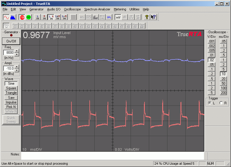

I checked with the pc scope, and I have a 100Hz square wave coming out of the right channels opamp :xeye:
Since it is 100Hz I assume it is power supply related, but square wave!!!! Before I saw this with the scope I took out the 18pf comp caps (no difference) and removed the 470pf caps across the fb resistors (no difference). The blue trace on the attached image is the input to the opamp, the pink trace is the output.....
This is with no signal... also the 0.9mv is really .09mv as I have the SC preamp in X10 mode.
despite the low level, the amp is amplifying it nicely to get a very loud buzz in the right channel speaker.

wintermute - that square wave and that zobel burning is due to high-frequency oscillation that your PC-scope can't see. Its probably in the MHz region. You can't expect that your left and right channel ccomponents and layout are exactly the same, so it may be that there's just a tad more instability on one of the channels than the other.
I thought that the 5534 would be a bit tamer, but seems it isnt. Put a 3.3pF or 4.7pF back onto compensation pins of the op-amp and see if that fixes it.

I just pulled the zobel resistor out and it was open circuit... I replaced it, and put the rail fuses back in and guess what It's clean 🙂
I think that my next step should be the mods that you and amp guru suggested 🙂 as it looks like as you say the right channel is oscillating, and that is probably the root of all my problems.
