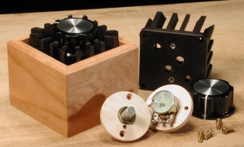

Got first batch of parts from Mouser today. Pots, heatsinks, knobs and some resistors for law-faking the pots.
Pots are 16mm miniature carbon comps from Xicon. 100k linear taper and just for grins, I bought the ones with 11 detent positions. I bought 10 pieces and out of the 10 was able to find two which matched quite closely. With the law faking resistor, the match is better than 2% for all positions.
At the left in the photo is a simple mock-up with the cherry chassis which has since had one application of oil finish.
For mounting the pots/knobs, I made some discs out of hard maple the same diameter as the skirt of the knobs. They'll nest within the heatsinks using some 1/2" threaded spacers (via the vertical pair of unplated holes).
The wiring for the pots will feed thruogh the pre-punched hole near the upper left corner of the heatsink that's laying on its side.
The knobs will be getting a make-over. The aluminum insert in the top will be replaced with a cherry insert. The white indicator will be painted black and the indicator will be some 22 gauge copper magnet wire with clear insulation that will run down the indicator channel.
