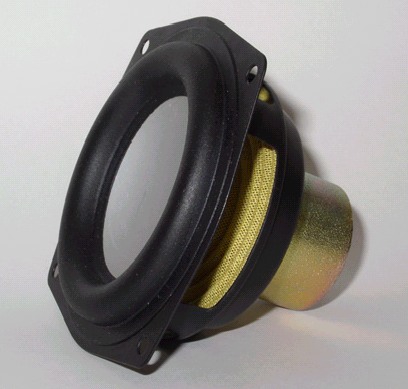

Also, it's time to upgrade the sound system attached to the TV, currently suffering from decidedly non-high-end speakers. Some Jordan JX92S' are in the post as I speak.
Obviously, you'll read about it here first :)
