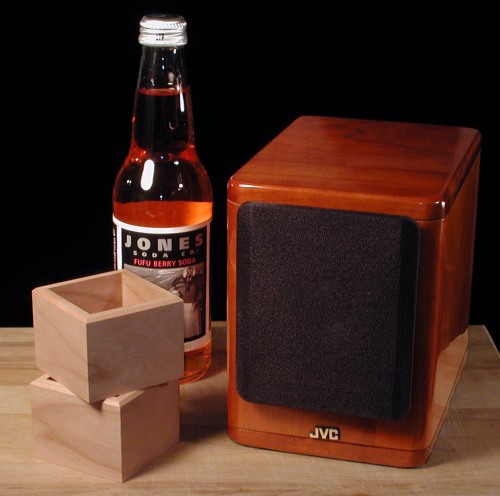

Ok, not midway through anything so a just out of the chute photo will have to do.
For a couple years I'd had the notion of building some miniature monobloc integrated amps for my desktop to drive the speakers of my old JVC FS-2000 "executive" system (which has line out jacks).
I'd made a few initial stabs at it but thus far nothing had been quite as small as I'd have preferred.
Last night I was perusing one of the parts catalogs when I saw a cast aluminum heatsink intended for TO-3 devices. I'd seen it many times before but when I saw it last night, it gave me an idea as to how I could pull off a pair of miniature integrated amps.
I took the dimensions of the heatsink and the various other parts and sat down with AutoCAD for a while and figured that it should all work.
Today I ordered up some of the main parts (heatsinks, pots, and knobs) and this afternoon I did the woodworking for an initial mock-up of the amps.
If everything works as planned, each amp will have dimensions of 2-3/8 x 2-3/8 x 2-3/8 (about 60mm x 60mm x 60mm).
I've been wanting to work on my photography chops so I set up a little vignette which includes one of the FS-2000's speakers, a 12 oz. bottle of soda to give some sense of scale, and the unifinished cherry boxes I'll be using for the chassis mock-up.
The circuit will just be a simple LM-3875 affair with a +/- 12 volt supply (about 10 watts into 8 ohms). I'm not going to use input transformers for the first project but I did some doodling and I'm pretty sure I can do a trasnformer version within the same chassis dimenions.
Basically the heatsink will mount inside the cherry box with its fins sticking up 1/4" above the top and the volume control knob mounted concentrically within the heatsink and sticking up 1/4" further than the fins giving a total height of 2-3/8".
Anyway, here's my "just out of the chute" photo.

Hi Steve,
You certain move faster on an idea than I do. I keep changing my mind. The only thing I haven't seriously considered is tubes.
And I was just thinking, I should take an AutoCAD course. I have access to it at work, but at home I'm using MS-Word Draw. Visio would be a step up.
Maybe I should have posted my JFET to copper plane in this thread. One thing I like about copper is it has a higher thermal conductivity than Al. However, the heatsink you have will likely be thick and have nice folds, etc. Maybe you know this already, but diamond is more than twice as thermally conductive as silver (which, of course, is better than copper). Diamond is unusual this way in that it is not electrically conductive (as most other thermally conductive materials are). http://www.nationmaster.com/encyclopedia/Thermal-conductivity
No major comments on your project. It seems like you got it worked out. One interesting point, you are making a miniature system. I did notice how small your mono blocks are to the mini speakers. This falls in line with your minature cloths pin (oh...darn, I HAD to bring up Woody again...).

Hehehe. Two years is fast? 🙂
Unless you're going to do 3D modeling (which I don't), just get a third party book and play with it. I use it for 2D drawing and drafting and don't use more than half a dozen or so commands on a regular basis.
Yeah. But can you imagine what a diamond heatsink of any size would cost? Yikes!
Damn you, John Ferrier! Damn you to hell!
WOOOODDDYYYYYYYYYYYYYY!!!!!!!! :bawling: :bawling: :bawling: :bawling:

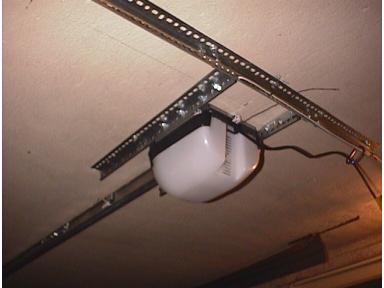

Its the Genie Excelerator. Works good, but the lead screw shutters a little. The low ceiling height on the garage ceiling kept me from doing any vibration isolation, so its a bit loud in the house.
I also built a workbench for the back of the garage but haven’t taken any pictures of it. I still have to add some edge banding to it and slop a couple of coats of poly over it.
If I ever finish this crap, this is where I’ll do some of my DIY audio stuff.

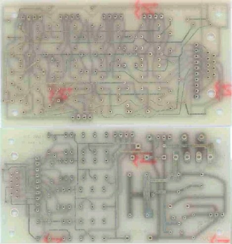

Working on My BOSOZ, just got the ever elusive switches, and just received the circuit boards from custom pcb, and turns out they actually work...mostly! As usual I went for too much, this thing is very complicated and my case is turning out to be very tight. Here are the boards, top one is for relay switching of the 4 balanced inputs, bottom one is for switching the selector LEDs to light up the one you selected, and on it is a regulated power supply for the auxilary circuits.
I am also working on an LM3886 Gainclone, you guys never mentioned that you have to connect up the "Mute" pin to unmute the chip. Jeeeeez, that would have saved me a day. Or I could have read the 1st section of the data sheet/ app note.

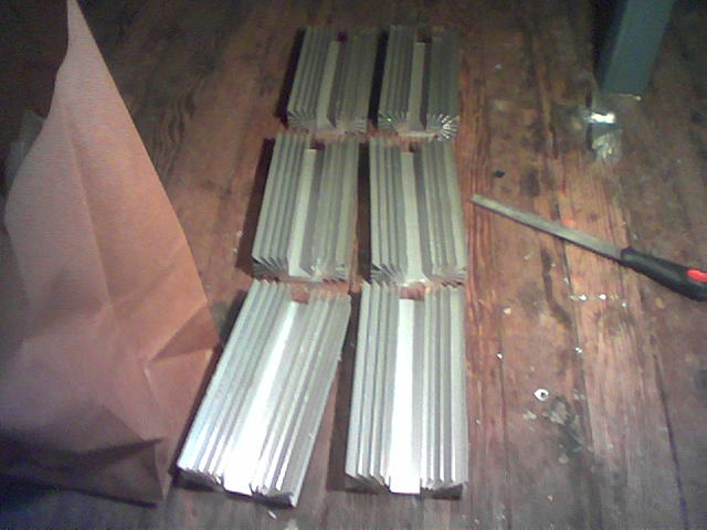

Trying to think of what to do with the pair of 45lb (20 kg) heatsinks I picked up the other day (20x9x6 inches),
(Pair of big monoblock, class A amps... ...maybe, heatsinks for 2kW car amp?!?)
