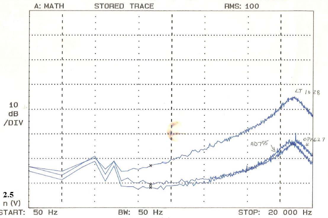

The RLC of the motor circuit still sees 47K the contribution of the load resistor is unchanged. For your amusement a noise plot (unequalized) of several op-amps with a real Stanton cart, 47k, and recommended C.

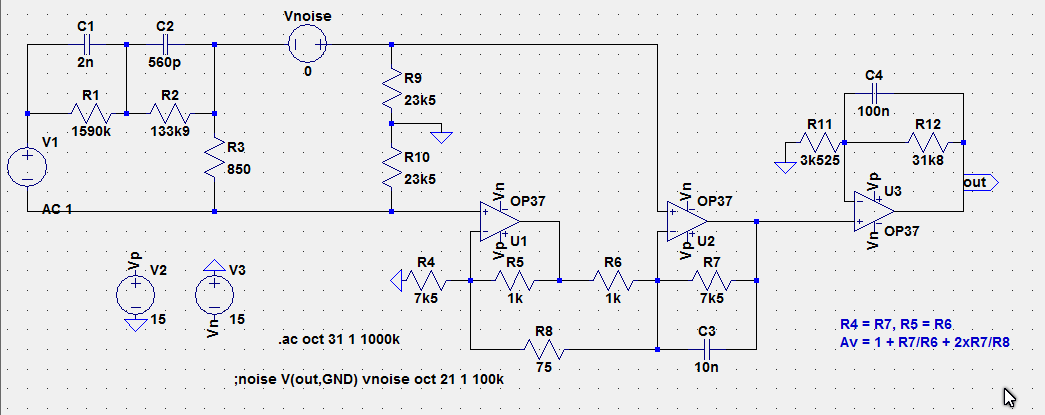

I will do a diagram so we can be sure we are on the same hymn-sheet.

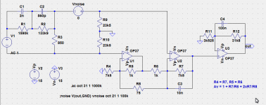

This is the situation I have in mind. So what do you think? A valid model?
Note the 'ground' at the mid-point of the cartridge is purely notional; there is no physical connection there.
Getting back to balanced MM inputs, I would like to hear what people think about the noise situation. Seems to me it must be worse.
In a balanced input the 47k load will be split into 2 x 23.5k, which will give less Johnson and less effect from current noise, but the voltage noise will be unaffected and there are now two uncorrelated sources of it.
Using cart parameters of 600R and 500mH, and 5534 opamps, I calculate that the balanced noise will be 1.1 dB higher.

I want to know if people agree that Post #84 above is a fair representation of the noise situation of a balanced MM input made with a pair of opamps.

Sure, just that the op-amps shown are not the lowest noise solution. There also is probably a smart way to include less than two complete RIAA's.
They are pretty close if you accept that you are going to use two opamps in the circuit; however that gives you noise from 4 input devices rather than two. But my question remains, is it a valid noise model???Sure, just that the op-amps shown are not the lowest noise solution.

Well I suppose it 'works' if you feel 4 devices in series are OK for a LN device.I want to know if people agree that Post #84 above is a fair representation of the noise situation of a balanced MM input made with a pair of opamps.
The only thing missing is the 'recommended C' that Guru Wurcer includes in his measurements. The NI app note does too.
Don't see why you need to show explicit noise sources. LTspice will do it all for you including the resistor noise. You ARE including the resistor noise ... especially the 47k. see the NI app note.

It's not supposed to be optimal. The purpose is to ask if it is a valid model of how a floating MM coil interfaces with a balanced input.Well I suppose it 'works' if you feel 4 devices in series are OK for a LN device.
So far I understand that the people here think it is. Anyone disagree?
Perhaps, but I don't want it all done for me. I want understand it in detail.Don't see why you need to show explicit noise sources. LTspice will do it all for you including the resistor noise. You ARE including the resistor noise ... especially the 47k. see the NI app note.
