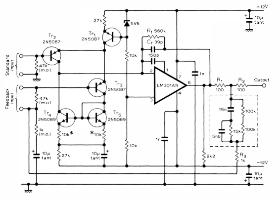

In his Wireless World article "Distorson in low-noise amplifiers" (August 1977, page 30, Fig. 5 and September 1977, page 59, Fig. 9) E.F. Taylor proposed an MM RIAA equalized preamplifer having a floating input inserted in the feedback path. Pictures below, comments welcome. Does anybody know if this intriguing circuit has been used somewhere ?
No I'm afraid not, but some time ago I stumpled across an application note from National Semi called "Audio Applications of Linear Integrated Circuits" AN299 where they used a LM318 in an unusual way (see attatchment).
Unfortunately the LM394 is made of unobtainium as far as I know, but I guess you could use something like 2SA970 instead.

> National Semi ... used a LM318 in an unusual way
That is dead-conventional. LM318 has a speedy output section but poor (for audio) input stage. The Offset pins 1 5 are also all-purpose inputs to the internal gain. The differential pair becomes the new "input section"; the stock inputs disabled by pulling them to V-. The result IS an op-amp, with '394 input characteristics and '318 output.
You could do 99% the same with a '5534. The '318 output may still be faster but how fast can a needle slew? The '394 can potentially be bias-adjusted for best OSI noise-fit, though between '5534 and '394 at 100uA the difference is below vinyl-hiss.
This would also work with many low-noise and even jellybean transistors, though the DC gain of 550 makes 2mV offset a significant 1V output DC. (IMHO you really want a 20Hz pole.)
There are alternatives to MAT and '394 pairs. THAT Corp will sell you some very fine audio-aimed low-hiss matched pairs.

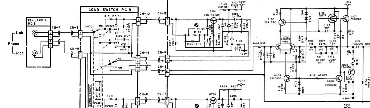

Getting back to balanced MM inputs, I would like to hear what people think about the noise situation. Seems to me it must be worse.
In a balanced input the 47k load will be split into 2 x 23.5k, which will give less Johnson and less effect from current noise, but the voltage noise will be unaffected and there are now two uncorrelated sources of it.
Using cart parameters of 600R and 500mH, and 5534 opamps, I calculate that the balanced noise will be 1.1 dB higher.
That would be quite acceptable if balanced operation solved other problems, but I've yet to hear any convincing argument that it does.
