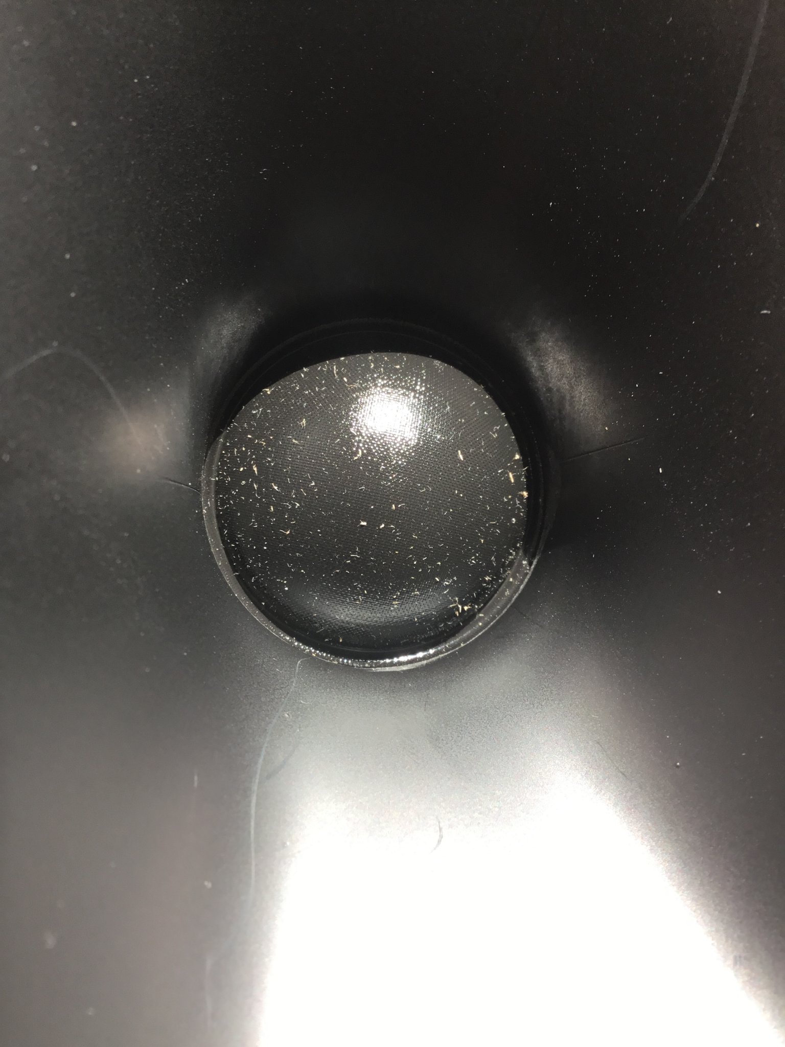

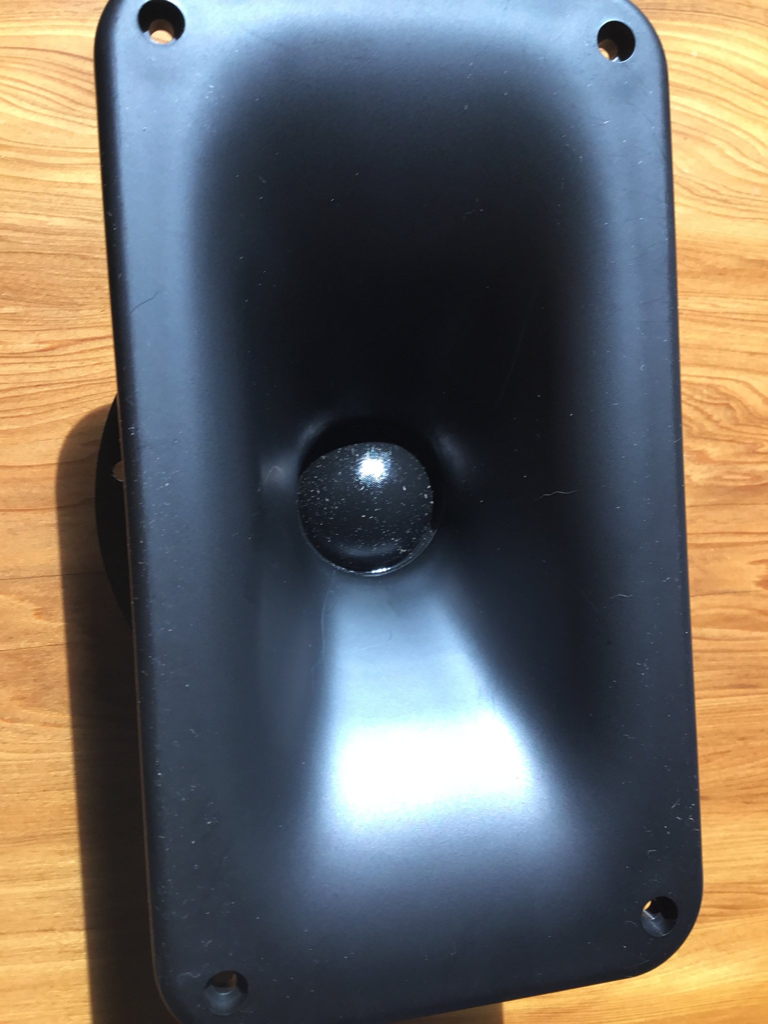

Thanks @profiguy, excellent info…….the circumference of waveguide opening ends up right over the peak of the surround roll and is about 1mm above said peak (see pics) that’s about as good as it could get without being in the way? Would a little putty around the inside edge of the mounting flange (without touching the surround) be helpful?
Man, those domes are dust collectors!

@mountainman bob - That looks good in terms of fit. I'd probably try reducing the gap a little by sending down the throat and chamfering the inside lip of the throat so that it follows the contour of the outer half of the dome surround angle tighter without touching. Reducing this gap as much as possible will improve performance. If you get any buzzing at higher levels, some painters tape used to increase the gap will fix it.

I'd try the WG thr way it fits first and see if there are any weird FR anomalies. It may be just fine as is.
