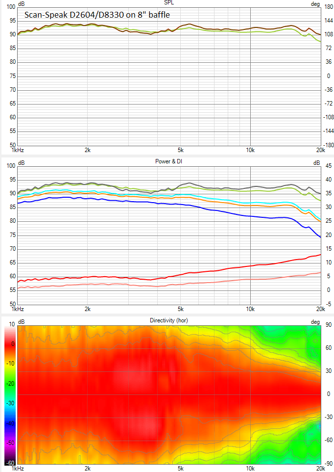

Apologies.
Math 101- charts should have labels. I hope to update them later. In the meantime, here's a great little primer:
https://www.spinorama.org/help.html
According Dibirama third party measurements, the 83000 (standalone magnet) should be quieter (THD) in the low end than the 833000 (double magnet). Also cleaner there.
@tktran303 : do you have not a little bump due to the room or the mic around 5 k hz ? I seem to see a patern there with the two different drivers measured ?
@duvixan : too much energy in the 5k to 8k can make some brigthness according the final power response of the loudspeaker (the curve into the room), hifi gears you have, personal taste, hence my question to tktran. For instance if you had a too much straigth spl curve with a bump there of 1dB or more, some may notice a fatiguing sound while others according what is said above, the damping of the room, its size, etc...

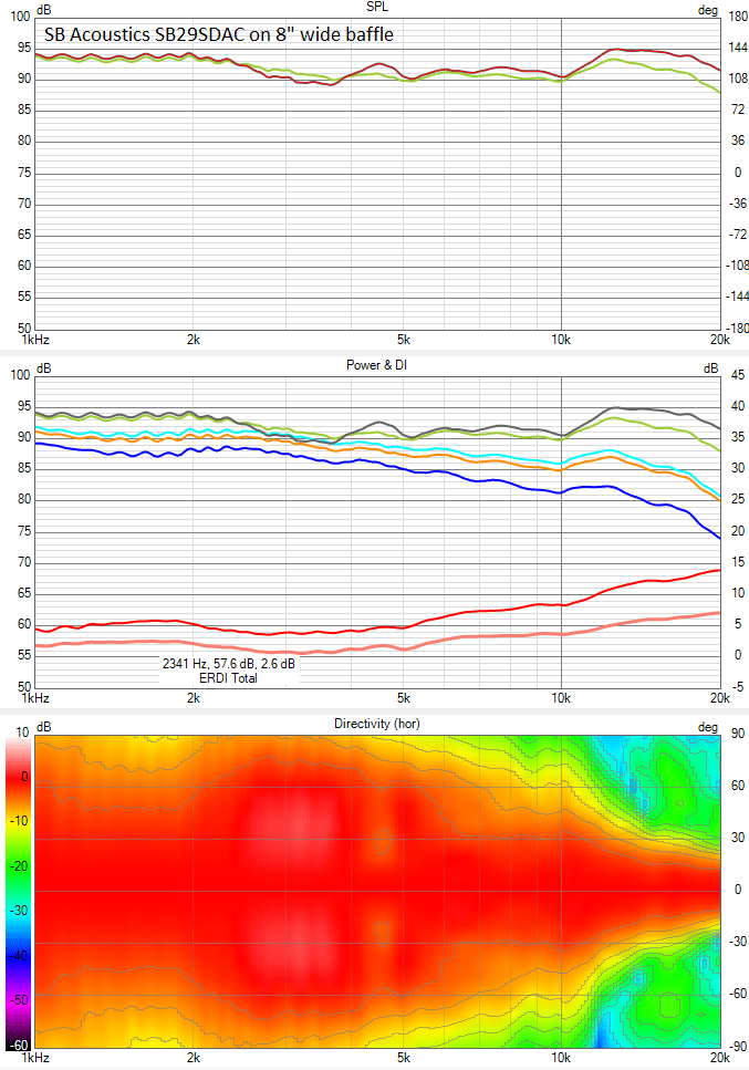

wolf_teeth, it's with the 29SDAC in this brandon WG (teaser)
As a beginner I see the same patern than with the sb26STAC, that bump before 20k I dunno how people do to eq this passive ! This bump being later with the 26 ADC/CAC (cdc) makes me think it is the one I would choose. But just you guys than listen them all knew for the sound in real life.
I don't think you're supposed to eq the last octave or that it's audible.
It just adds a little bit of extra sparkle at the very top, not a real issue.
I do think the 10K to 15K to be important enough to take care. I don't mind the half last octave though. But the big break-ups of some metal cones at the end can be heard back if too much high in spl and near the 20K to 25k hz.

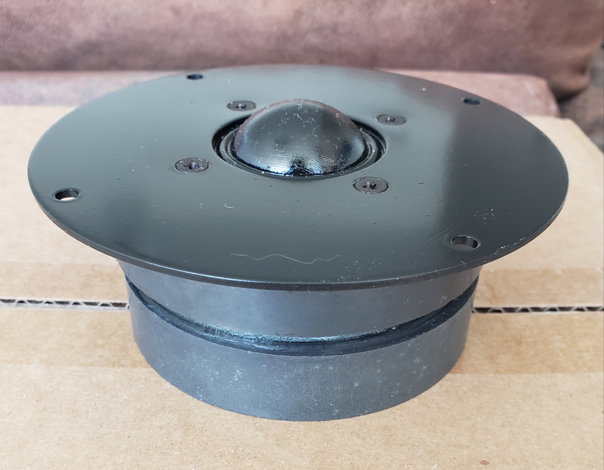

Also, the TW034 will easily go down to 1.5k in a WG. If you're adventurous enough to drill the pole pieces and stack an extra magnet on them, you end up with a 95 dB/2.83V efficiency driver that gets very close to the Seas T35C002, but at 1/3 the cost.

The extra magnet bumped efficiency by 1 dB which indicated the VC gap wasn't that saturated. The DA32TX also benefits from an extra magnet, but not as much as the TW034. I'll post measurments of the difference when I can.
The DA32TX and TW034 are the same 132mm faceplate diameter and interchangeable, but the bolt pattern diameter is 116mm on the DA32TX and 120mm on the TW034, so you need to rotate and drill new holes.
The two sound very similar in the mids but the TW034 has a more lively top end, likely due to partial breakup. Its not a noticeably bad thing but the DA32TX is more accurate higher up and therfore can come across as boring. I like both of them for different reasons.
For acoustic music and jazz I prefer the Audax. For louder listening I like the Peerless more as it has a cleaner presentation, especially with percussion and electronic instruments. Pop and rock sound really good with it and it can play louder overall without any strain. The Audax tends to get a bit fuzzy when it's pushed hard. Mind you I'm talking about 105+ dB level which is asking alot from a 2 way with low crossover point.
