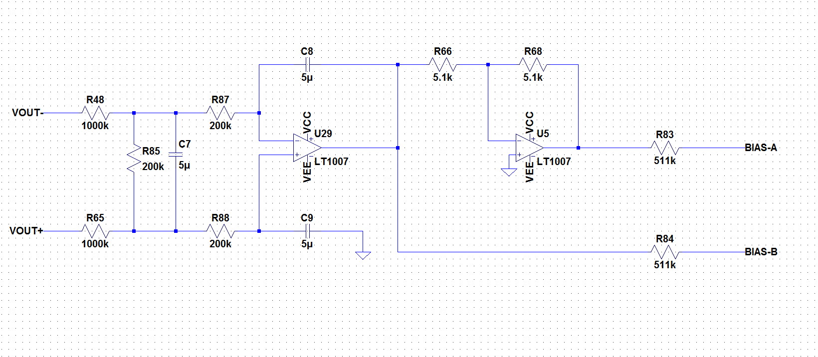

I've got a few tweaks I'm going to add in the coming weeks, one is a dc servo to automatically zero out the dc offset at the output. My dc coupling mod probably makes dc stability more of an issue in my amp, so you probably won't have any problem if you go ac coupled. I tweaked the amp's balance pot after about 2 hours of run time for zero volts, but for the first twenty minutes or so the offset is fairly high, around 900mV, before it settles in. It's not sonically obvious, but I don't want it there. Also, it doesn't always settle in the same way each time I run it, probably because the tubes are aging differently. I'll keep you posted on my progress.

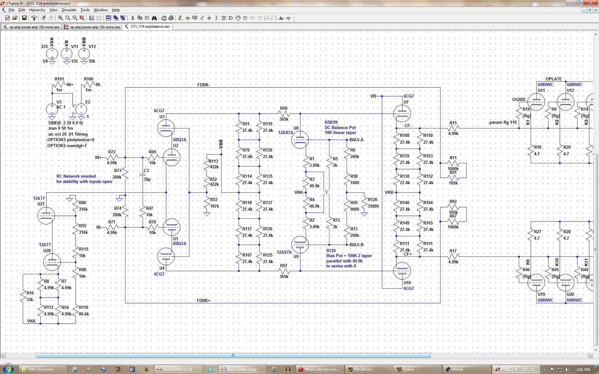

This is a screen capture of the driver part of the dc-coupled OTL schematic. I hope it's clear.
A few notes: The resistor values were selected to make use of my stash of RN60 metal film resistors, so if the values look funky, that's why. You'll see that I series-paralleled resistors in a few locations for voltage and power de-rating purposes, instead of buying new high-wattage resistors. Also, the feedback resistors are shown disconnected from the output rails.
The nets labeled BIAS-A and BIAS-B are for future connection to the dc balancing servo (not shown yet until I prove it to work).

Oh, R58 and R59, the dc balance pot, are unmatched here because I was testing the servo loop's range. I should have edited the values back to nominal 5k and 5k.
Another note: Lots of resistor values in the posted schematic are specific to the power supply rails I used for my specific version of this amplifier; these were dependent on the transformers I had available so don't treat them as gospel. When you implement/simulate your own design, these will very definitely need to change. Also, as noted previously, I limited the resistor values used in my implementation to those I had in my personal stockpile, not the entire gamut of E96 values available.
I attempted to do a rigorous analysis of the CCS last year, and was partially successful...to the best of my limited ability, the impedance of the CCS is roughly mu*Rk, within a factor of 2. It's been a long, long time since I did circuit analysis in university and my "skilz" have blunted with the passage of time (ah, well...)
A heuristic, or less charitably a hand-waving, "truthy" explanation, of how the CCS works goes as follows:
When the signal at U3-P increases by dV, the signal at U4-P decreases by the same amount (in the linear region of operation), and the current in U8 would increase (U9 decrease) accordingly.
The voltage at the cathodes of U8/U9 also increase/decrease, but since the grids of U8/U9 are cross-connected to the cathodes of U9/U8, the grid to cathode voltages will decrease/increase, causing the plate currents in U8/U9 will be forced to decrease/increase, thereby maintaining constant plate current, and hence constant voltage drop across R50/R57.
Caveat: This behavior only holds true at dc AND if the plate voltage swings at U3/U4 are equal and opposite. At high frequencies, due to parasitic and inter-electrode capacitances and stray inductance, this condition will not be met. At high ac voltage swings, the balance requirement will not be satisfied.
I've found by simulation and measurement that the CCS operates satisfactorily up to at least 50 kHz and up to amplitudes where the output tube nonlinearities (especially when driven towards cutoff) swamp the driver "non-ideality".
If you simulate the circuit, you'll want to monitor the voltage drop across R50 and R57 and the currents in those branches at full signal power. I was satisfied that the CCS compliance was good enough to maintain essentially no ac signal loss from the cascode plate to the cathode follower grid.
Alternatives to his approach that I considered were:
a) gas tubes or zener diodes in place of R50 and R57 (noisy, not in stock - rejected)
b) pentode CCS instead of triode (too many envelopes needed, partition noise, screen current characteristics too unpredictable/not amenable to simulation in Spice - rejected)
c) resistive divider (required too high a value of Vkk for acceptable ac signal loss - rejected)
d) solid state CCS (didn't want any sand in the signal path, POE - Rejected)
It's times like these that I wish they made P-type vacuum tubes!!!
Balancing and setting the bias point for the output tubes is accomplished by unbalancing the grid networks of U8/U9 and increasing/decreasing the resistance from the grids to ground.
This method also allows one to use external servos to control dc offset and bias potentially, if the grid resistors are scaled so that conventional +/-15 volt op amp output swings near the ground node cause the necessary current plate changes in U8/U9. I'm almost there and will report back in later when I'm successful at this.

You may have noticed that I am using resistive voltage dividers instead of zener diodes to set the operating points of the cascode stage and its constant current source. This is because I am using shunt regulated power supplies for the amplifier driver circuit (but not the output stage) and so zeners weren't necessary.
There are two 4.99k resistors (R15/R17) between the cathode follower and the output stage grids. These were added when I noticed a rising open loop frequency response caused by the cathode follower's output impedance (which is slightly inductive at high frequencies due to Cgk) resonating with the input capacitance of the output tubes.
There is an RC network (C3/R47) between the input stage grids. When global negative feedback is used, and the inputs are open, the loop gain of the amplifier is too high at high frequencies and phase shifts (due to tube capacitances) cause oscillation/instability. The RC network decreases loop gain at high frequencies. It has no significant effect inside the audio frequency band.

Excellent work!
You might consider also installing RFI filters in the feedback loop to prevent RF from entering the circuit through the speaker cables.
Here's something to think about when implementing the servo. When one half of the output section is above 0 volts, the other half will be below 0 volts. So your servo really only needs to address one half of the driver circuit- the other side can be set to a fixed/reference voltage and the other half will follow; DC Offset will be controlled. This means you really only need one opamp to do the DC servo. I recommend that it be highly integrated initially, and then the output filtered so that any subsonic information is many db down in the output of the servo; regardless of signal condition the servo output should be a straight line on your oscilloscope.
The reason we have not implemented a servo on most of our amps has to do with tube condition (we have used a servo for many years in our preamps). If a tube is somehow damaged its nice to know that- DC Offset, readily seen on a VU meter, is one indication that a tube may have gone south. A fuse blowing might be another 🙂 Our MA-3 does have a DC servo and it also has a number of meters to show the amplifier condition- one of the meters is for the on-board tube tester.
You could use the other half of a dual opamp IC to indicate an uncontrollable DC Offset.
A simple implementation of the servo is simply to have the opamp measure the output voltage of the amplifier directly, and then hang a zener string to the control input on your CCS. This method is quite effective and relatively simple.

I've already wired up a couple of servo boards, sensing the delta across the output terminals, and feeding a correction voltage back to the driver in a differential fashion. Your tip to eliminate one opamp is noted, if it turns out that it doesn't perform as imagined then I'll try your method.
I came up with the simple method shown in the attached figure, time constants tbd but around 1 second (which can be increased if needed).
I'll be installing the servo next week...keep tuned for progress reports.
