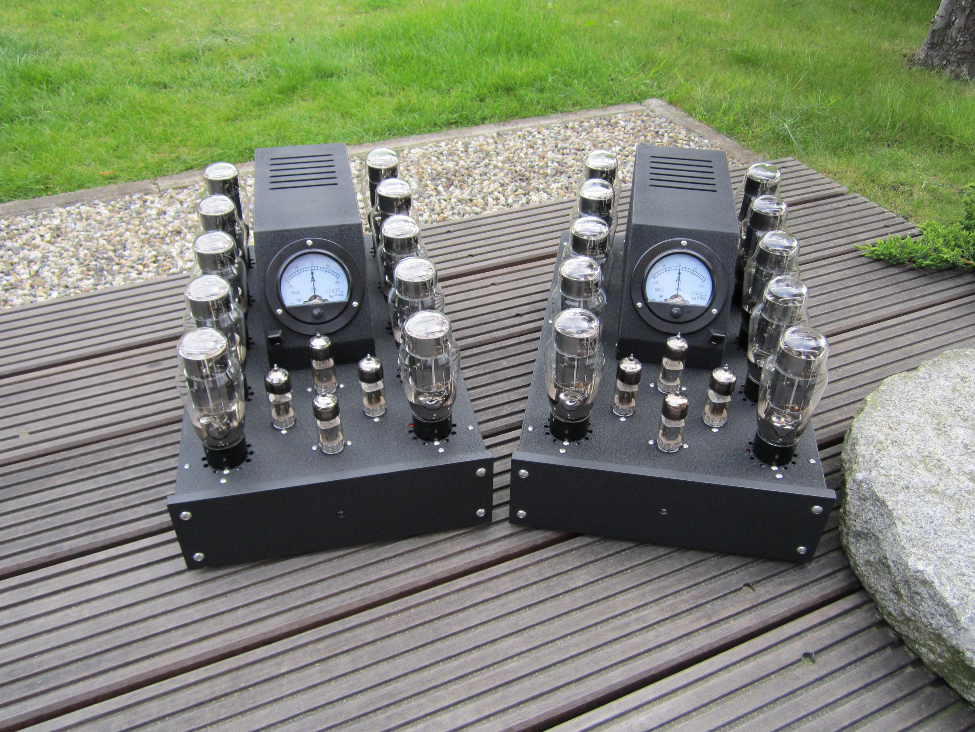

My project is fine, I'm running the amp's for a month or two now and all is ok.
I only have to tweek to my taste.
And get rid of a little hum in the background.
So far so good

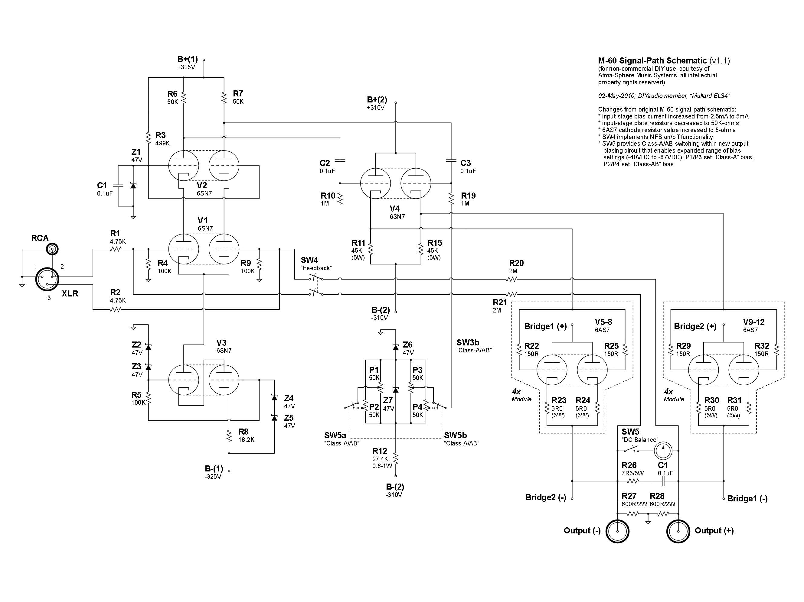

Driver V4 Voltage
In the final MullardEL34 schematic, post 247 and attached, the effective Vpp voltage across the driver 6SN7 V4 is 620V. If the grid bias voltage on the final 6AS7s is in the range of -65V to -75V for Class A (say -70V), as delivered at the cathodes of V4, then the net voltage across V4 is about 380V. Seems awfully high as the 6SN7 spec sheet says 300V max. What am I missing?

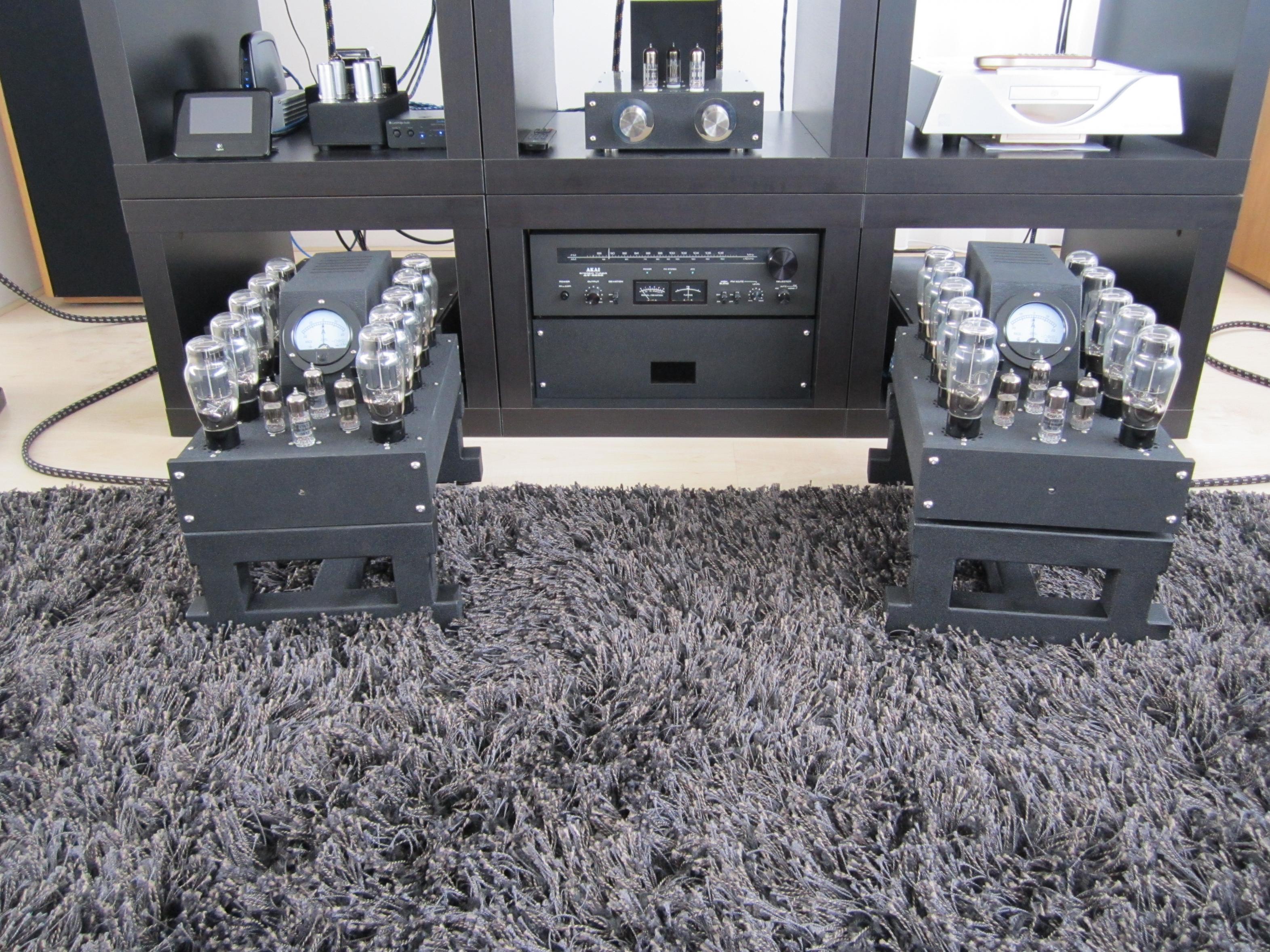

As you can see in my avatar, I have them up and running for a while now, and i'm very satisfied, I have only a very small hum in the background, but that's because I do not have a balanced preamplifier.
