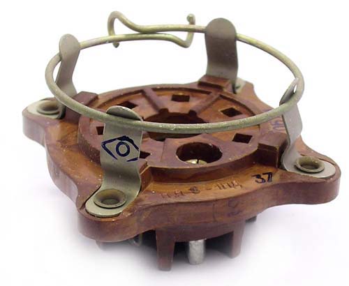

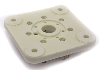

Here is some picture and useful link for you,picture is related to two original Russian 6c33c-b socket,first is normal ceramic socket(not bad) and second is original brown tube socket with integrated tube holder,this brown one is better one and cheaper to(9$),both socket type is available from- RU Tubes.com-
Second link is from JacMusic.com and have some very useful information related to 6c33c socket contacts wiring method.
