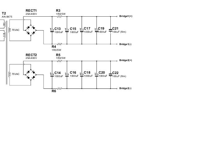

Anyway got a question regarding the floating power supplies.
How many amps do they need to deliver (B-/B+)?
I can buy a lot of 5 trannies for just 35 USD.
220/28V @ 3 amps.
Thinking I can either use voltage doublers to increase 112 @ 750ma no?
Or put 2 in parallel and voltage double twice to 112 v but keeping the current higher at 1.5amps.
Is this maths correct?
I can also use one of the to power 4 x 6080 heaters in series.

I don't see where you are getting the 112V from, but if you can do 112VAC @1.5 amps that will be a bit of overkill for 4 6AS7s, but it will work fine.
sorry I meant the floating supplies as shown below.
How many amps do these require?
112 could be gotten from 2 28v in series with a voltage doubler maybe.

These 220/28v trannies I could buy. @ 3 amps.
If I use 2, and connect the secondaries of both in series I will have 56 volts @ 6amps no? Can I connect the secondaries of both in series?
So then I could use a voltage doubler for 112 V @ 3 amps.
4 a 6080s at 85mA for example.
85mA x 8 (8 cathodes)= 680 mA in total. Plenty of headroom.
This looks great to me.
Perhaps buying a couple of 6SN7s is worth considering
I have a set in UK at my fathers house. I'll get him to send them over.
No. Double the voltage, halve the current (or overstress your transformers), you can't have both.
Why 112V anyway ? Hook two transformers back to back with their secondaries together and you get isolated 230V AC which will rectify and filter into nice 300V DC, perfect for tube projects. Hang the heater chain between the two transformers.

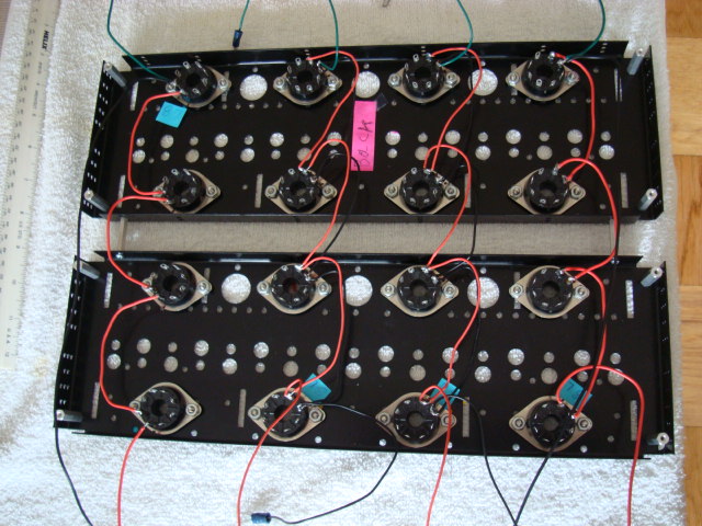

Here is the start of my M60 OTL. Here you can see the Heater wiring in place.

I started work on this OTL. It is not easy. Its a lot of work to wire point to point. And there a lot connections to solder.
ha! - nice to hear I'm not the only one who feels this way. I've only built one tube amp so far, but the simplicity of the schematic didn't translate into less work for the construction. Lots of chasis work followed by lots of point-to-point soldering. In the end I had to rewire the whole thing to be satisfied with it.
On the rectifiers - I've never built an OTL so I'm kind of guessing here, by my gut feeling on this item is to stick with SS. Your power supplies are not choke loaded, and the current has to be sufficient to drive the load so you have big capacitors to charge up - with high current charging spikes demanded from the rectifiers. In fact I'd be looking to make the power supply a CRCRC to alleviate this somewhat.
