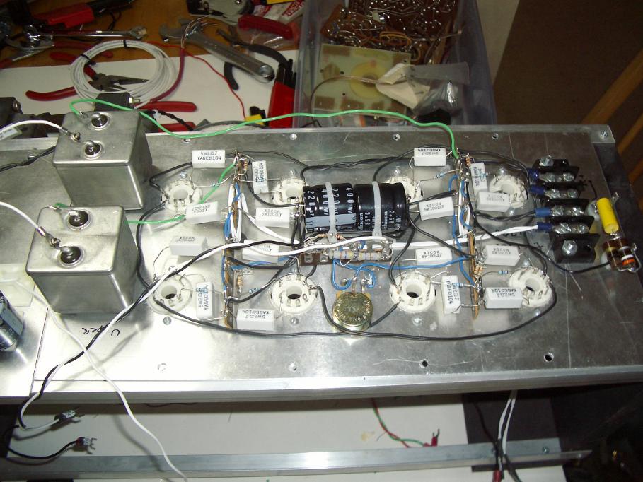

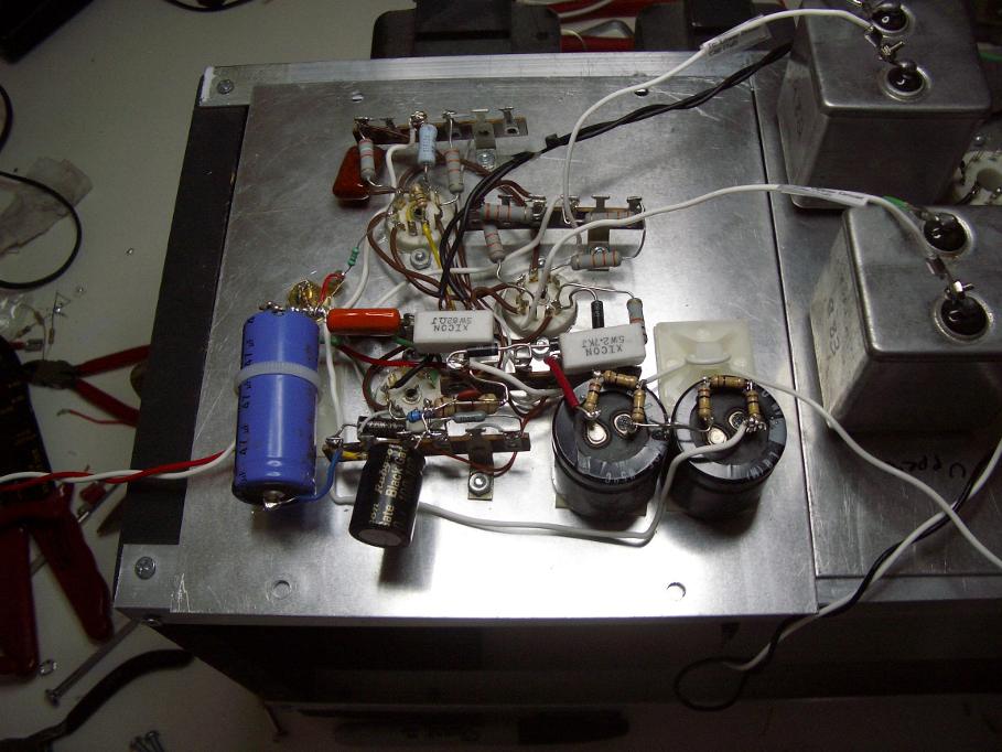

Finished an OTL and now thinking tube substitution
This thread got me inspired to finished my OTL project that I started 8 years ago and 7 house moves later. Its a Transcendent T8 OTL schematics that Bruce Rozenblit published in his book. The amp sound very similar to a Futterman H3aa I used to have ...but has a much better bass.
I gotta give Ralph OTL circuit a try in the near future... The circuit looks so elegant and sublime.
My question is what Tube substitution that may work:
The Russian EL509 are getting expensive and out of 19 tube I got from ebay 3 were bad.
The measurement for my tube tester shows the actual spec are not really that tight.
I'm thinking about using 6C41C ... They are not as expensive, no top cap and looks cool.
The EL509 are configure as a Triode ...Plate is 170v Bias -40v
I'm thinking ... just change the bias -70v. Max plate dissipation is 35watt for the EL509 and 30watt for the 6C41C.
Any comments of the 6C41C in term of tube consistency, ruggedness and sound quality ?
Any tips ...like Preheat the heater for a few day
Any other sweep tube that are plentyful ? I see alot 6P42S on ebay
I've tried the 6C33C ... but found the bias wandered a bit and ran scary hot.
Thanks in advance

The 6C41 should work fine if you have enough of them! You should be able to use it in the schematics shown in this thread, with only minor changes in the bias to accommodate the tube. It seems to have a lower Rp than the 6C33 so IMO it is better suited than the 6C33, although you will have to use more of them. I'm thinking 6 of them should make about 60 watts, but unlike the 6C33, the socket will hold up for decades.
