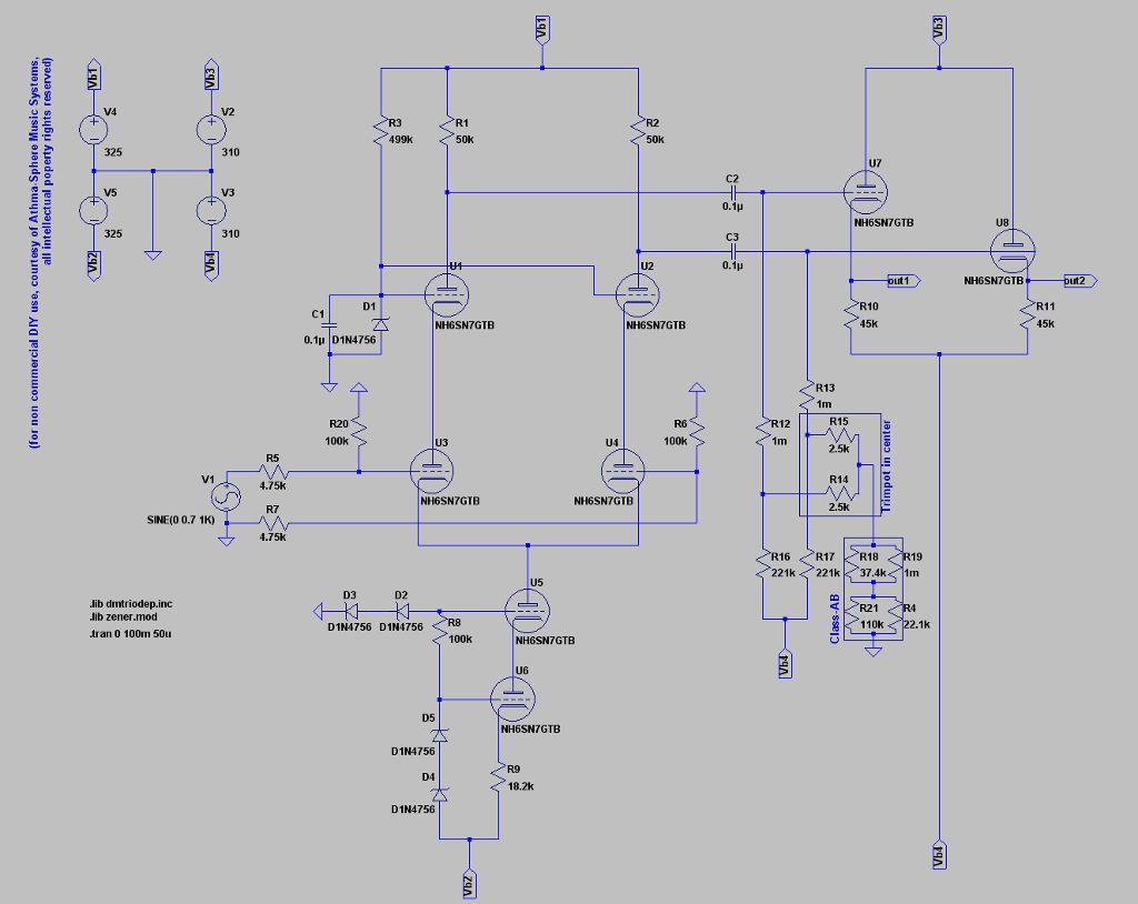

as promised, here the ltspice schematics, this is only the driver stage...
but it still doesn't working right (i guess)... the voltage swing is very low on the output.
Where i'm wrong ?
Where i'm wrong ?

anyway, i still unable to run the spice simulation of the driver right. Can you checks my work ?
Can you post the schematic you are using?

The schematic is OK. Either your not putting B+ and B- to it (they have to be equal but opposite 300V) or something is wrong with your models or the like in Spice. You should be able to get about 200V swing at the output of the CF.mhhh, no, is so like i have don't hit the attach button 😀
i'm supplying voltage trought vb1/vb2/vb3/vb4, where vb1/vb2 are +/- 325v and vb3/vb4 are +/- 310v
i've checked on the point where i put the voltage and there are ok..
tha anode of the upper 6sn7 (U1) is at 190v, the tube that take the signal-in (U3) is at 52v and the lower one, the CCS, (U5) at 0.8v.
i think the model is ok...
What is on the anode of V4? It should be about 260V.
