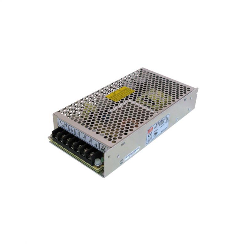

I am watching this with interest as I am 70% through a Rosenblit build and for output tube filament supplies picked up one of these to play with from All electronics. It is adjustable by a couple of volts either way, to get the exact voltage depending on if I have 8, 12 or 16 tubes plugged in, and is smaller and lighter. I figured it would be generally useful somewhere even if I eventually replace it with real iron. Will this thing radiate noise or cause any other nasty effects? Or should I be shopping for transformers?
Dave
“Mean Well #RS-150-24. Input: 100-240Vac. Output: 24Vdc 6.5A. 150W switching power supply. Enclosed vented metal case, 197 x 98 x 38mm. Cooled by free air convection. Short circuit/ overload / over-voltage protection. Adjustable output voltage. Led output indicator. Individually boxed. UL, CSE, TUV, CE.”
