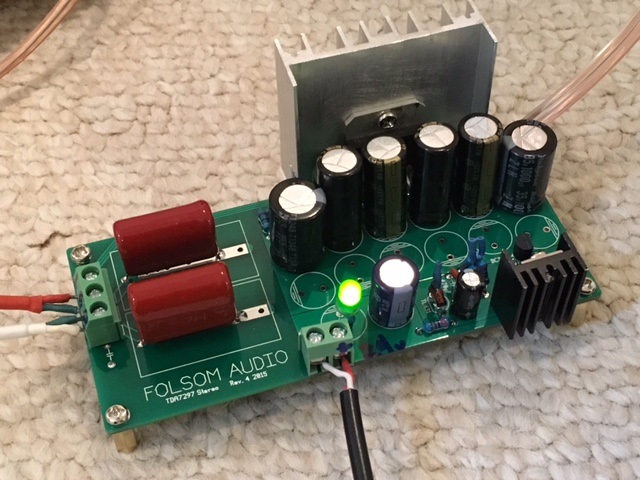

I just built up Destroyer OS' TDA7297 amp with some mods due to parts on hand. I am using four Panasonic FM 560uF 35v caps (measured 35mOhm ESR) and two Rubycon 1000uF 35v caps on the power rail. The TL431 shunt regulator is on order and in its place are two 9.1v zeners (measured as 18.45v across both) serving as the reference for the shunt regulator circuit that employs a BC337 and a TIP42 shunt transistor (substituted for the spec'd DH4511). The regulated output is 17.85v fed with a 24v 5amp SMPS brick. Shunt transistor is not too warm and working well. Main amp heatsink is stock unit from $5 Lunch Money amp so is rather undersized and toasty hot (8 seconds touch test). The TDA7298 itself was also donated from my lunch money amp. Desoldering all those pins was tricky 🙂
The input caps 2.2uF 450v MKT's from CBB with 100nF 100v bypass film caps (underneath board).
I put screw terminal blocks on all connections for ease of use as temporary amp. I am listening to it with GR Research XL-S speakers right now and have to say that they sound excellent. Very nice mid range and clear top end. Bass is quite good with clean snap and tight articulation. I have to listen more to see how it compares to my discrete transistor class AB amps like FX8 or FH9. Silent when no signal present, no hiss, no hum. I think the SMPS might be a keeper on this setup. Not sure if a trafo and cap bank with matched Folsom "Antipole" PSU with CMC choke is necessary.

I did make a few mods as described above due to circumstance, and it may sound even better with the TL431? But as you can see, in a pinch a couple of Zeners is not a bad thing to use as a reference in a shunt regulator. The TIP42 is also much more common and probably already in everyone's kit. The BC337 was included with my board so I almost went searching for an equivalent. I would have used 2N5401 if I did not have the BC337 on hand. Also, the 560uF 35V Panasonic FM's measure almost as good as the SEPF OSCONs from an ESR standpoint (especially if you have many in parallel) and they save quite a bit of $.

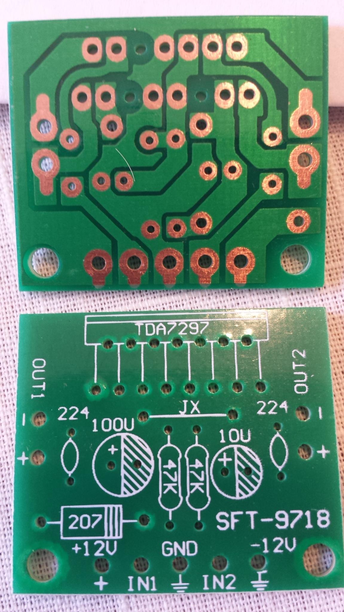

So for whatever reason there's no sound coming out of that PCB that I had made. I tried consulting the designer and he guided me thru to troubleshoot it. Still no avail. First time I tried firing it up, the LED is not even lit up. I tried reversing the legs and it came to life. But there's no sound. I removed the 3.5mm socket, and tried touching the input cap pin with a screwdriver, and there is a noise coming out of the speaker. He suggested maybe the chip is dead, so I tried switching the chip with a stock lunch amp that I have. Still no sound out of the custom board, but the lunch amp is working just fine.

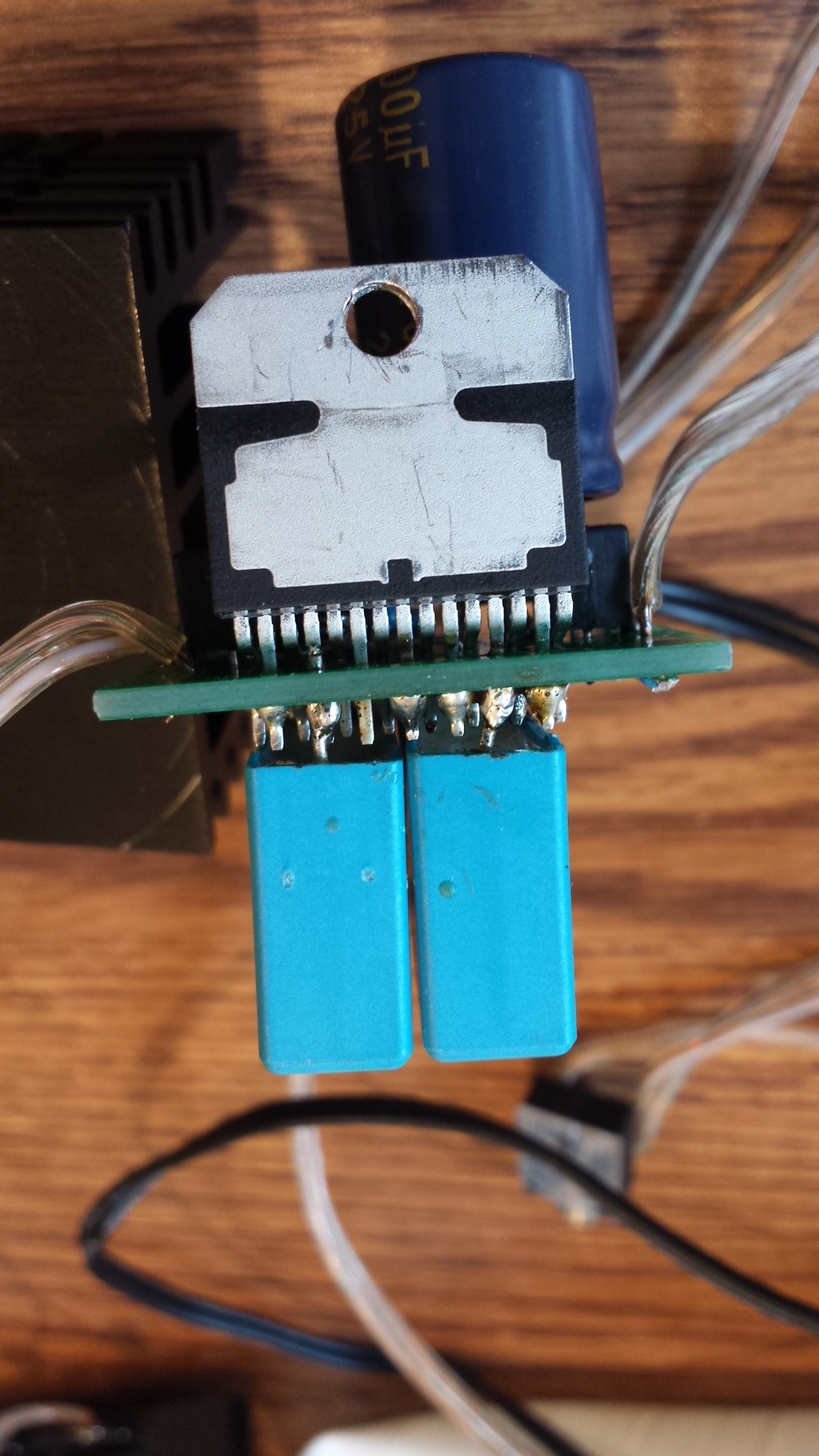

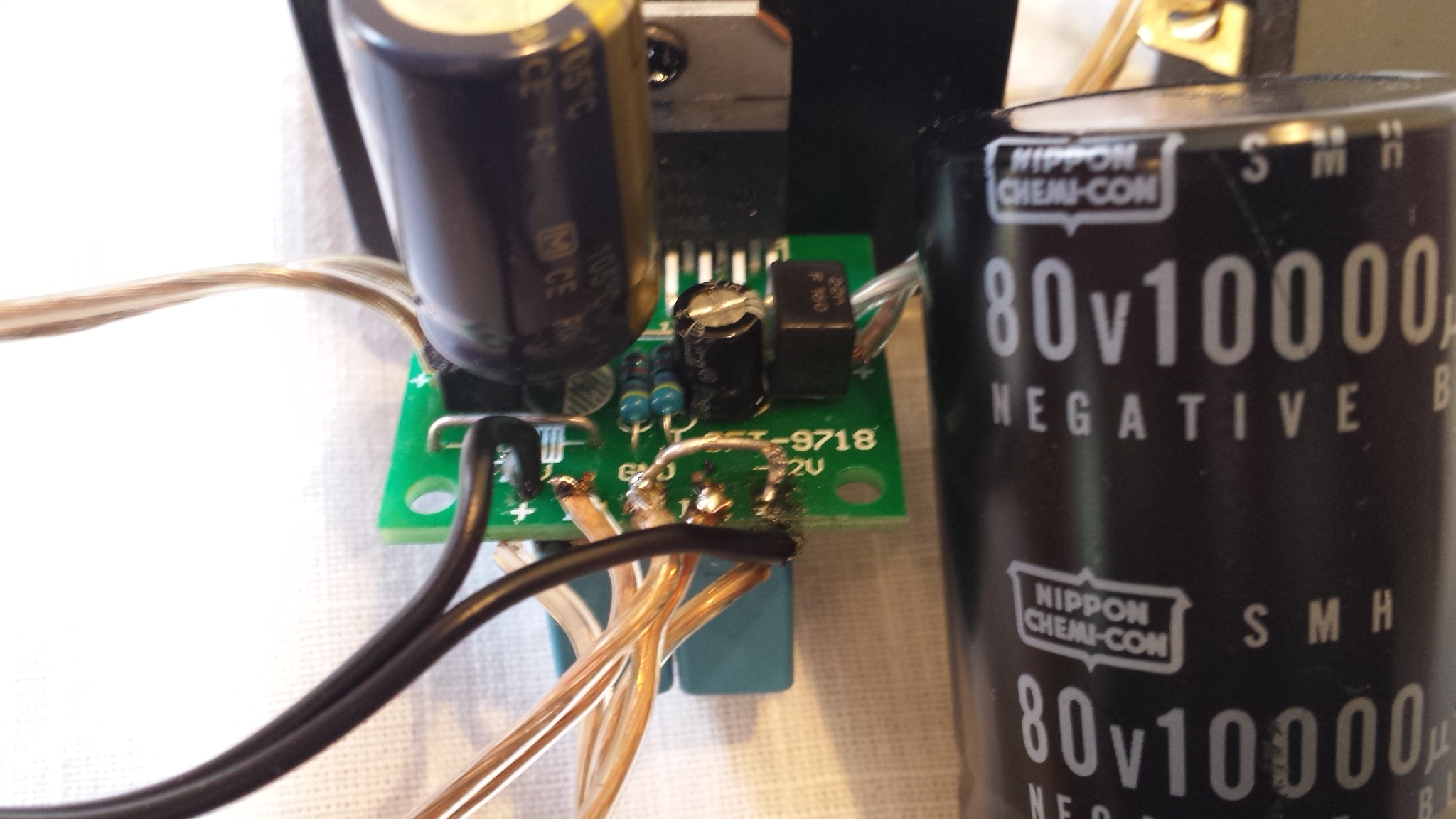

I wanted to hear some music out of this chip, so I just played some more with the lunch amp. Removed the ceramic cap, bypassed the diode, removed the terminal block and soldered wires directly. I also installed insulator on the chip.
I have a better 1.5uF MKP that I put on the custom board, so this cheapie 1uF gets a new home. The 1.5uF is JFX brand, rated at 5% and they do measure within tolerance. These yellow ones though, measured around 0.85 and 0.78.
The amp sounds fuller with these simple mods, but very noisy and very bad turn on noise. I don't have a 100uF cap but do have 47uF, and it immediately brings both kinds of noise down. Would 100uF brings floor noise down as well? If so, I'll definitely replace that.
Volume pot, the stock one is aluminium coated plastic, and gives noise when touched, so I replaced it with plastic Jazz Bass style knob, and it works well in that regard. Last touch is the LED, the stock blue is way too bright, this new white is softer and looks nicer. I'm happy for now.
You probably need to connect the signal and power grounds on your new board to get it to turn on.

Does that mean putting jumper wire from signal ground to power ground? If I take some pictures would you kindly tell me what to do? Sorry I have some ideas how to do this but since I have no solid background in EE I may ruin everything with on mistake. Might as well ask for detailed instructions. Thanks so much for your assistance!😉😉
