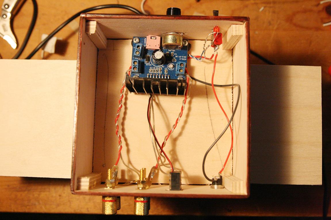

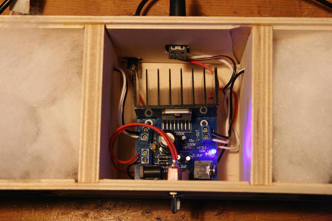

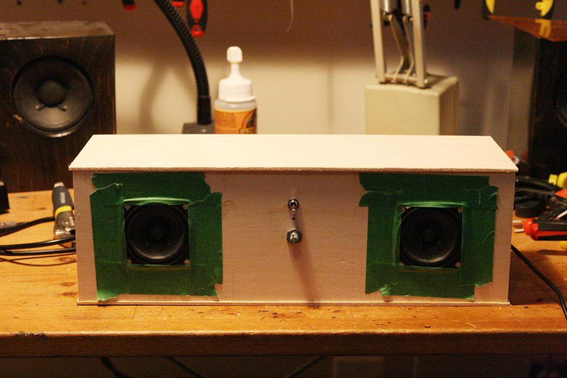

Please excuse the crumby photos.
Here are 2 examples of the little stereos that I’m making with these lunch box amps. Could you knowledgable guys advise me if I am not running the wires properly or how to make it better. I have not properly twisted the wires on the unfinished one. I am always concerned about grounding in wooden boxes.
Thanks!
Thanks!
Wooden enclosures
I put all my amps in wooden enclosures and never have any sort of noise/grounding problems.
I'm certainly no expert, but your wiring looks fine to me. My wiring is much "looser" shall we say? A lot less neat. No problems. The amps seem fairly forgiving in that respect.
MW
MW
