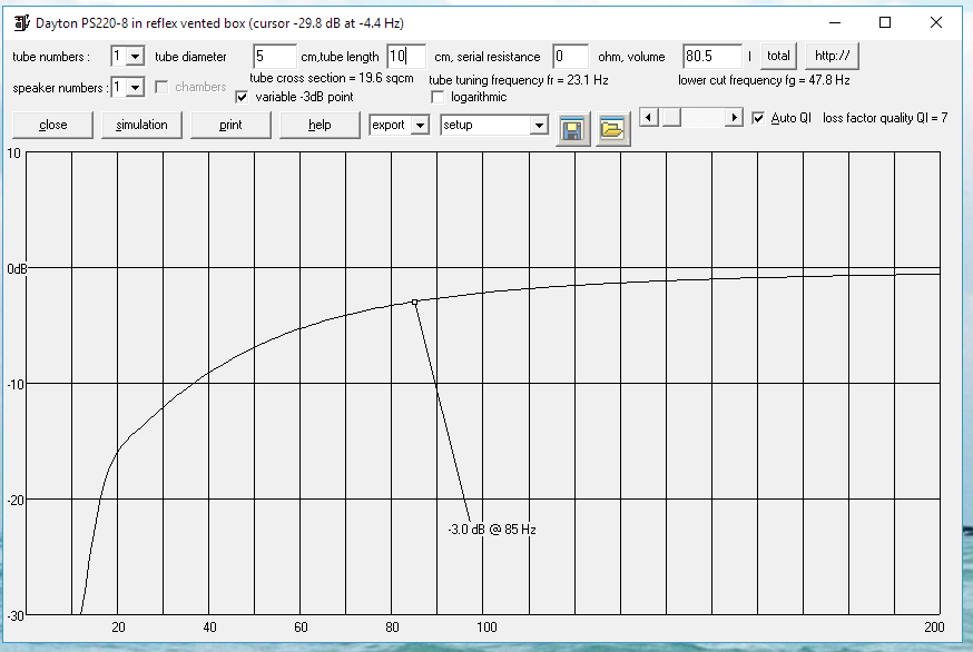

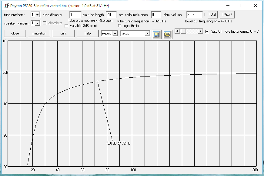

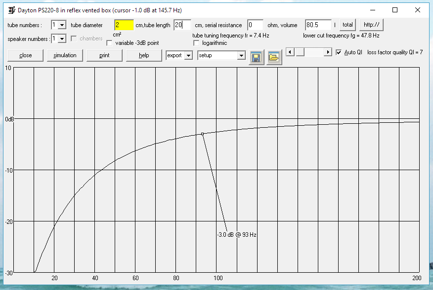

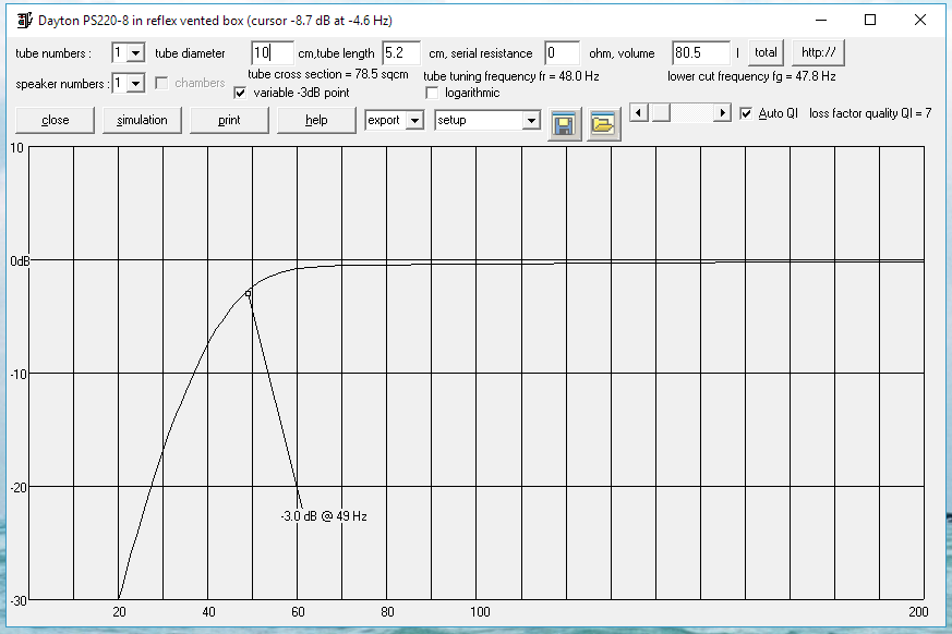

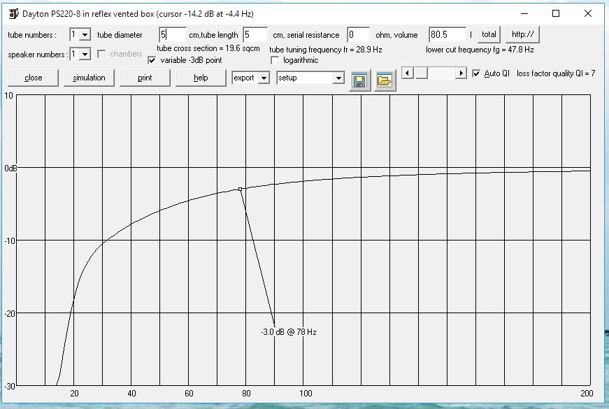

Hereafter the first numer represents the tube diameter, the second number the tube length.
10 - 5.2 the default advised by the program specifically for the Dayton Audio PS229-8
(Notice the resistance in series was default chosen by the porogramm to be 0. Is that correct?)
In addition to the default, I'm adding the following variatons:
5 - 5
5 - 10
10 - 20
2 - 20
Just looking at the graphs the 2 - 20 option looks the "smoothest".
Is that what we are looking for? Can this be a cheap PVC tube 2 cm diameter, 20 cm length?

Now on to the contents:
My speaker dimensions will be wider than deep, say 40cm wide face, 20 cm deep
Try to avoid multiples of the same dimension if you can, as they promote internal eigenmodes (standing waves).
...and 100cm tall floorstanding
You may need to use some internal panels / bracing to break up the longitudinal standing wave, or it will alter your box alignment away from what you are expecting.
2cm thick real wood
So long as it's properly selected, tight grain, fully dried & sealed to prevent movement, a decent choice
, for a volume of 80L vented design.
Technically no since even if you have a very low output impedance amplifier (which you imply you have) your speaker wire and connections have some resistance. In most cases it's probably in the order of about 0.5ohms. Near enough though -again, this tends to get swamped by other factors.
[/B]Just looking at the graphs the 2 - 20 option looks the "smoothest".
I don't know quite where the numbers are coming from, but they're a bit of a shotgun. 20mm diameter x just the 20mm thickness of the build material would tune an 80 litre box to about 18Hz. Put it in a crucible, say 80 litres tuned to 42Hz - 45Hz. I'd go with, say, a 50mm diameter duct x 35mm length. That'll tune it to the target region & also keep the vent air velocity low, reducing the potential for noise.

2cm diameter is WAY too small! You'll get compression and chuffing, even at medium levels, that's something you'd absolutely want to avoid.
A very deep tuning can work but often it not a good solution. The port works parasitic, that means, it takes energy 'away' from the membrane and therefore reduces the excursion, the energy is radiated by the port. The problem is, that only works around the port frequency. What limits the dynamics is the excursion further up in the bass and it becomes limited because of two things:
a. The maximum linear excursion.
b. The intermodulation distortion (IMD).
On a BB driver b. is very critical, the driver has to reproduce not only the bass, it has also to play the mid and high range, that will be distorted by the excursion. A less deep tuning reduces the excursion and the usable maximum dynamic is much better. As already mentioned, the very low tuning will reduce the excursion on the very low end but you'll get too much excursion above, in the middle to upper bass. The IMD is likely unbearable before the maximum excursion is reached on the Dayton.
I would suggest you build a test enclosure out of cheap material, OSB or particle board. Take a router and a jigsaw and make a hole for a drain pipe, these are very cheap, you can swap them out or plug 2 into each other to extend them. Listen to it and while the very deep bass might be tempting, you'll notice a less deep bass sounds often a lot crisper and dynamic.
I strongly suggest you don't go below 30Hz tuning frequency, better higher -
at least not with this BB driver.

(aka: how you hink I should enclose these full range speakers, in order to make these sound good)
I've heard speakers from the 70's that were disgarded as junk, which souded so good warm and "vintagy" for my young ears, and for some reason I did not got tired of listening to, while modern precise "correct sounding" speakers gave me a harsh sounding headache after only an hour of listening music to. Of course I love sparking highs and deep subtle notes, but I understand you cant have everything in one box.
So I propose lets end the "personalised" discussions towards eachother now that all is said, and focus to keeping your opinions directed to me sothat i know what variations i actually can choose from in the design. I am not afraid of failing and experimentation. The idea to have a movable back, and able to trying out various port sizes and see how the sound, re-stuff, re-fill, take filling out, or fill some more, all is possible. The maximum volume however is difficult to change. I've decided to keep the maximum volume at 80L. 40cm wide, 20cm deep, 100cm tall. Maybe 110cm tall to compensate for the loss of volume of two? simple horizontal bracings inside the box. I can make another back without holes and put a pillow inside to get a 40L closed floorstanding speaker even. So lets all relax its all flexible project sofar, and i've not started with the sawdust yet 🙂 There are only a thousand options 😉
Nobody is right. Nobody is wrong. Everybody is right and everybody is wrond.
Unless there can be only 1 correct and truly good tasting spaghetti saus ????
Untill then, I invite you each to give your own personal opinion towards me, in a short sweet advise comment of how you would build it if you were me, for this full range driver. Direct it to me please and not to other writers, sothat you can save your valuable time and most of all, come out of the discussion which will bring you (it seems) not further than getting agitated. Which I dont want as original poster because I respect you all guys and dont want you to be agitated because of a nice sounding hobby project like this.
Now, back to the project. The amplifier will be a sony ta-n80es. What I like about this 25kg cube from the 90's (class A+B) is that vocals sound so lush and intimate. I would only feel sad if I would lose the mid range in this fullrange so perhaps we/I have started emphasising the wrong bit: the lows. Lets emphasise the part that matters the most for me: the mids for the vocals, the acoustic instruments. The top highs and top lows matter of course, but lets not get obsessed with those top end points of the spectrum.
My Philips High fidelity International 22RH422 speakers from the 70's will look rubbish if you would make a frequency diagram of them, and solely judgde them from that diagram! Because there is absolutely no base below 200Hz (lol) however, these are one of the best sounding speakers i've heard in terms of that directness of female vocals. Apparently, like my spaghetti the way they served it back in the 70s! Real wood. Not chipboard like these modern days. Natural paper cone speakers. Not kevlar, plastic or aluminium modern materials. But, absolutely zero base in these tiny speakers 🙂 So yeah I understand that even then, like now, all decisions made will compromise something...
Would love to read each of your personal opinions of how you think I should make my spaghetti taste good 🙂
