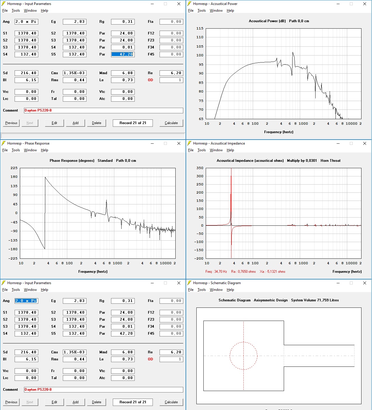

FWIW, while Fullrangeman's post above has a truly remarkable number of technical and historical inaccuracies, I suspect you'd be better off with a vented box, be it Helmholtz or quarter-wave derived. The miniOnken Dave refers to should be very decent. In terms of a more conventional vented box, 70 litres tuned to 42Hz would be quite effective. And here is a decent MLTL as an alternative (they look like a normal vented box but the physics are slightly different) Speaker Design Works
Waauw what a great find thanks Scottmoose! I will investigate in that Speaker Design Works website project, awesome they're using the exact driver as I. But you know I've heard from so many audiophiles that, in the end, a sealed closed box will give a more linear, more subtle and more diverse base response through out various low notes, while a base reflex box will give elevated base for SOME music but is not the audiophile way, they say... And so I'm no impressed by your suggestions to go for the vented solution but what about if I would choose for the 60~70 liter sealed box? how would the frequency graph of the two variants differ in the area between 30 Hz and 500 Hz? Thanks guys!
Note that the braces in that box run the wrong way, you will have better performance if you orient the braces along th evertical axis, bit because they will no longer impede the quarter-wave action and they will better brace the box.
You won't hear me disagreeing; TBH I didn't look too closely at the details although the tuning looks reasonable. I suppose I should do something for the PS220 at some point soon; it's one of those units that I haven't got round to yet.

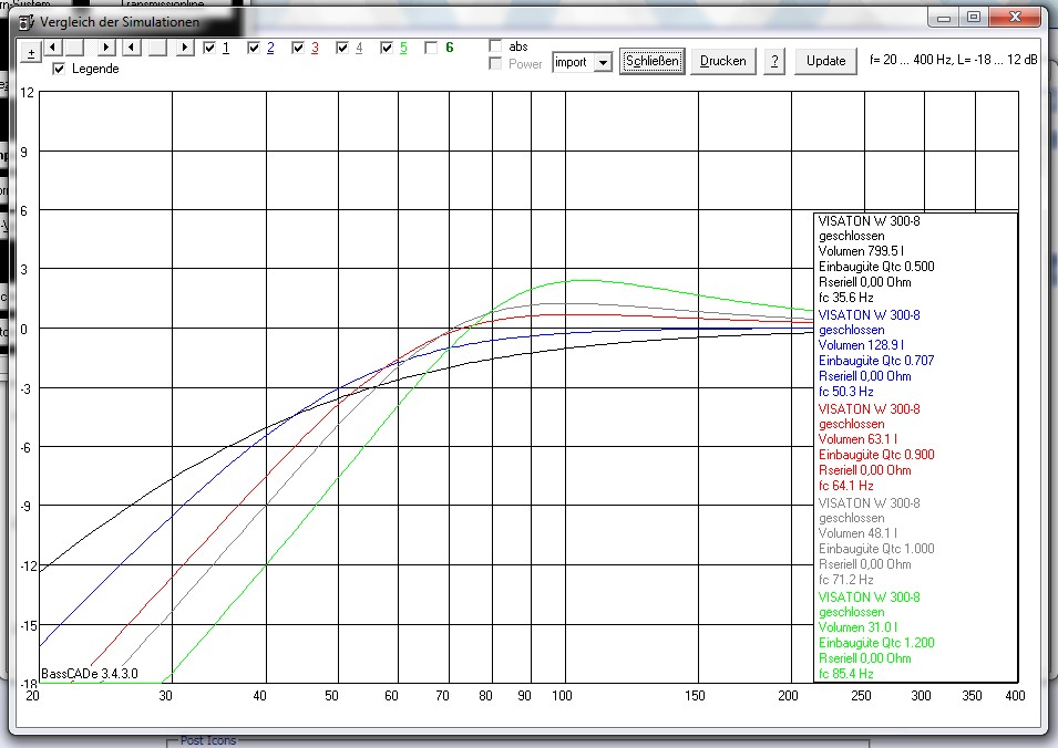

I think I am not understanding this graph. It shows that at Q=1 the base reaches very high dB, while at Q=0.5 the base drops significantly. This is counter intuitive as the larger the speaker volume the deeper the base should extend indeed... Can you explain mate how I should be reading this graph correctly?
The graph only shows the amplitude of the Qt but does not take into account what else changes, namely the fb and the lower cut off slope shift upwards and the time till the speaker returns to standstill after an impulse and the waterfall decay becomes much longer with rising Qt.

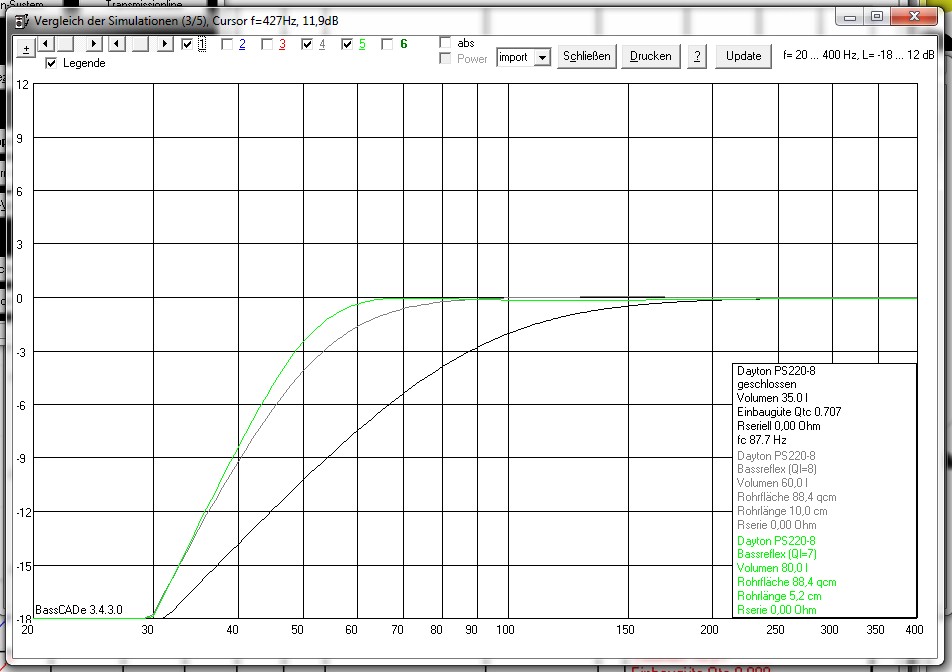

Here a simulation of a real-world driver (12") with different enclosure volumes.
attachment.php

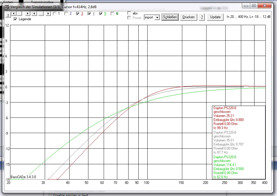

How does this apply to your Dayton? It looks like this:
attachment.php
As you can see, even if you'd add the roomgain, none of it are really satisfying because of the low spl and not very deep cutoff. That means, if you absolutely want a sealed enclosure, you'd have to use a subwoofer.
On the other hand, a ported enclosure looks so much better:
attachment.php
If you want to stay fullrange and bassreflex is an option for you, that's the way to go.

Drivers got different parameters and in some enclosures they work great, in others not so good. Sealed isn't good for every driver. Well, I thought I'll cut the crap, that's why I just posted the simulations. There you can picture yourself what's more versatile, linear and detailed. I mean, if you don't have bass, there can't be details in it, can it? 🙄
Everybody thanks for these new insights! Your suggestions and insights has formed a new understanding on the subject matter and a new valuation of both vented and sealed enclosures, depending on the "many factors" indeed of proper desings.
ICG, your graph is exactly what I was looking for! Great comparison! What programm is that? Is it only in German? How much does this program cost? I would love to play with it and learn more myself playing around with such graphs will allow me to choose for the "best" compromise according to my personal needs and future drivers. If you could personal message me with the saved file I would be very happy.
Your graph is convinving as it compares both "optimal" volumes of the sealed and vented in one gragh, for the frequency responses of this promising driver.
The 80L vented green line looks very nice indeed, I agree with you.
I'm curious how the graph lines would look for a 100 Liters, and 120 Liters vented box.
Sothat I can comapre the vented 80L, 100L, 120L to see how those volumes would theoretically influence the frequency response for this particular modern full range driver.

Does "Röhrflache (qcm)" mean the opening size in squared centimeters?
Does "Röhrlange (cm)" mean the length of the opening in centimeters?
