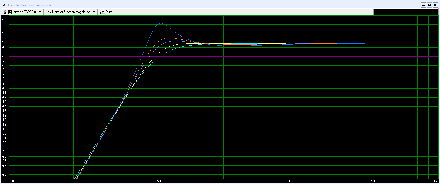

ICG, your graph is exactly what I was looking for! Great comparison! What programm is that? Is it only in German? How much does this program cost? I would love to play with it and learn more myself playing around with such graphs will allow me to choose for the "best" compromise according to my personal needs and future drivers. If you could personal message me with the saved file I would be very happy.
I'm not ICG, but most decent free loudspeaker alignment software will allow you to do the same. WinISD is one of the most popular.
The 80L vented green line looks very nice indeed, I agree with you.
I'm curious how the graph lines would look for a 100 Liters, and 120 Liters vented box.
That nice maximally flat green line will result in 99.9% of real-life conditions in severely underdamped bass (i.e. big peaking, 'boom', 'one-note', all those buzzwords the audiophiles like to throw around) due to boundary / room gain. It's a mathematical derivation only, and assumes anechoic conditions. However, what is flat in an anechoic chamber is not under normal conditions.
Sothat I can comapre the vented 80L, 100L, 120L to see how those volumes would theoretically influence the frequency response for this particular modern full range driver.
Assuming the same tuning frequency and drive unit, the larger the box volume, the more peaking you will have at box tuning (a very bad thing in most cases), with attendent losses in the two octaves (roughly) above that. For example, the attached. This is the PS220-8 in various box volumes, tuned to the same frequency in each.
Turquoise = 70 litres
Yellow = 80 litres
Lilac = 100 litres
Orange = 120 litres
Dark blue = 250 litres for illustration.
Which of these alignments is likely to be the most practical under many (not all) 'real world' conditions? In the majority of cases, it's the 70 litre box. Even this isn't really ideal; it would be better in many situations tuned lower, but as-is, it's a start.

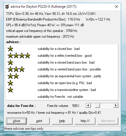

Here's one of the most popular free program used around DIYaudio. It's WinISD.
You can download here:
WinISD - Linearteam
And a nice tutorial here:
WinISD Pro Tutorial and Download (A detailed guide on how to use WinISD Pro) - Home Theater Forum and Systems - HomeTheaterShack.com

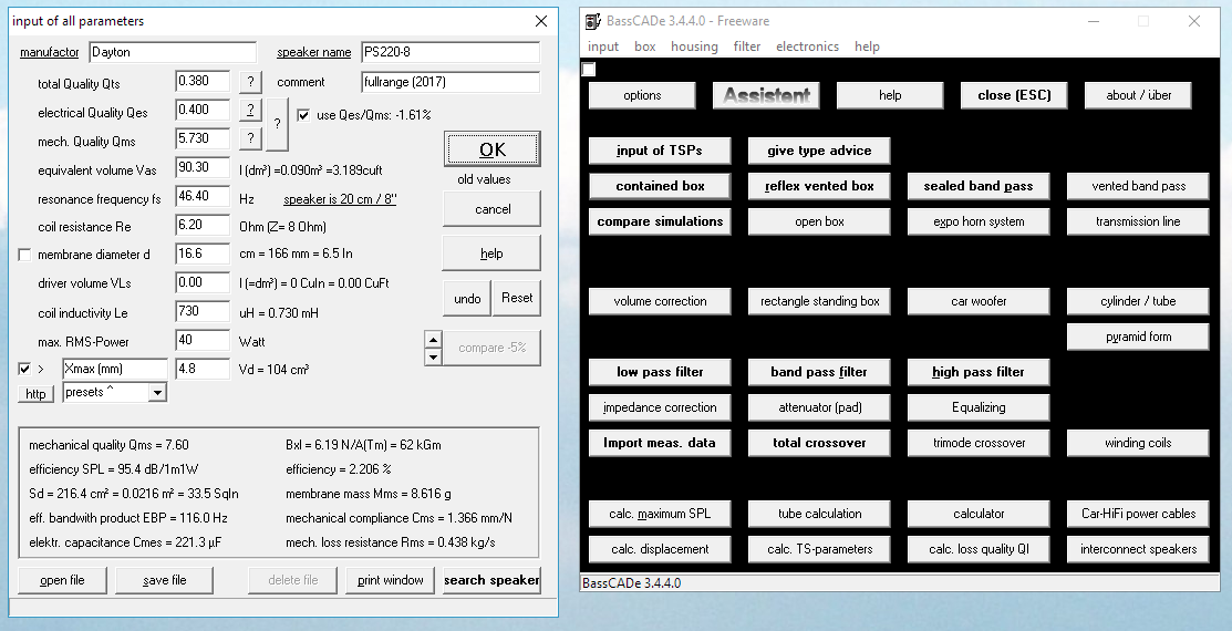

The program is the BassCADe. Default is German but you can switch it to English and there are other languages available I think, at least the program has a switch to others. It's very easy to use, so have fun experimenting with it, you can learn what things are tied together and where you got freedom to tweak things to your taste.

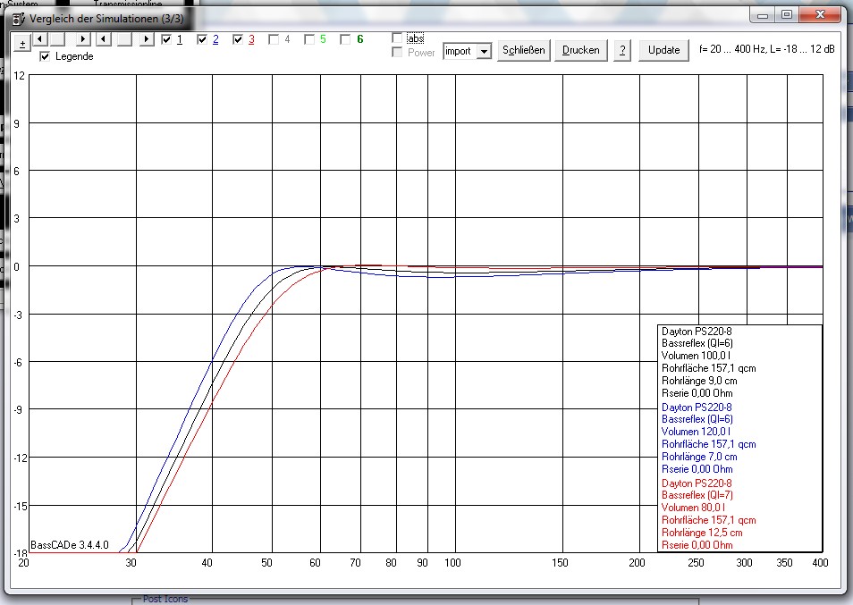

Your graph is convinving as it compares both "optimal" volumes of the sealed and vented in one gragh, for the frequency responses of this promising driver.
That's why I posted it. 😉 I hoped it would show you enough to make yor mind up and I'm glad it did. 🙂

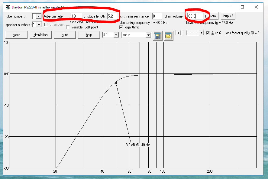

Well, you can not only change the volume, you can also change the port surface and length, which gives you complete freedom about the tuning. For identical tuning but different port sizes you just have to match the tuning frequency.
Here are the comparisons in bigger volumes:
I would use the 80l one. I noticed now the ports are unnecessarily big, you can ofcourse chose smaller ones, the length is shorter then.

Does "Röhrflache (qcm)" mean the opening size in squared centimeters?
Does "Röhrlange (cm)" mean the length of the opening in centimeters?
Yes and yes.

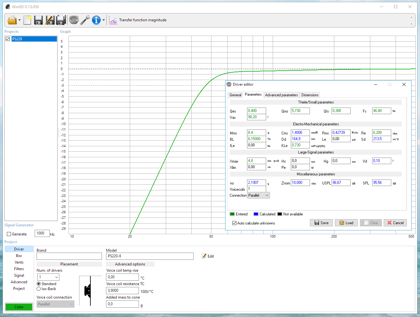

I tried both programs and already have a personal favourite:
Below the first shot is from WinISD, where I put manually all the details because the brand Dayton Audio is not even enlisten let alone this relatively new driver !!!!
BassCADe on the other hand already got all the parameters already perfect from all Dayton Audio speakers and approximately 5.000 other speaker drivers more. Very fresh approach!
In conclusion, if I have understood and played well with parameters and listened to your expert advise, I'm going for:
> Vented enclosure 80 Liters inner volume.
> Vented port 10 cm in diameter, 5 cm long.

Do yourself a favour & tune the box lower, as suggested above. Maximally flat alignments rarely work well in practice & are partly responsible for vented boxes having a questionable reputation in some quarters.
Max flat (Q-0.707) butterworth alignment) needs ~37 litres F10 50 Hz (anechoic). I like bessel (Q=0.58) which requires 68 litre, F10 43 Hz. It starts rolling off sooner, So anywhere from 25-55 litre well damped should do. Room gain will usually get you a bit lower than this, but rooms dominante and its dimensions will typically cause a “roller-coaster” response very much dependent on room placement and listening position.
Note that less volume is needed when damping is considered.
14 litres has a Q of about 1 (underdamped) and a near 2 dB peak at ~150 Hz and F10 not much better than 60 Hz.
