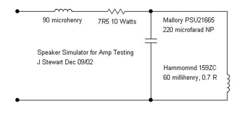

A speaker is like a motor with some parasitic elements. Looking at JHStewart's speaker model:Trying to wrap my head around it.
90 uH of voice coil leakage inductance. 7.5 Ohms of coil resistance. The 220 uF NP is the motor inertia (the elephant in the room ). And 60 mH is probably the air compressibility with 0.7 R the sound radiation resistance. The elephant in the room is the 220 uF with the series 7.5 Ohms. The 220 uF is the motor. V across it is velocity. I into it is acceleration. Changing V instantly would require huge current to accelerate it up to speed (thus changing V across it), but the coil resistance limits the current.
Speaker resonance is from the C (or inertia) and the 60mH (air compressibility).

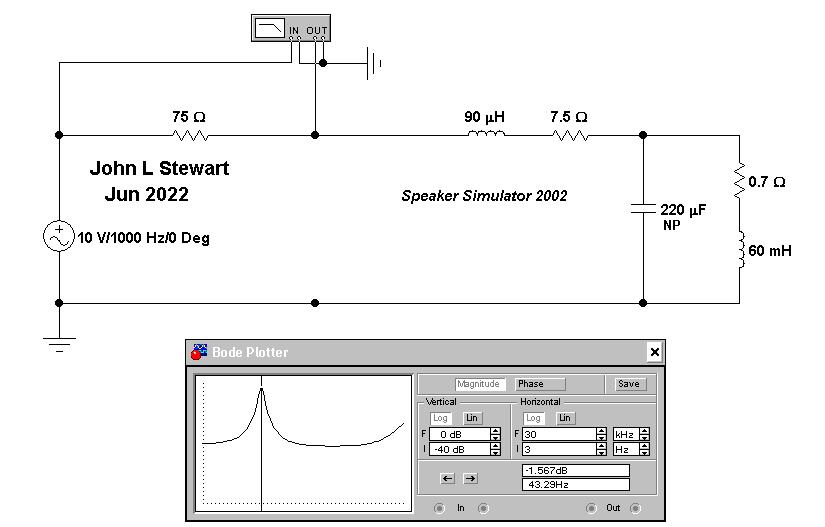

The simulator I pieced together 20 years ago is meant to check amplifiers, not speakers. It works well in that service. The response to an amp having DF a lot less that one is attached. And looks much like a typical pentode output, SE or PP without voltage NFB.

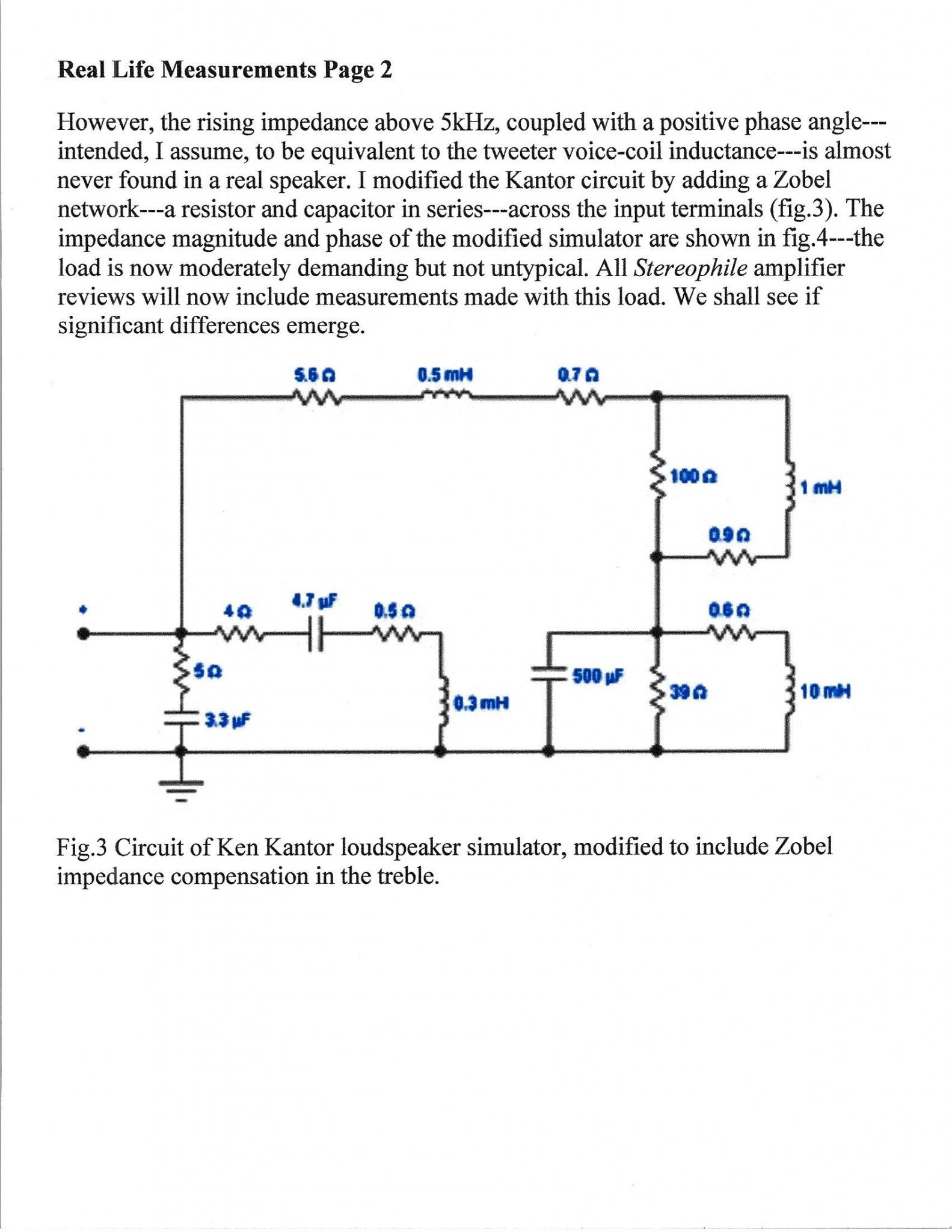

The other attachment is a speaker simulator by Ken Kantor that has been out there for a while. Complete with a good description.

Speaker stiffness and air stiffness. The "spring" the mass (capacitor) bounces on.And 60 mH is probably the air compressibility

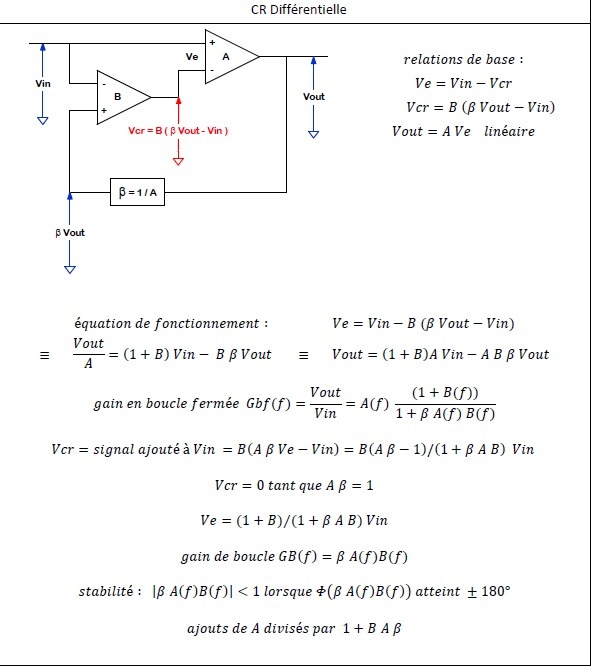

To keep my French and Spanish oiled I read/write on different forums, and this is something that has been developed and used on two french forums, then applied to commercial products as well. With this gnfb concept they get very low distortions and high DF (above 20, sometimes above 100) on SET and PP as well, keeping the 2 gain stage. I tried to propose it on this forum few times, but it has never breached other people's hearts.
This below is the block diagram, taken from here: http://www.forum-bleu.com/t1430-correction-differentielle-un-nouveau-ne-en-se#28502
