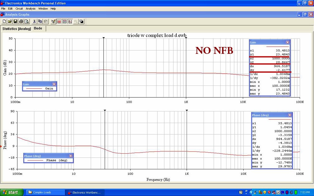

Here are the plots of response of a 6L6 driving that speaker simulator I use connected first as a triode with no NFB, Then FB applied.

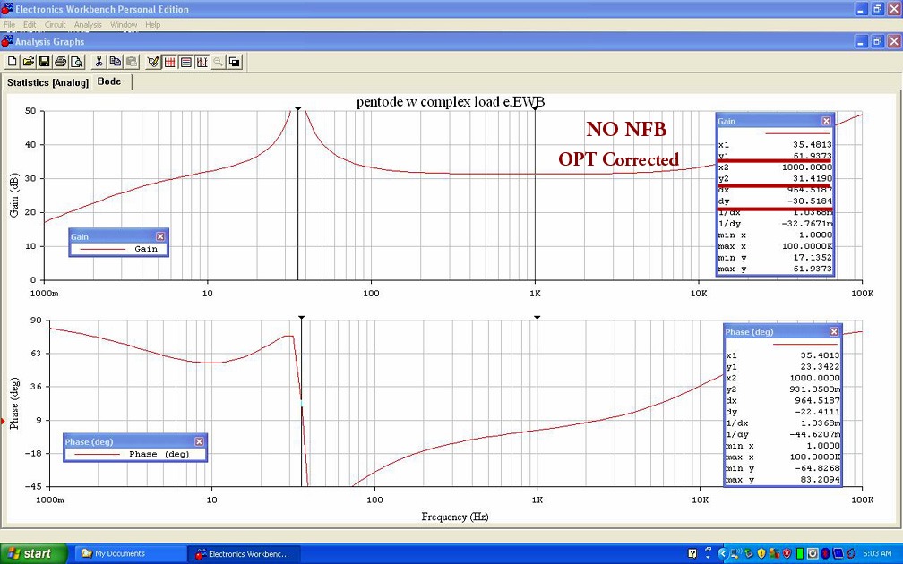

And the same for a pentode. As a pentode the tube is simply a current source of so many mA / Volt in parallel with its plate resistance rp.
So the response without NFB simply follows the impedance curve of the load. Just like PRR said.
This was put together on EWB for a presentation at the local Geezers Collectors Club in 2017. 🙂

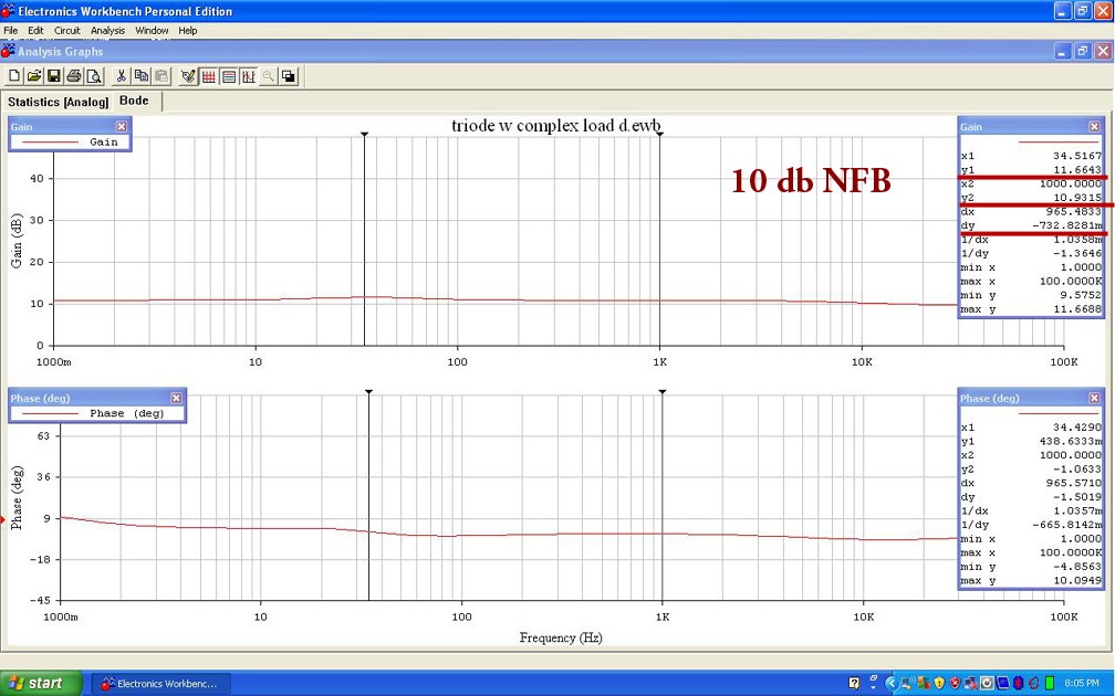

50 Pentode w Complex Load no NFB Corrected OPT & Captions.jpg140.3 KB · Views: 102

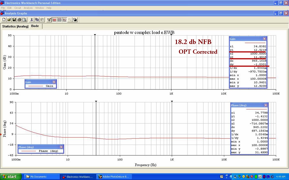

60 Pentode w Complex Load 18.2 db NFB Corrected OPT & Captions.jpg137.2 KB · Views: 106

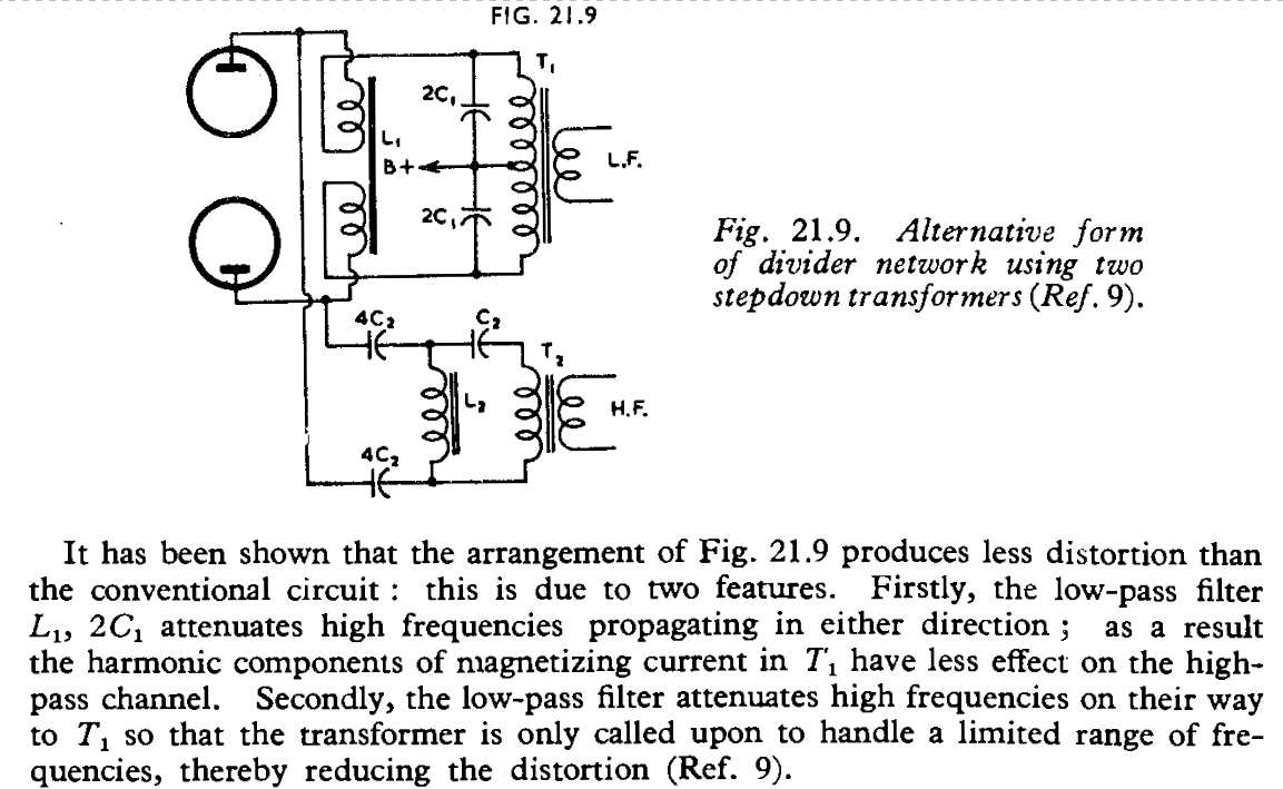

Bondini; Love that reference list. It turns out there are a lot of gems in RDH. For example this intriguing tidbit on pg. 888.
Very clever. Might be some advantages to such a network even for separate tubes for each range.
Indeed, wide - band output stage with a single transformer puts conflicting demands on transformer design that are virtually impossible to reconcile. By contrast, if the audio band is split into 2 or 3 sub-bands, transformers for each sub-band can be easily optimized. Importantly, such arrangement allows ditching speaker-level crossover.Bondini; Love that reference list. It turns out there are a lot of gems in RDH. For example this intriguing tidbit on pg. 888.
