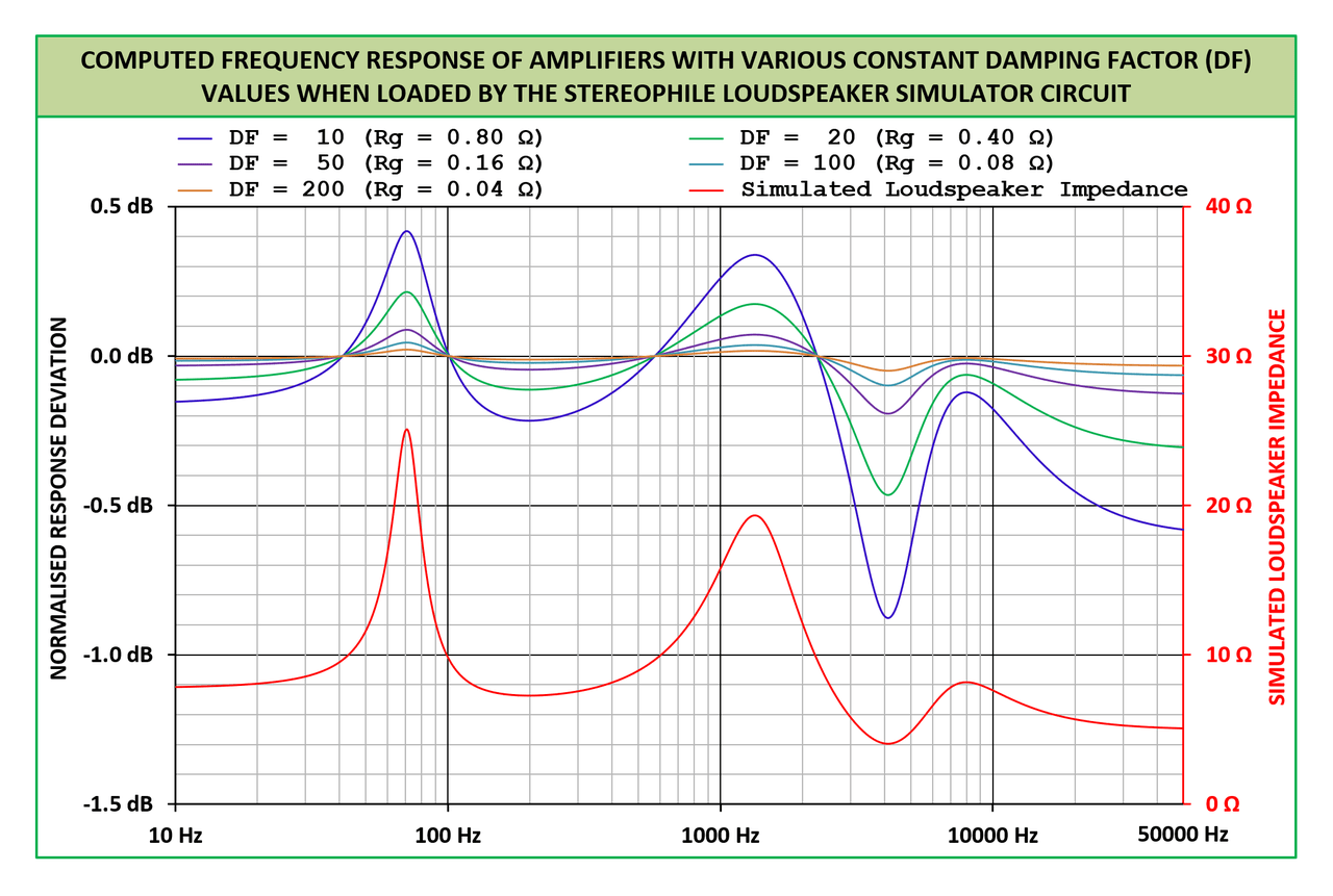

I'm looking at this chart taken from wikipedia. Is it then not relevant?As DF goes down, the amplifier output resistance contributes more to the loop resistance, with the inflection point at DF=1. With the example of 8 Ohm speaker, the loop resistance is 8R8 at DF=10 and 10R7 at DF=3, which is not really much of a difference.
It is relevant, but look at the y axis scale: 0.1 dB vs 1 dB. I don't think 1 dB difference is readily perceptable.
Yes, the meaning of my previous post is: with the impedance of the speaker that drops to 4 (not so uncommon, some speakers go even lower), and a DF of 10, we have 1 dB difference (the minimum difference that human ear can detect). With a DF of 2-3 that difference would become higher. Is it 2 or 3 really enough? I've always read that above 20 is not that relevant, that's why I was asking about the order of magnitude.

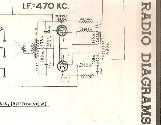

Anybody got a schematic of that or something similar?
There is an example of a PP 6L6 output section in Beitmans, a pre WW2 Philco receiver.
