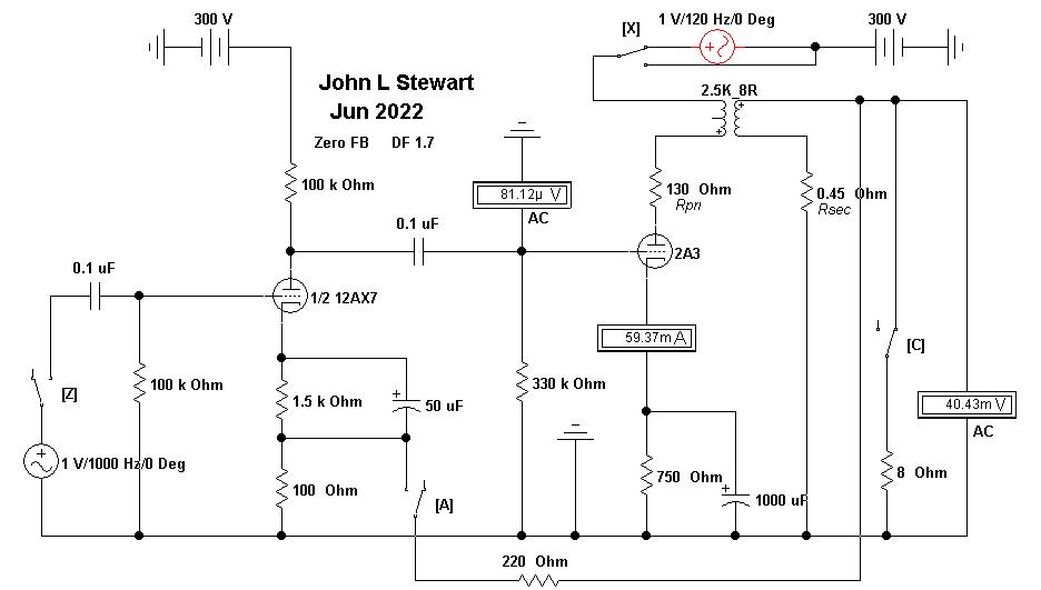

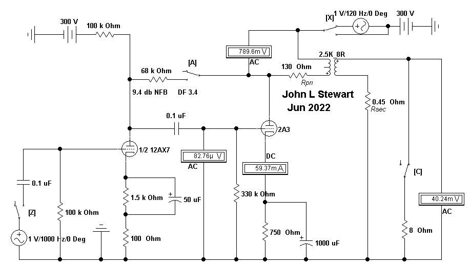

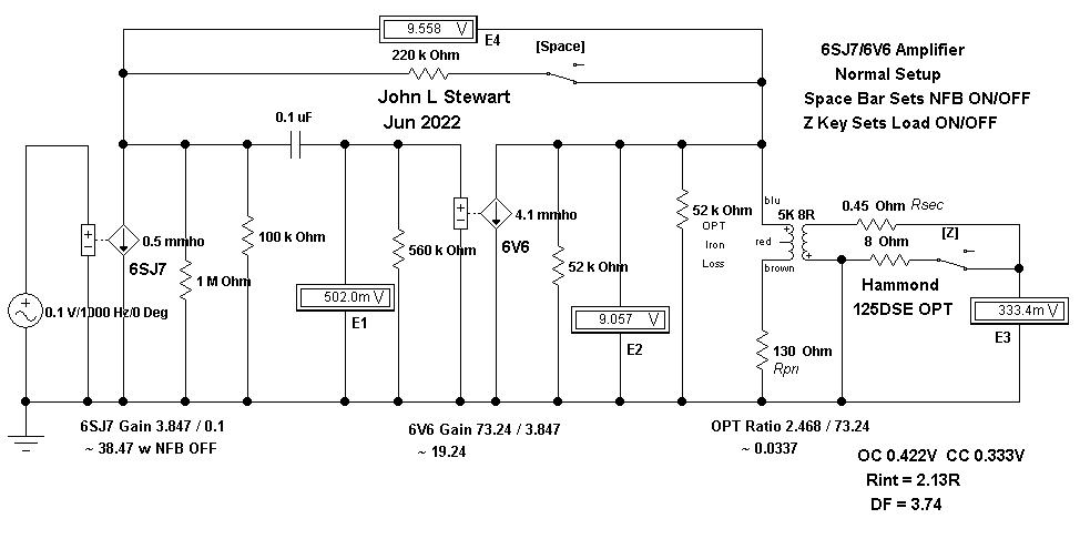

This simple amp, a 2A3 driven by half of a 12AX7 is connected with Schade FB & compared to if it were
connected with the same degree of NFB from OPT secondary to the AX7 cathode. And without FB at all.
With no FB the Damping Factor (DF) is 1,7. With 9.4 db Schade FB connected the DF improves to 3.4.
But with the full loop FB of 9.8 db the DF becomes 11.74.
Schade NFB does not correct for OPT winding resistance.
The winding resistances used here are similar to that of a Hammond 125DSE.

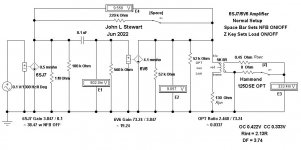

My dim understanding of the best way to implement plate-grid feedback around an output stage is that you need the very high plate resistance and gain of a pentode for the driver tube and you want the higher gain of a pentode for the output stage. My understanding is that the idea is to get the output power of a pentode but without the phase shifts of the OPT inside the feedback loop.
What happens if you conduct the same experiment using something like a 6AC7 driving a 6L6, comparing 'Schade' NFB to global NFB?

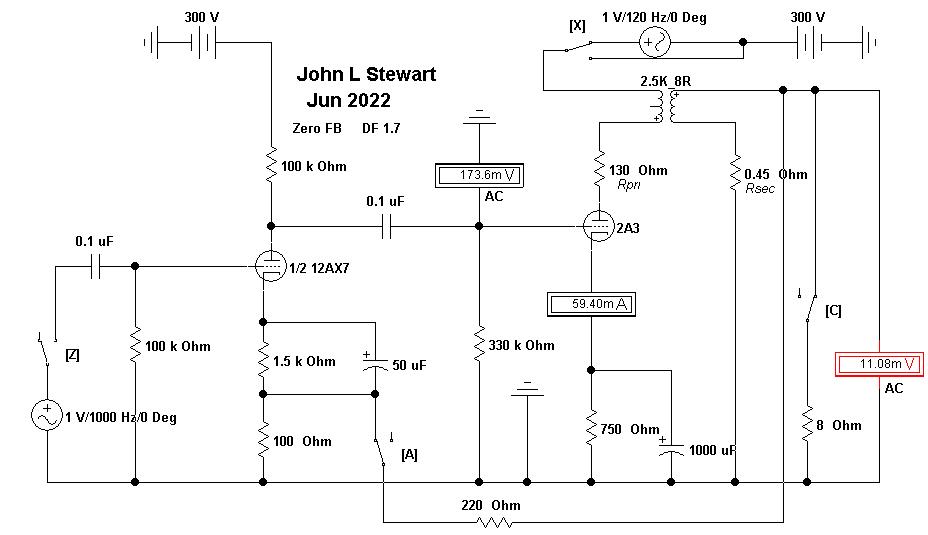

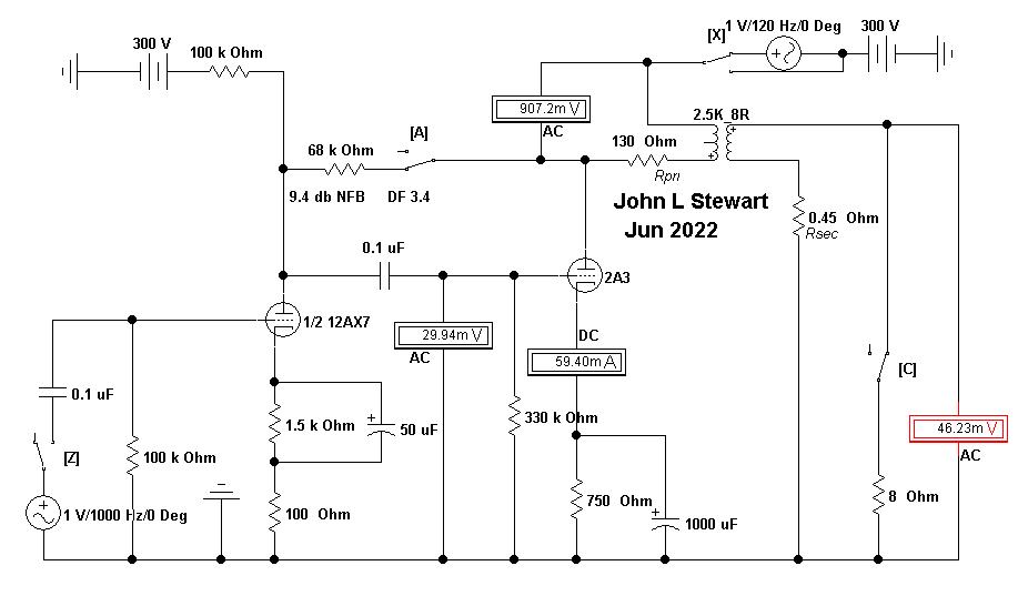

What Schade FB Leaves Behind....................................And Brings With It.
In these sims a One Volt 'Interfering' signal has bee inserted into the 300V PS lead, That would be PS Hum.
The driver has its own PS so that it is isolated from the hum. How much hum gets thru to the speaker terminals?
The switch 'X' allows the hum to be added into the output tube plate supply.
Without FB both Amps put ~40 mV at the speaker terminals.
But when Schade FB is applied the hum increases to ~46 mV.
In the FB Pair the hum at the speaker terminals is reduced to ~11 mV.

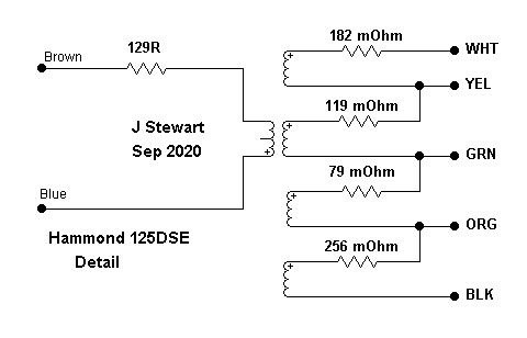

The DC resistances of a Hammond 125DSE are in the other
Measured using a constant current source applied to the ends of the windings.
Pentodes are a better way to go altho here on DIY many are allergic to them.
The bottom line for Schade is the same but in different ways.
Rain here tomorrow, I'll stick something together with the toobz you suggest.
All this really begs the question, 'Why would we use Schade' when the other way is so much better. 🙂
It allows a floating output winding without added cost or complication.'Why would we use Schade' when the other way is so much better.
It can avoid the need to figure OT polarity (which comes out wrong fully 50% of the time)
It allows us to self-delude "That's not overall NFB!"

Here is a pentode-pentode amp with the Schade NFB, something I did in 2020. The DF looks OK. Pentodes without negative voltage FB have very poor DFs,My dim understanding of the best way to implement plate-grid feedback around an output stage is that you need the very high plate resistance and gain of a pentode for the driver tube and you want the higher gain of a pentode for the output stage. My understanding is that the idea is to get the output power of a pentode but without the phase shifts of the OPT inside the feedback loop.
I've not included the result of that here. Just look at the data sheet for the 6V6 & others, DF without NFB is ~Rl / rp.

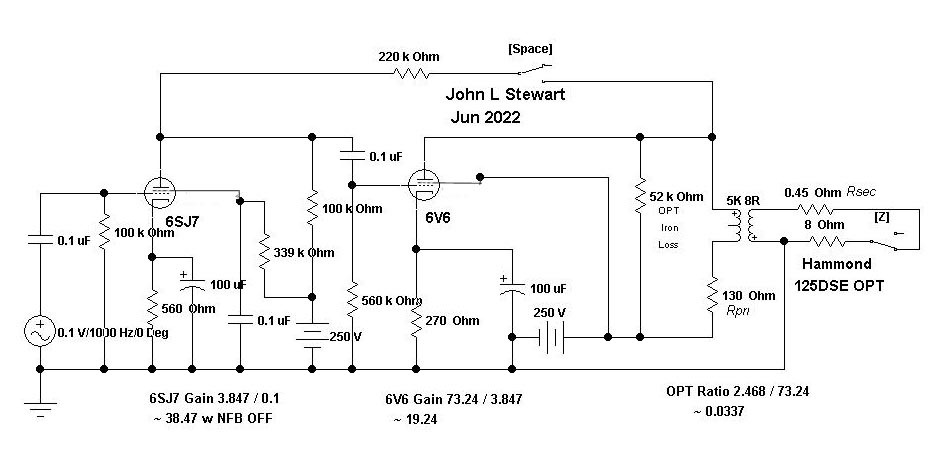

Here is the schematic simplified into plain English. The addition of these parts & a PS simply biases the tubes to their operating range.
The other method I used bypasses all that so that a designer can put together the bare bones to decide if the design should be pursued.
There are no pentode images in EWB, these are formed using MS Paint.

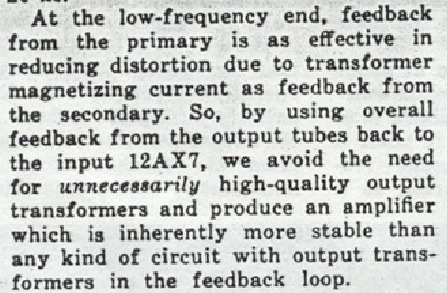

Here is Crowhurst's take on NFB from the OPT primary.Feedback from the OPT primary also reduces distortion in the OPT, and improves its bandwidth. That part is great; it's the bit about loading the driver valve that isn't so great. One option is to bring the feedback a little further back to the cathode of the driver valve. DC is involved, so that cathode resistor needs adjusting, so an iterative approach works. Or could be calculated, but bulky.

Copied from Radio Electronics, November 1957, p42.

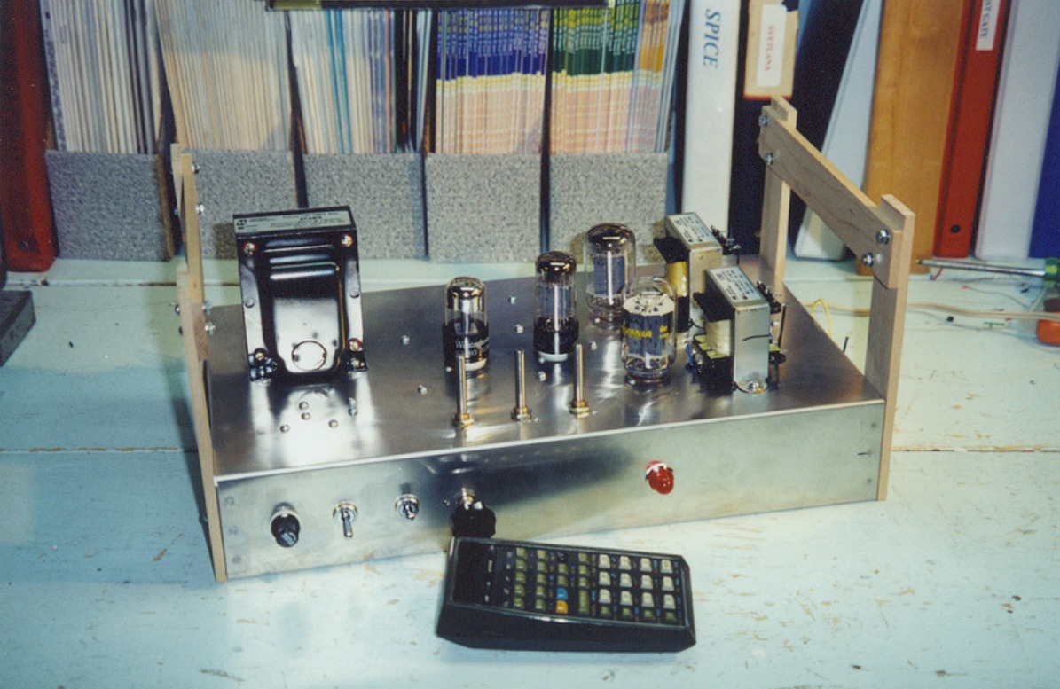

About 20 yrs ago I built two versions of Crowhurst's Twin-Cooupled Amplifier, the subject of that article.
In one a pair of 6LU8s in PP delivered 35 Watts at Clipping. On the plates +400V, the screens +300V.
D% & IMD results are very good. Like my other stuff it sits here on the shelf.
