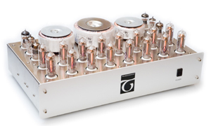

and in this climate I'm considering one of these... I must be insane.
Hi Mike,
That's the beast.... what do you feed it? Do you live close to the "Power Station? Your Air Conditioning bills will double!
What does weather like that do to your equipment?

Stuey said:Mike, stick a steel plate on top and use it for a barbie!
It isn't big enough. 😀
Keith,
The room is just over 100 cubic metres so heat isn't a problem.
It couldn't be more than a couple of hundred watts. You see all of those tubes and think it must be very hot, but a plasma TV dissipates about 300W and people don't even blink.
