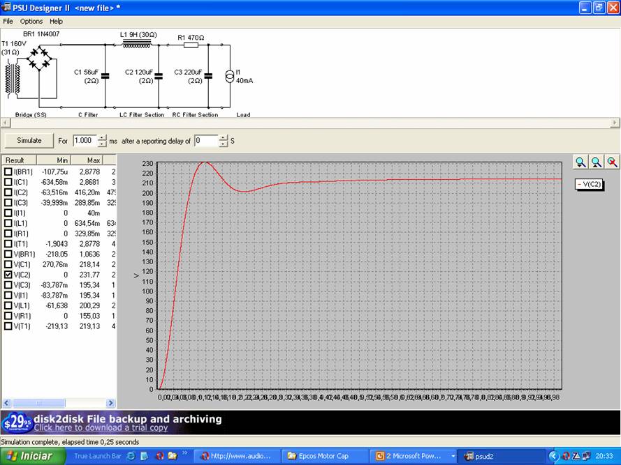

Sorry about that, Akira, it's been a little busy out. The reason I asked about your B+ voltage is because I'm now using the 6T4 tube, a device I find noticeably superior due to its lack of microphonicity and partition noise. The kicker is that the 6T4 has a very restrictive Vh-k rating, 50V below the cathode and 25V (!) above, so if your B+ is over 150Vdc, you have to have two heater supplies referenced to different voltages; you can't stay within both ratings with a single supply, no matter where you reference it.
There are a lot of places to go wrong in PSUD, mostly in the effective DCR specs of the power transformer and choke. In your case, both these values are set at about 30Ω, which looks pretty low to me. The resistance of my power trans secondary is more like 70Ω, and the choke is on the order of 300Ω. DCR measurements are easy to take, so get to work!

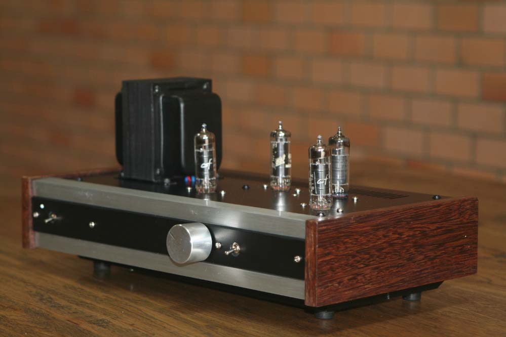

Hi guys, i am new to tubes and would like to build this linestage as it seems simple and its in my understanding to read the schematic.
But i have newbie questions, please bare with me.
1. referencing
http://tdsl.duncanamps.com/show.php?des=6T4
I use part of Poindexter's schematic posted in the beginning of the threat for smaller file, can someone help me confirming the pins are correctly identified?
as i try to match with akirasugai's post inside pic of the amp and it didnt match with the reference above. thx
2. i am wondering what the use of linking the heater tranformer ct to the B+?
quoting from Poindexter "Second, be sure that you reference the heater voltage to an elevation of 25v above ground, as I do, to observe the very restrictive heater-cathode voltage of the 6T4, which is 50v down or 25v up from the cathode (!)." is this the reason?
thanks in adv. happy listening

1. Yes, that's correct. Do use both plate and grid pins, as they are connected to different sides of the P / G. Here's a schem:
2. Yes, that is also correct. Failure to observe the Vh-k rating will cause the tubes to go hummy early.
Aloha,
Poinz

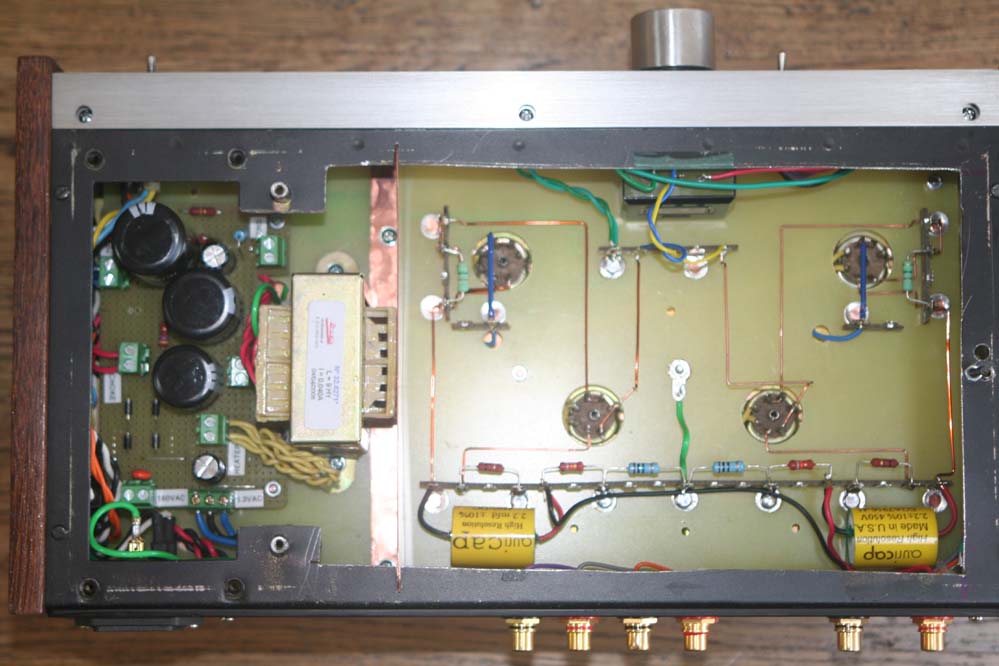

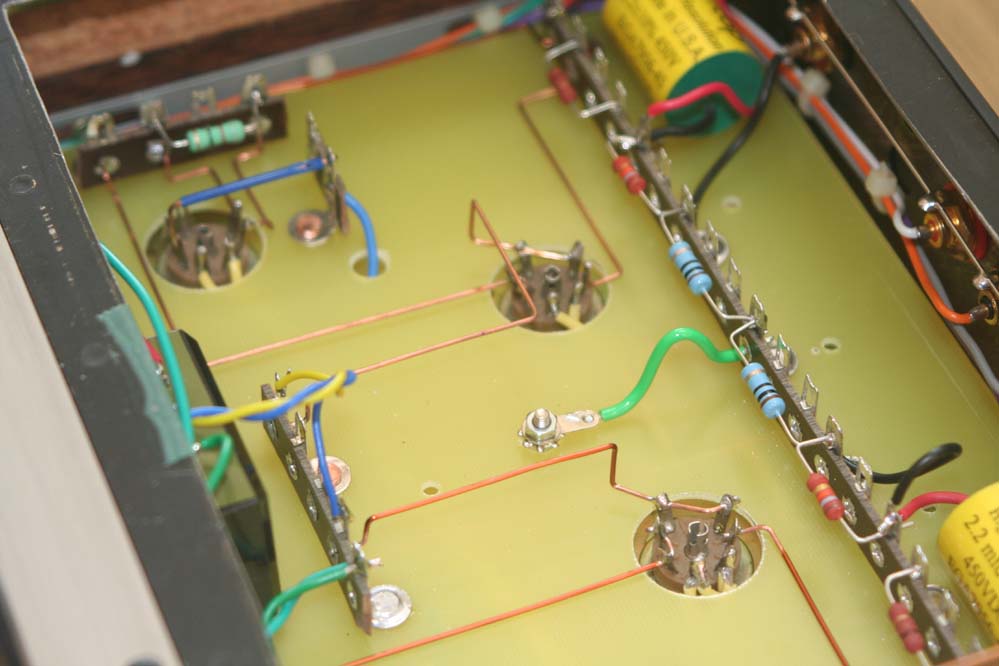

I'm pretty certain I only wired to one of the pins for the plate/grid - I must open her back up again and add a link across.
Does it make any difference sonically or electrically? I only ask because I have always measured the A to gnd and K to gnd as a couple of volts different on each channel (see link). I wonder if wiring to both pins would make that little bit of difference?

Well, it sure looks like it to me. The grid (on my RCAs, anyway) is wound on two posts, and one pin goes to each post. Maybe, maybe not. The plate, however, is in two pieces that are sort of 'U' shaped (with heat wings going off), and one pin goes to each side. If the two halves are connected in another place, I dunno.
Some tubes with doubled up pins I've looked at and the two pins are wired to the same place anyway, so who cares, but in this case it looked to me like a good idea to wire up both pins.
If you fix it, have a good listen first, and then see if you can hear any difference.
