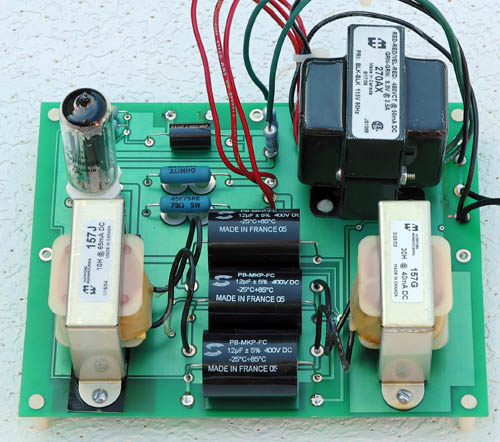

The reason the Aikido is "dead quiet" is a self noise cancellation feature. You can get away with garbage power supplies, and the Aikido takes care of itself. It injects the PSU noise 180 out of phase, which cancels the PSU noise coming in. I use a PSU with capacitor-choke-capacitor configuration (photo attached), just because I hate noise that much.
I think the Aikido sounds great because it is a high input impedance, single-ended, low output impedance amplifier with no feedback. With the 6SN7 operating at 300VDC, it is operating on the flat spot of the triode's curve, giving very low distortion.
