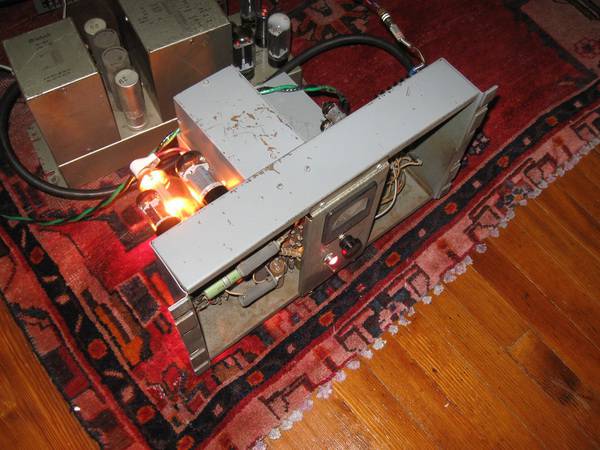

what is a McIntosh K 104?

It is the K-107

It was probably an 8005 tube, not an 810, but my brain is useless for remembering tube types that I have not seen or worked with in 30 years... 🙁
Pix: http://www.audiogon.com/cgi-bin/cls.pl?ampstube&1303454076

Nickel plate... glows red in normal operation... fwiw.
What is the tube number / type?
