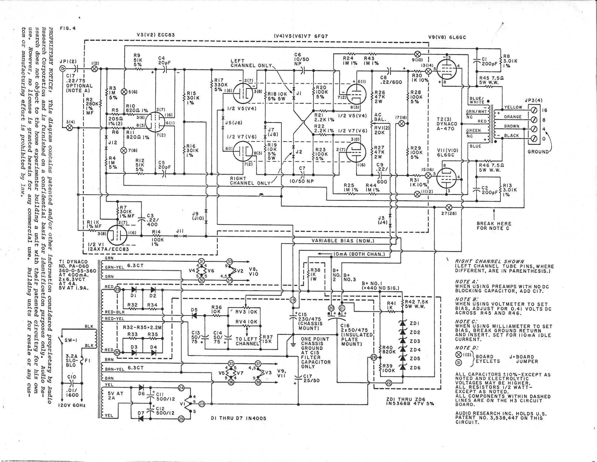

The McIntosh is really not terribly complex if you go to the basic circuit as used in the 50W-2 or the MC-30, interstage transformer coupled and capacitively coupled respectively.
Compare to the Audio Research shown below! 😀

ARC_ST70C3
That's another way to do CFB easily and on the cheap, just use the secondary as the CFB winding.
Could just use an Edcor OT. Maybe not with the extra gain stage that ARC used, if you use some high gm frame grid drivers.
