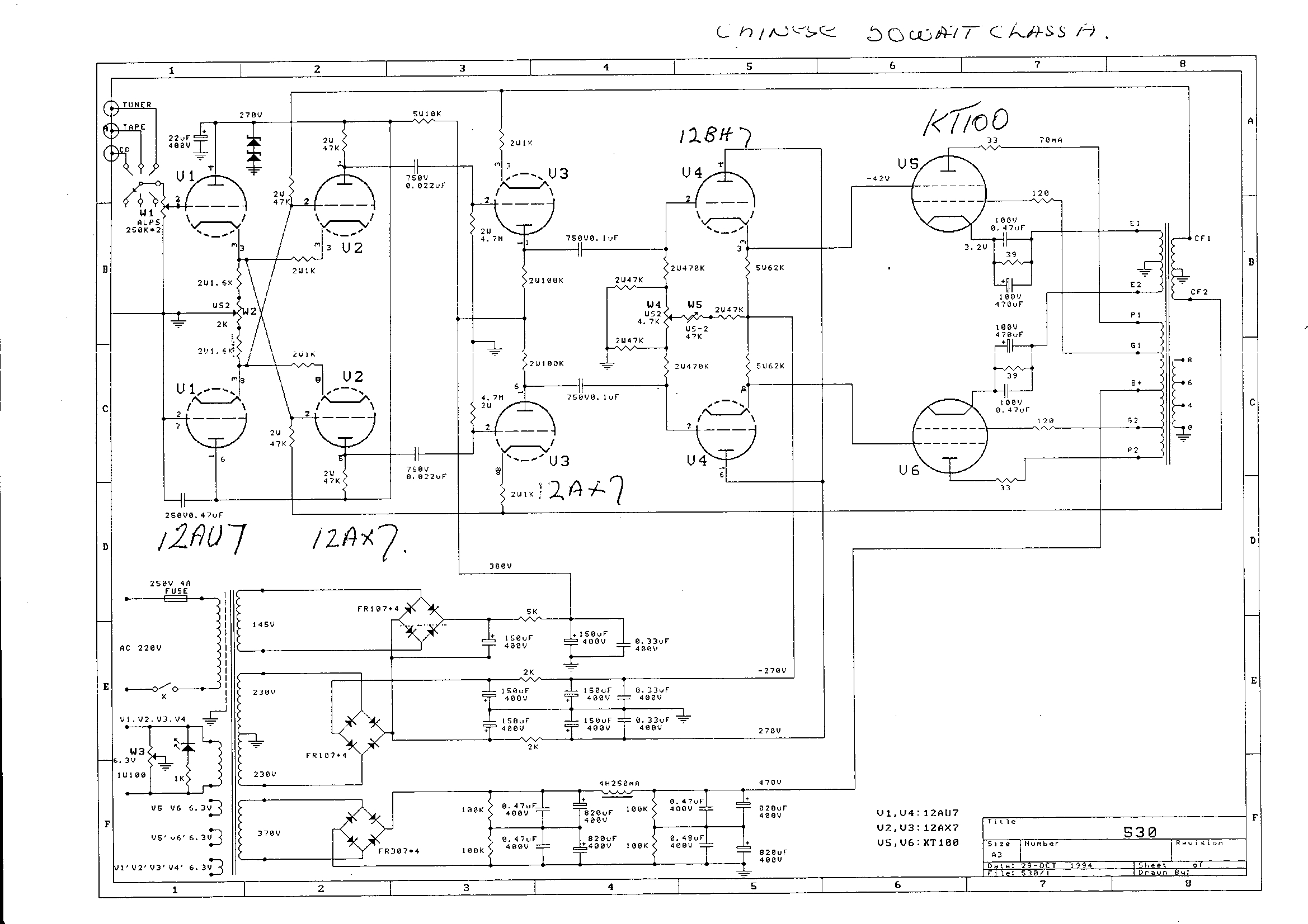

A Chinese amp some what like a Mac?
Phil
The schematic has swapped screen and control grids in the output. Wonder what other (deliberate?) gaffes exist in this schematic. I've seen essentially this topology before in an ancient copy of the audio anthologies without the cathode follower driver stage. (Not sure about the cathode feedback, whether it was present in the design I am thinking of) I can't see the values on the schematic clearly, but the basic topology looks OK.
Do they even sell OPT that has cathode feedback tabs? If not, then it's quite useless to get into this kind of design as you can't buy the transformer.
I've not listened to any, but I did repair an amp based on this design several decades ago, and it seemed to work quite well - whether it has any advantages over the McIntosh is debatable.. (It is less complex except for the transformer)
People do wind transformers to order, none of the ones I use in my designs are off the shelf. This might be a bit trickier, but I imagine AJT could make some, and several European makers certainly can. PP transformers with cathode feedback windings are commercially available if somewhat unusual.

btw, if your OPT has 0, 4, 8 and 16 ohm secondaries, then using to 4 ohm tap as center tap, then the 0 ohms and 16 ohm taps are available for cathode feedback...
Lundahl makes a 25% CFB OT:
LL1620CFB

Does it really improve sound? I am a little skeptical of McIntosh. They seems to be overly complicated. According to the paper of Vacuum State, they do it with simple CCS differential power tubes driving straight into OPT the conventional way.
I was looking at Plitron. How's the sound/quality compare to Lundaghl? So far I saw some high end amps use Lundaghl like Vacuum State. The Lundaghl LL1679 4.4K:4ohm seems to fit my needs for EL34 or KT88 with UL. It is $260 each. It's a C-core, so it's going to be a little losy than toroid. but It's going to take DC current more gracefully just in case any imbalance.
I think Plitron OTs are used in a number of high end amps. I haven't heard one. I did hear someone comment that they were so transparent, that one could not hear any OT effects, and the amplifier no longer sounded like a tube amp. I guess if you make it perfect, it sounds like SS like they say. They do have phenomenal bandwidth. And of course they will require a DC servo in most cases.
If I were going to make something like the Mac, I sure wouldn't use class B anyway. Getting the crossover distortion out is the 1st priority, so either some clever gm smoothing technique, massive NFdbk like they used, or class A.
