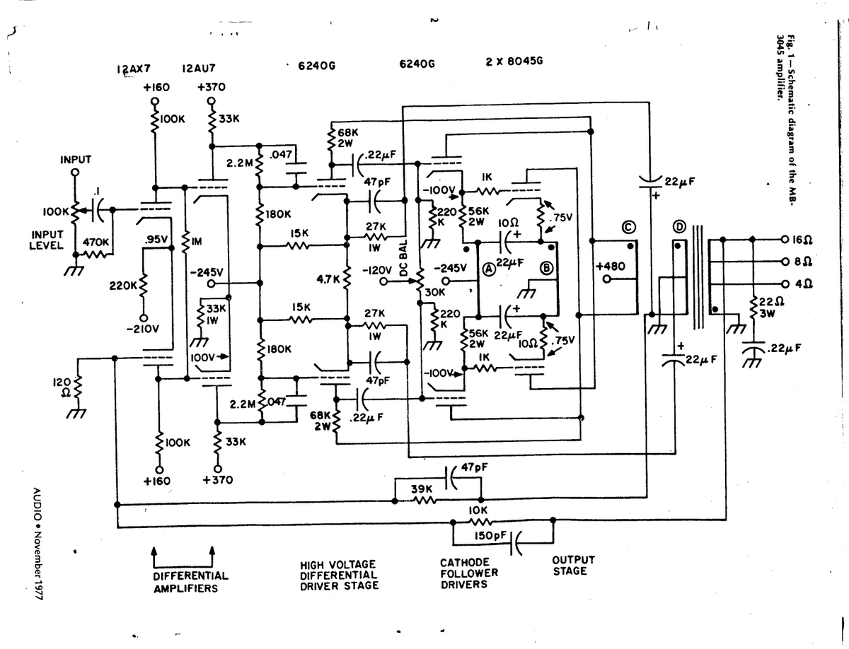

That Lux 3045 circuit looks overly busy with extra primary windings. The use of a separate primary, D, for the differential driver stage feedback means it misses the differential current sensing signal in the CFB winding (winding resistance derived). And why they would want two windings, A & B, that are cap coupled with just a DC voltage difference between them, when some resistors would do instead. Taking "global" feedbacks from both sides of the OT seems like it would be corrupting the final output. I could see if the feedback networks did a transition at HF to local Fdbk, but they don't. SY, are you sure about this amp as an example?
On the Mac Unity Coupled style amplifier absorbing leakage inductance spikes in class B cutoff, this is only really necessary in class B. Class AB should ameliorate this problem with both sides conducting during transition, insuring a low Rp absorber. Another approach would be to just put some HV Zeners or shunt regulators on the primary winding ends, set just above the normal max voltage excursion, so as to absorb the inductance cutoff spikes. Same problem occurs in switching supplies.

smoking-amp said:That Lux 3045 circuit looks overly busy with extra primary windings.
Not overly busy at all. The use of multiply nested feedback resulted in a tube amp that had remarkably low distortion that was flat across the frequency range and a similarly low source impedance that was likewise flat across the frequency range. Overload recovery was excellent. The amp was let down a bit in thermal management (board failures also mentioned above), but one cannot criticize the performance. Like the Macs, this is a design lesson for anyone interested in tube amps that are neutral and not effects boxes, but perhaps even more so.

Everyone talks about massive feedback employed in the McIntosh amps while possibly not recognizing that the unity coupled output stage had massive voltage driving requirements. I no longer remember the feedback margins, but suspect it was under 30dB if I recall correctly.. Hopefully someone can provide some illumination on this subject.
I can't speak to all McIntosh amps and am not very impressed with the current lot, however I did own a very nice pair of MC-30s for a long time in the 1980s and they are what made me finally and irrevocably jump to tube audio from solid state. I've had a lot of ST-70s as well, and with modern speakers at least (difficult loads) the MC-30 easily outclassed both stock and heavily modified ST-70.
One of the interesting features of the Mac and Lux amps was the use of positive feedback (bootstrapping) in the drivers. Crowhurst's paper discusses this in detail (as well as feedback margins and how the nested loops really worked).
High negative feedback (with good stability- these were smart engineers) is responsible for the low distortion and source impedance, which can be offputting if you want the amp to have a "sound" rather than simply make the input signal bigger.
The CFB feedback to the driver stage in the LUX and in some MACS, I would definitely agree with. No need for the highish 50% CFB level then with the extra loop gain (and leakage L spikes can be fixed in other ways). But the Lux seems to have gotten carried away with extra windings that have the same signal on them. You don't want to put extra stuff in the OT that just makes leakage L bigger. But keeping the %CFB down to where it can be bifilar with the output secondary is a smart move.
