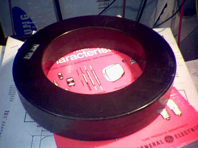

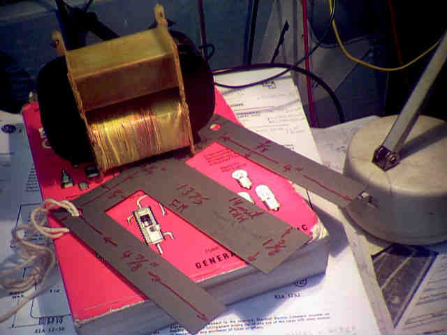

Well, I don't know a lot about transformers but I do know that magnetic fields don't like corners.
Core loss and field leakage arising from coarser and ill-fitting laminations - oh, and the effective increase in magnetic path length due to those damn corners!
The C core and toroid have the preferred grain orientation in the right direction with the field thru them, so they maintain high permeability up thru high flux levels. The E-I core has the wrong grain orientation at the back of the E. The long E does somewhat better by having more % of the path in the right direction. Then there is the joint between the E and I lams. This performs OK up till about 50% of the max flux, then the remaining flux has to jump the butt gaps. So the permeability curve peaks earlier (and with a lower peak) than the C core or toroid which have broad flatter Mu curves with higher effective Mu.
Result is that less core is needed for the C or toroid for the same power (since the Mu is still useable up to a higher flux level), the inductance will be higher for the low freq. perf. and the shorter wire length resulting (from the now reduced core cross section) will improve the high freq. end some too, due to less dist. capacitance.
Although the C core does have all butt gaps to cross at two points, it is precision ground and strapped under tension, so it comes closer to continuity for the field. One could precision grind an E-I too, but I've never seen it done. Some mass produced E-I xfmrs have the I's all on one side and are hydraulically pressed and welded together, but I suspect that just gets the performance back on par with interleved lams.
There also were some special modified E lams made by an outfit in NJ I think at one time at least. These had twice the usual width to the back of the E lam, and could be used in an I-less mode, where the E's were pushed fully together. This eliminated the butt joints and still provided the same amount of cross material at the back, but still incorrectly oriented.
For the DIYer, there is the option of using all I construction (four sided box with two bobbins, each interleaved and cross wound, ie split bobbin design). This gets the grain orientation all in the correct direction. Just not economical for production xfmrs.
More work to stack the lams too.
