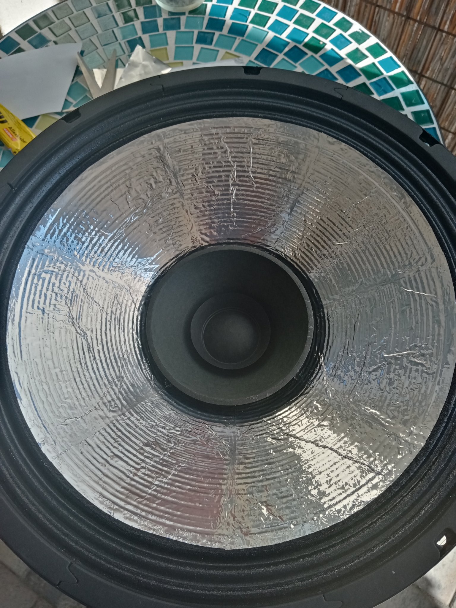

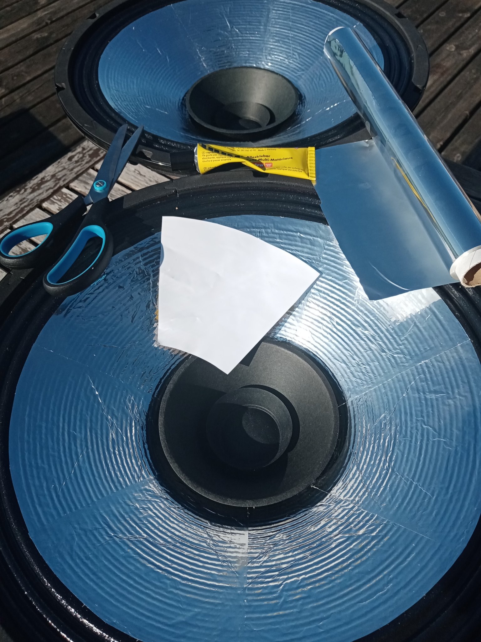

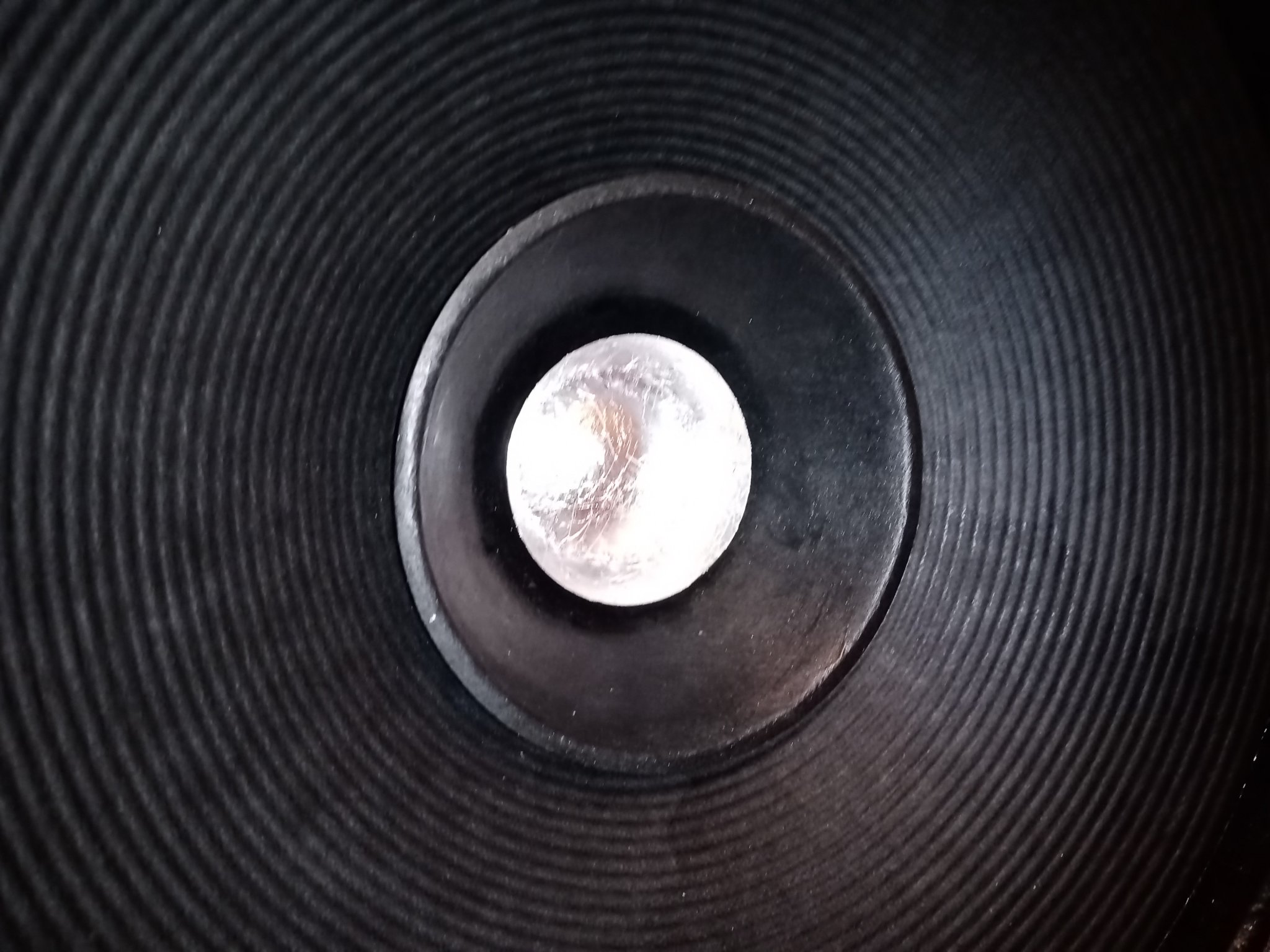

How does this change the radiating area? Have you measured the difference?I frequently use fullrange loudspeakers covered diy with aluminium foil of various thickness.
This gives a large radiating area, point source, no crossover.
Adding indirect radiating tweeter(s) gives more dispersion in the highs if not done otherwise.
Such speakers can easily reproduce even the loudest cymbals.
The Fane Sovereign 15-300tc has up to 110db efficiency in the higher frequencies.
linearized with dsp and a powerful amp be prepared for good dynamic reproduction.
