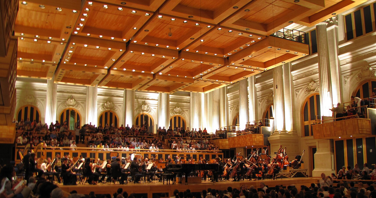

This is the place I used to go when I lived in Sao Paulo. The entire roof of the theater is made of moving parts to adjust the acoustic for each event (big orchestra, small etc). There are no loudspeakers when classical events are made.
https://pt.wikipedia.org/wiki/Sala_São_Paulo
This is what I meant - your city hall having an orchestra without any mics should sound awsome!

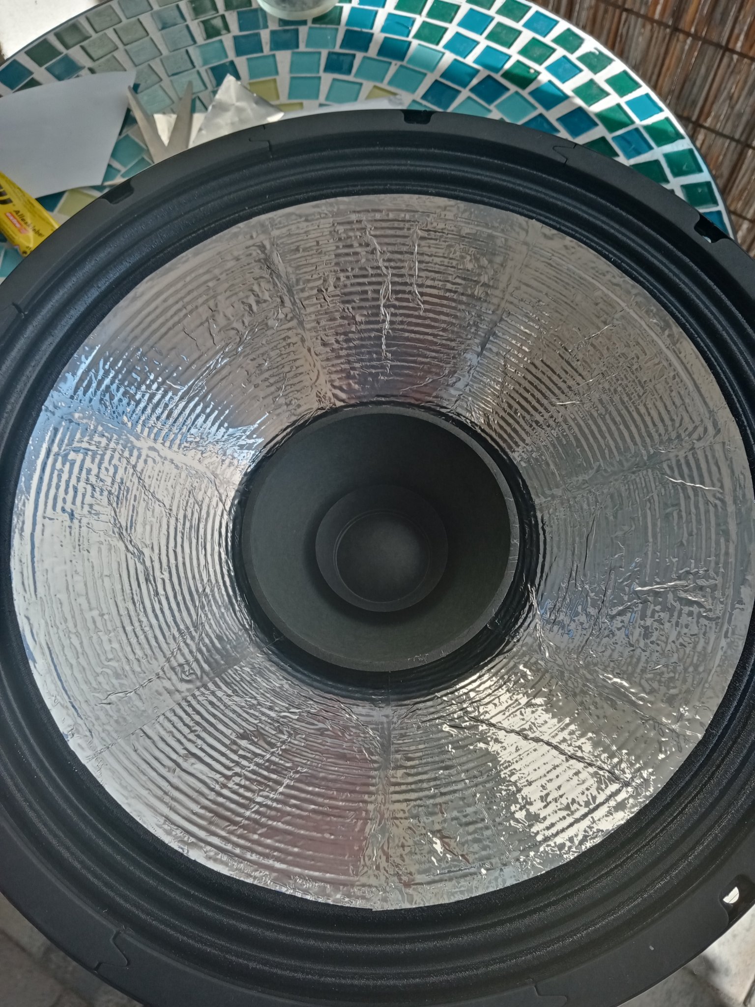

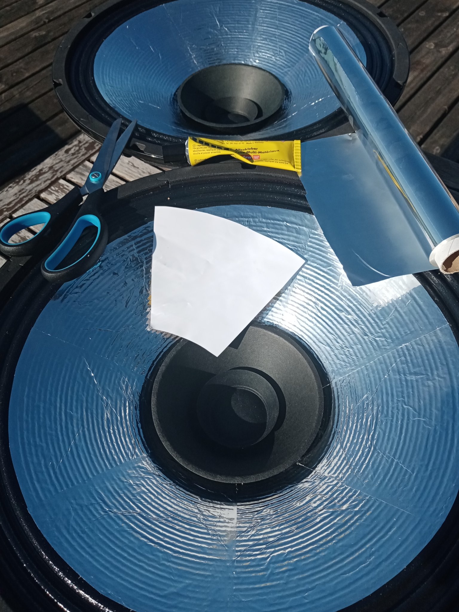

I frequently use fullrange loudspeakers covered diy with aluminium foil of various thickness.
This gives a large radiating area, point source, no crossover.
Adding indirect radiating tweeter(s) gives more dispersion in the highs if not done otherwise.
Such speakers can easily reproduce even the loudest cymbals.
The Fane Sovereign 15-300tc has up to 110db efficiency in the higher frequencies.
linearized with dsp and a powerful amp be prepared for good dynamic reproduction.
