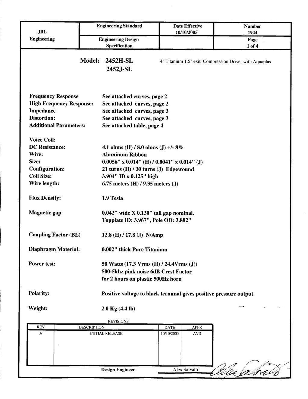

Just for fun some dimensions and tolerances used in a compression driver. Check out the edge would wire.
Rob 🙂
