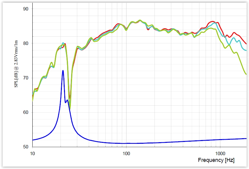

I'm more than open to discuss the LT some more. As I understand it, and much of it resonates with what you've been describing it as, it is an equalizer that corrects frequency response with a functional form set by a couple of parameters. I just don't see where it fits in. You would do the same.

At low SPL and low frequency playback it sound decent. If either the SPL is increased or the frequency being reproduced the quality drops quickly. At high SPL it sounds like a lack of control, as if the frequencies blend in together. It gets muddy as if several other tones are fed through the system, other than the original playback, all a bit higher in frequency. The higher frequencies almost sound like buzzing.
If I had to describe it through technical terms I'd say I'm hearing a lot of intermod destortion and suspension resonance. Intermodular distotion anywhere at high SPL and suspension resonance especially at the higher frequencies.
I've used Vifa NE subwoofers in infinite baffle before. They were there with the best. I had no complaints. They also play excellent free air.
I've heard lots of sealed boxes sound like this before. But every infinite baffle design, dipole, or servo sealed system sounded much better.
Cool build...
This is probably the most informative post other than the frequency response that you posted.
I would like to examine your descriptions of what is wrong with the sound a bit more. Please elaborate.
Does the system get loud? In a car as small as a vette this should be able to produce quite a bit of volume. I don't mean knocking the mirrors off axis loud but is it in line with what you would expect? If it does I suspect this problem has very little to do with the amplifier or power supply. Seems like an issue with the sound signature not the loudness.
You mention that the sound is "boxey". Have you confirmed that the box is not having an issue with the length resonance? Can you run it outside of the car with the same tracks that sound boxey and determine whether you perhaps have a nasty panel resonance that shows up at higher volume? Are you sure there aren't body panel resonances or internal trim or the hatch that are resonating and smearing the sound? I have run some very small box / high F3 designs such as this in vehicles and the sound signature can be quite different. The upper bass range is very efficient and loud and it can start to modulate the sound at your ears and sound sort of like a buzzing.
When the sound changes at high volume have you confirmed that the drivers are not being overdriven mechanically? It's hard to know what type of output levels you are talking about. Generally with car audio I default to assuming it's loud as hell. Have you properly setup the gains so that you are not clipping either the line out from the HU or the amplifier itself? You mention 31 band EQ and this makes me wonder whether there are some gain structure issues and/or clipping problems. Is there any EQ being used in that response graph you posted? I am doubtful the issue has anything to do with harmonic distortion from the drivers at all unless they are being beat on very hard. If the drivers do not seem to be being asked for that much then there may be a wiring issue. Anytime you have 8 or more voice coils it is easy to make a mistake on the wiring and just one can muck up the whole system. Have you went back through and absolutely checked your wiring to ensure that it is correct? 9v battery test on all the drivers to ensure polarity? Your comments about the high frequency sounding blurred and muddy almost sounds like a blown driver or a severely clipped signal somewhere.
Your response plot shows relatively clean and flat response from 20-100Hz. It may be that this simply sounds more top end heavy and less bassy than you expect. Have you ever had a flat bass system in a vehicle? A typical bass response in a vehicle is really bass heavy and a massive hump between 30-70Hz. My experience with small sealed systems with rising natural response in vehicle is that they sound lean on the low end even when a microphone says they are flat to very low frequencies.
Yes, the system does get loud. What I'm missing is the "airy" bass, as Linkwitz describes it, from my previous infinite baffle systems. At low output the subwoofer box sounds generic, and it only gets worse with higher amplitude. I have a set of Scan Speak Classic 25W/8567-SE in my doors. If I use them to cover down to 20hz and shut off the sub I like their sound a lot better. But my doors are massive, at ~ 1.5 cubic feet per speaker, and the resulting Q is .701. I do agree that this is more about signature and not loudness. There is no problem with the SPL produced at any frequency.
No doubt the car has some panel resonance and rattles, but there are three reasons why I think this is a separate issue. First, the doors are more rattle prone yet I enjoy them more covering the same range. Second, my initial impression of the box was pretty bad playing music on it without filters outside the car. Third, even at low output before buzzing it just fills in the low end but does not have the clarity I've come to expect from IB setups. You are correct however, that car panel resonance is always going to be a problem. My next goal for the car is to apply lots and lots of closed cell foam and hydrophobic melamine to reduce rattles with little weight penalty.
I am relying on WinIsd to determine that the drivers are not overdriven mechanically. In WinISD the woofers cannot exceed 7mm one way excursion (16.9 mm is max one way) at 2,500 w in this size box. That is before applying subsonic filters which I cannot defeat. From the testing with the Omnimic and other SPL meters I haven't seen output go over 110db yet. With cabin gain that should be well under 1,000 w input, so clipping is not likely to occur. Look at the FR below, this is what I typically listen at. 3db higher for what I consider moderately high. At most 10db over for really cranking it (but not more than one song). The most EQ I've applied is +3db for the sub box. The processor controller displays volume in DB steps. I'm never lower than -15db. Lots of headroom left. I also keep my source player at under 90% volume. I have not done the 9 V test yet but have generated very low HZ test tones and eyeballed the drivers to make sure they are in sync. I totally forgot about the 9v test! Good point. I did double check the wiring.
I tried a reference flat FR in the car. It sounds great with the engine off. But on the go, there is far too much road noise to enjoy a reference FR. You can see the kind of FR I go for bellow. I do back off about 5db 20hz-63hz from what you see if the original recording has good bottom octave material.
Hi Y'all,
Just a quick question, does anyone know what that response irregularity between 20 and 30Hz in the manufacturer's SPL curve comes from?
Testing each driver separately in WT2 doesn't show it. But I believe it may have to do something with the WT2 algorithm and therefore it is not precise enough to show the wiggle.

I did a faceoff between the B&C 10NDL64 and the Scan Speak 25W/8567-SE in the doors. As you can see the Hi Fi driver is far more sensitive in the bottom octaves than the pro-audio driver. I can only fit 10" woofers, and this to me looks like a total victory for the Hi Fi driver:
In-door tests
I had a few questions I wanted to answer:
1. At what frequency does the B&C surpass the Scan in sensitivity?
2. Is it true that the B&C is 8.5db more sensitive at 1 watt?
3. Can the Scan go flat to 20hz in-door?
Here are both the Scan and B&C tested on the same volume level on the Alpine H800 with all filters defeated, basically full range.
Driver side, B&C in red, Scan Speak in black
Passenger side, B&C in red, Scan Speak in black
Question 1
First we have to account for the fact that the B&C is 4 ohm whereas the Scan is 8 ohm. Therefore, add 3db to the Scan Speak scale. The B&C has more output above 200hz. The Scan has more output below 200hz. That means the Scan has a considerable output advantage in the midbass. Even if I wanted more output and chose the B&C I'd have to live with less midbass output, aka a funky FR with midbass downplayed by many DB just to not bottom out the driver. So in effect, while the B&C is a higher output design in reality you can't make use of it vs. a hi fi driver because midbass output is the limiting factor for both. You have to choose a higher than 63hz crossover or choose an FR that has low midbass output to make use of the B&C's higher output. In fact, below 80hz the output is lower with the B&C even if you use EQ because you run out of Power or the coil melts down before beating out the Scan Speak. This is important because it shows you can't make use of the B&Cs higher output in the top octaves without sacrificing the low crossover or a nice frequency response!
Question 2
Based on these plots I can see that at 1 watt, the B&C is about 8db more sensitive above 300hz. So you can see here that if you plan to use the 10" in door from 300hz to 1000hz that the sensitivity advantage is real. However, I don't plan on using the 10" as midrange! So this is sensitivity advantage is not really an advantage since as I shown earlier the output is limited by the distortion in the region 63hz-125hz. Basically, the B&C will bottom out first when tuned to have decent output down to 63hz before it gets to use it's sensitivity advantage. Your results may be different if your Car does not have a huge drop in SPL in the midbass on the driver's side, or if your Car does not have a null at 120hz, or if you desire an FR that is cut heavily in the midbass area.
Question 3
Yes, the Scan Speak has the same output at 20hz as it does at 1,000hz. Scan Speak recommends to use this driver 20hz to 1,000hz. So yes, I could run subless and still have extension down to 20hz. However... the Scans only have 12mm of throw one way. That is hardly enough to get serious SPL at 20hz!
Note also that Scan Speaks break up is very mild starting at 2,5khz or so. A 1,000hz LPF works great with this woofer. No hint of breakup. It also blends very very well with the AMT tweeters.
