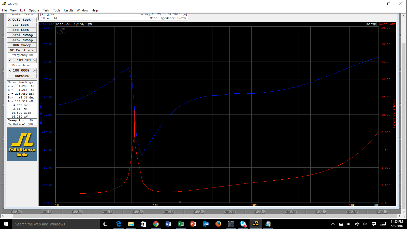

Here is the woofer tester 2 result:
Looking at the measurement it seems there is a (random?) spike sitting on top of the impedance peak, and this might affect the derived values for the Q and f0 values. Do you know the source of this spike? Can you repeat the measurement?

I thought you might say that! I believe I saved another run or two. I'll post it later tonight. I believe I might have an explanation, or maybe two. One is that the non-heatsinked Vifas seems to have a higher FS than the heatsinked models. When I ordered 8 they could only deliver 6 because they said the larger heatsink model voice coil is not available to be built at this time. More coil equals more mass equals lower FS. 3hz difference in FS is not huge of course, but could be the reason for the dual peak. Second, Vifa NEs have slight wiggles near FS. If you look at the PDF posted here you'll see what I mean:

At low SPL and low frequency playback it sound decent. If either the SPL is increased or the frequency being reproduced the quality drops quickly. At high SPL it sounds like a lack of control, as if the frequencies blend in together. It gets muddy as if several other tones are fed through the system, other than the original playback, all a bit higher in frequency. The higher frequencies almost sound like buzzing.
If I had to describe it through technical terms I'd say I'm hearing a lot of intermod destortion and suspension resonance. Intermodular distotion anywhere at high SPL and suspension resonance especially at the higher frequencies.
I've used Vifa NE subwoofers in infinite baffle before. They were there with the best. I had no complaints. They also play excellent free air.
I've heard lots of sealed boxes sound like this before. But every infinite baffle design, dipole, or servo sealed system sounded much better.
It is very hard to make most drvers sound good in small closed cabinet. It is straining the suspensions and motors with high excursions which result in high distortions and noise. Most of them are designed to work in big BR or PR Just sell Vifa's and seek for drivers with low Qts and low Vas, you won't be dissappointed. Using 1 ohm load is also big strain for amplifier which loose control of the drivers at higher electric power delivered to them.
